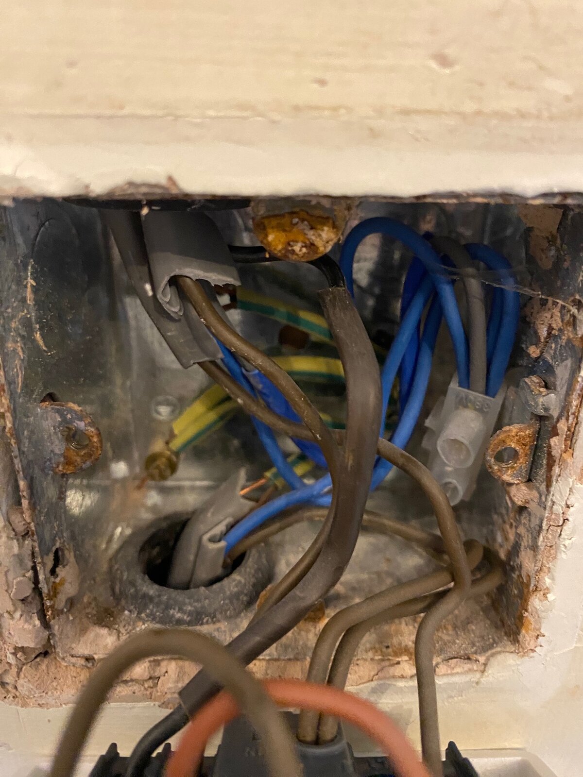

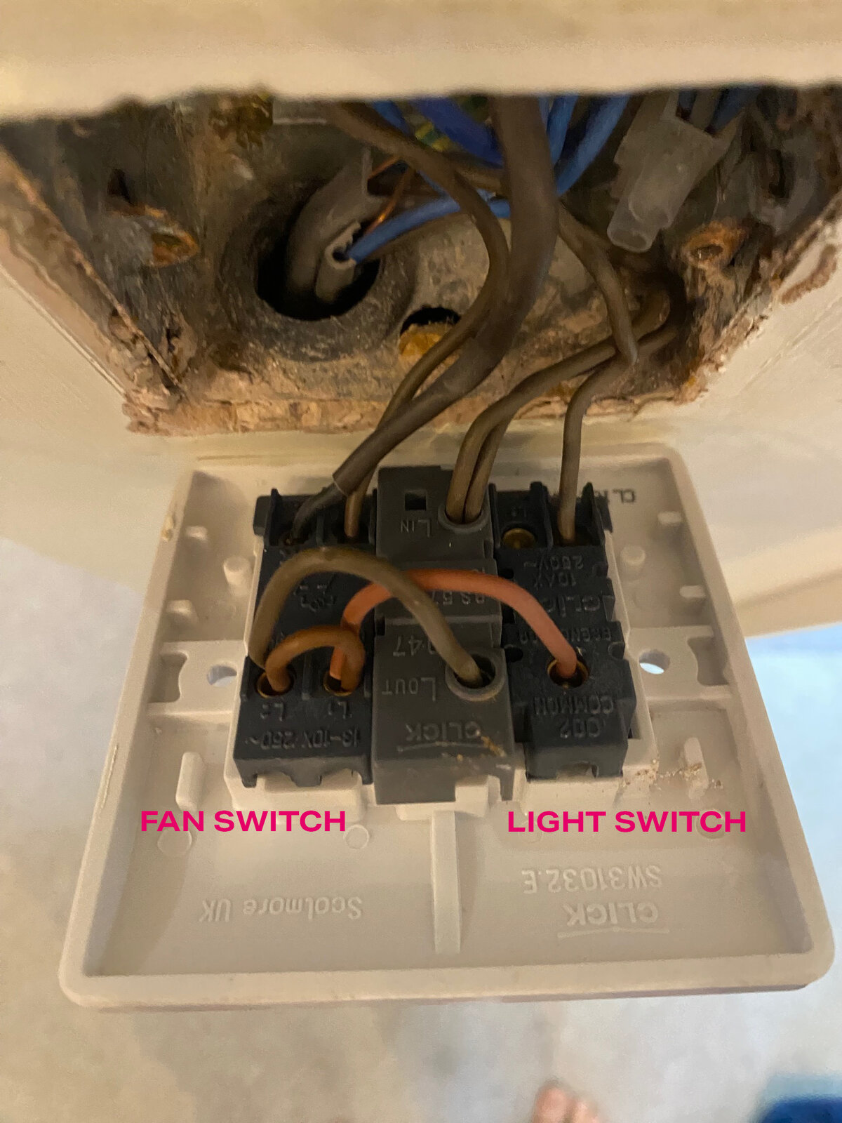

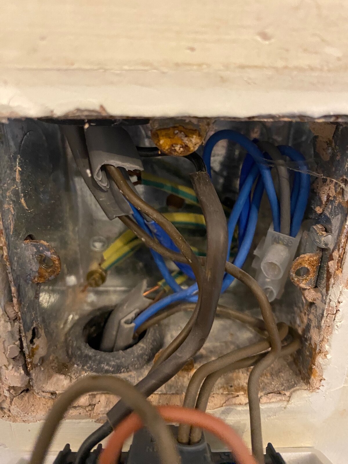

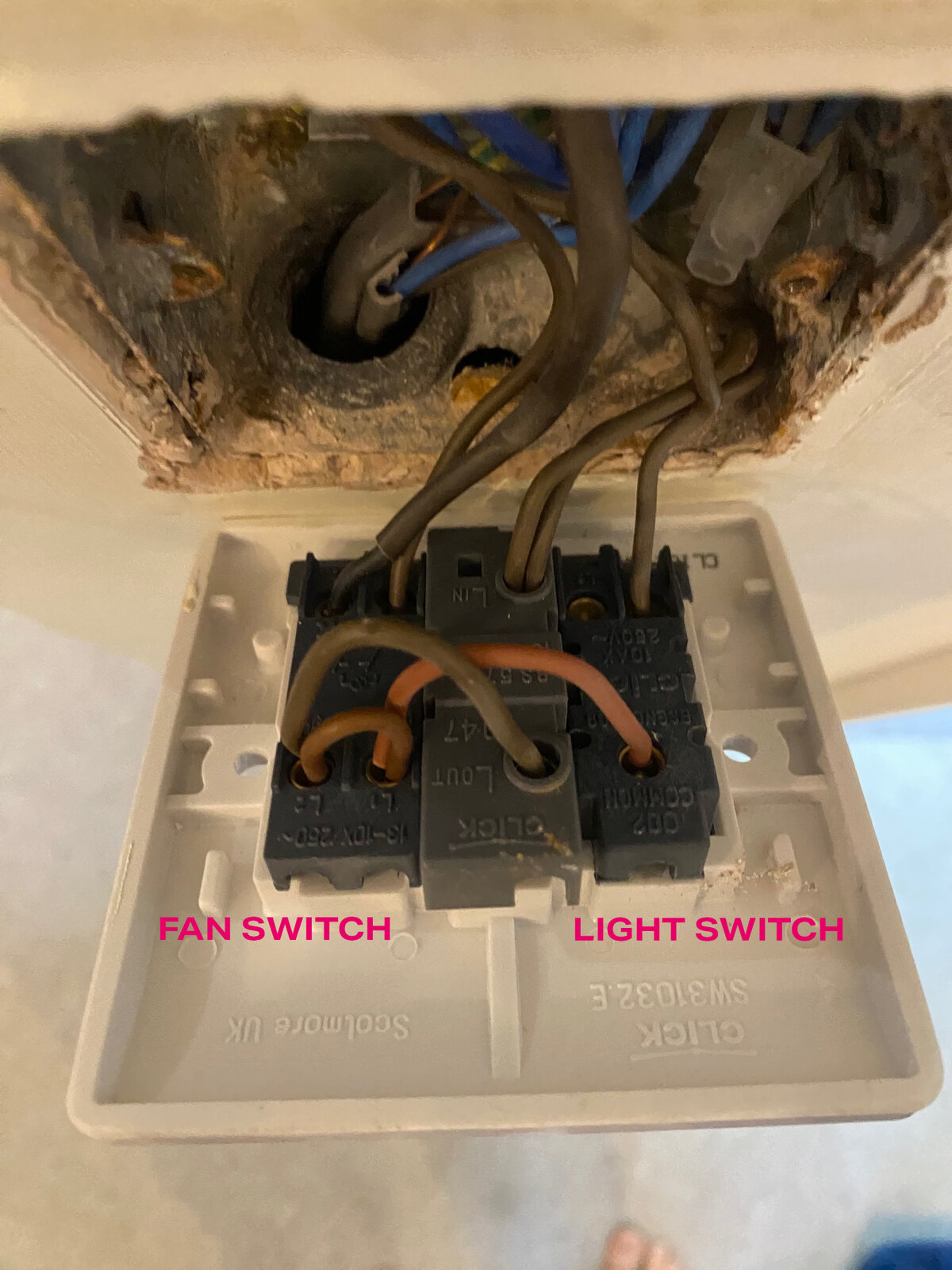

We used to have a typical timed cutout bathroom extractor fan but had it changed to non timed (the timer functions kept breaking so it wouldn't switch off). So now the switch on the wall now has two switches on the wall plate , one for the light and another fused switch for the fan.
I'm looking to change the fan to a Manrose timed inline fan and hoping that I can use the existing wires to hook up just to the light switch so the fan comes on when the light switch is activated.
Do you think this will be possible?

I'm 99% sure he did not run another wire down so it will have the original wiring. I'll take some photos of the fan wiring and the switches tomorrow. I guess if I have the switched live available on the switch there must be a capped off wire near the fan in the loft?
Probably.
Let's hope he did not get snip happy.
Here's a couple of images of the switch wiring. Hopefully will shed some light on it.
