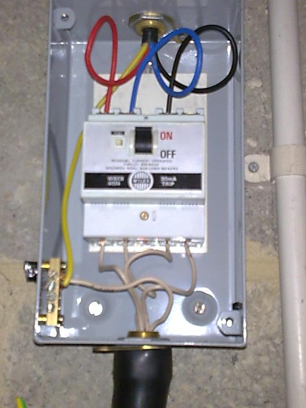

What is your opinion with regards to the tails, you can see the phase insulation is damaged, is it deemed unsafe or a recommendation?
