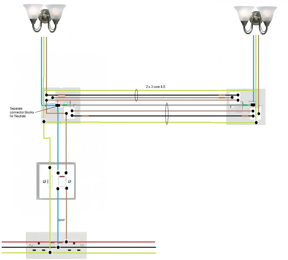

I am looking for the best way to wire up two wall lights in a bedroom, so that both lights can be turned on & off from either side of the bed with a double switch. I have power from the lighting ring. If anyone has a method for this or could post a diagram or ling to video this would be most helpful.
