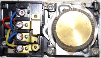

OLD WIRING:
The photo above shows 4 wires from top to bottom, and which also have terminal numbers on the terminals (on the brown plastic - not showing very well on the photo, so I've added the red numbers). These are , vertically from the top
Blue - 2
Red - 1
Blue - 4
Yellow - 3

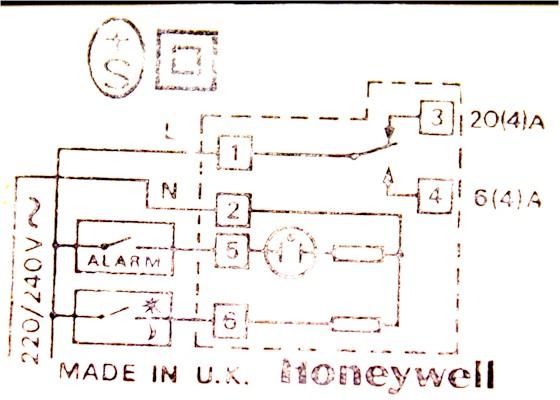

The following sticker is shown inside the honeywell box:
The letters next to each of terminals 1,2,3,4 show codes (L,N, 20(4)A , 6(4)A) so , putting the two sets of info together (i.e. the photo and the diagram), the honeywll is as follows:
1 - Red - L
2 - Blue - N
3 - Yellow - 20(4)A
4 - Blue - 6(4)A

Well I'd say your L and N are OK, which leaves the other 2. SO which is call for heat and which is call for coolth?
It should be easy enough to establish that, with the thing disconnected. If you have a meter with Ohms or a continuity bleeper, the one you want will only be connected to Live when you turn the knob UP.
Sparks won't fly even if you connect those two wrongly - it'll turn the heating on but with the knob in the wrong place, so you just reverse them.
Mark, I appears you have an extra wire (Blue on 4)??!! This is not normal & you'll need to establish what it's doing, or indeed if it's doing anything??
Normally the wiring on the Honeywell RS is;
Red Switched Live(from programmer/time switch) on 1
Blue Neut. on 2
Yellow (calling for heat) on 3
The Blue on 4 may be an earth wire being sleeved with Blue??
Dickpuller , have you never heard of motor on motor off motorised valves ie sunvic/satchwell.
good chance the system now how has spring return valves and the extra off wire is not req and is not connected further alone the circuit
highly unlikely that an earth is connected to 4 as this this becomes "live" when the stat switches, trace number 4 it is probably disconnected at the boiler/wiring centre.
Rewire as follows:-
Existing [1] to Live
Existing [3] to SL Heat On
Existing [4] to SL Heat Off
Existing [2] to Neutral.
Namsag has hit the nail right on the head and it may well be the case that [4] is no longer connected at the wiring centre. As he says, it really depends on the zone valves currently installed, but I wouldn't stress yourself on this one.
