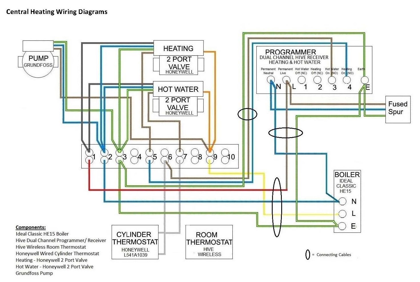

My electrician is not experienced with HIVE and is happy to run cables and connect but has asked me to provide more accurate wiring diagrams. Has anyone got a definitive wiring diagram for dual receiver for boiler and cylinder system please?

Is it ok to put receiver in cellar with controller upstairs on ground floor?
Is the attached diagram accurate?

If, by controller, you mean the remote thermostat then yes - as long as the signal can get through.
The diagram looks alright at a quick glance.

Nothing wrong with the diagram you show, it is simply a relay.
The problem which I don't know answer to is how you get the UFH to turn on the boiler, you don't show that bit.
