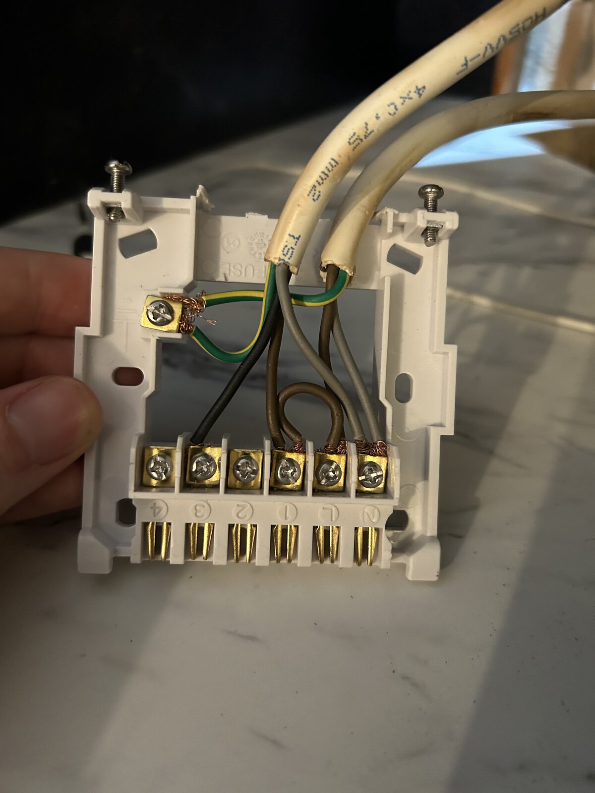

Hi All, would really appreciate some help if possible!
Purchased a Hive system to install to my Worcester Combi boiler. It was already set up with an old British Gas smart thermostat and WR1 receiver so I was hoping to keep the backplate and just switch over.
Anyway it wouldn’t fit and the wires were more confusing than I expected.
I tried to adjust them slightly, ended up messing everything up and lost power to the boiler. After trying forever to wire the Hive receiver or the old one back in, I finally managed to get it working for Hive.
My question is, is this wiring safe? It seems to work but doesn’t seem like it’s how it should be! Photo below.
Any help would be appreciated, thank you!

If I do, would that be correct to leave the wiring like this then? Don’t want to do any damag. Cheers.

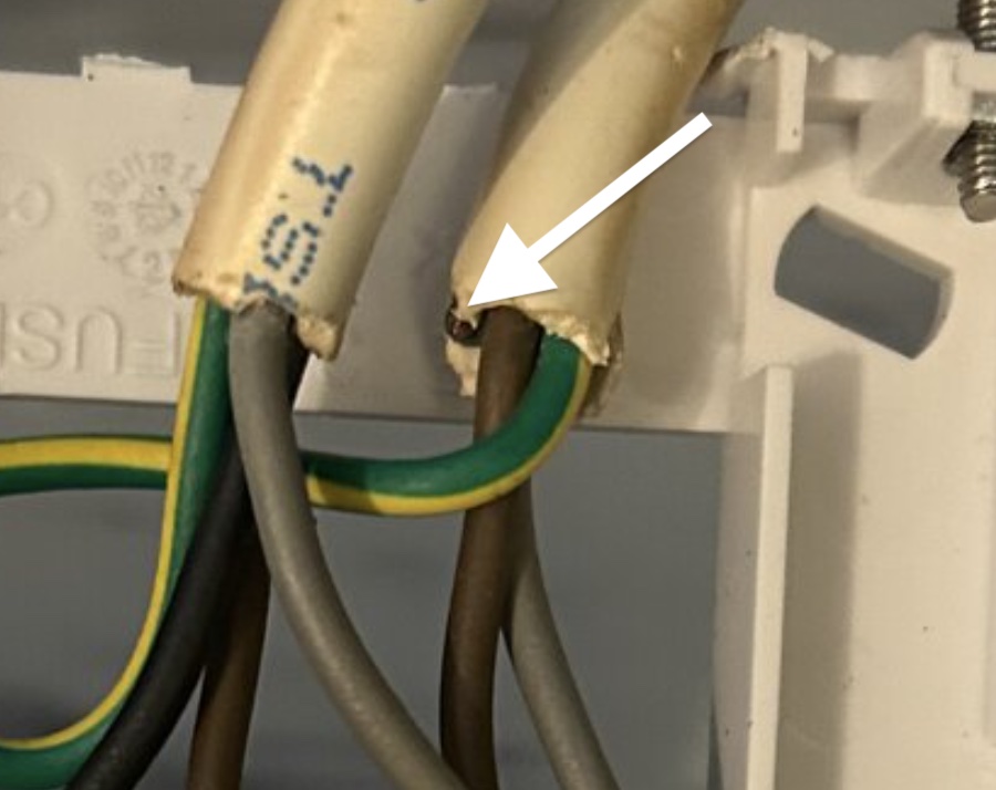

Impossible to say for certain, unless we can see where the other ends of those cables connect!
But, it looks like you've managed to get it to work, nothing went bang, so should be OK.

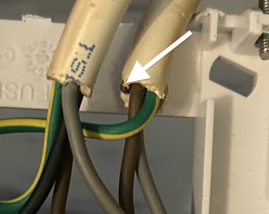

I'm going to make a comment about the original wiring. Nice to see 3-core and earth flex used, but why, oh why did some numpty chop off the spare black in the supply cable? That might come in useful one fine day......

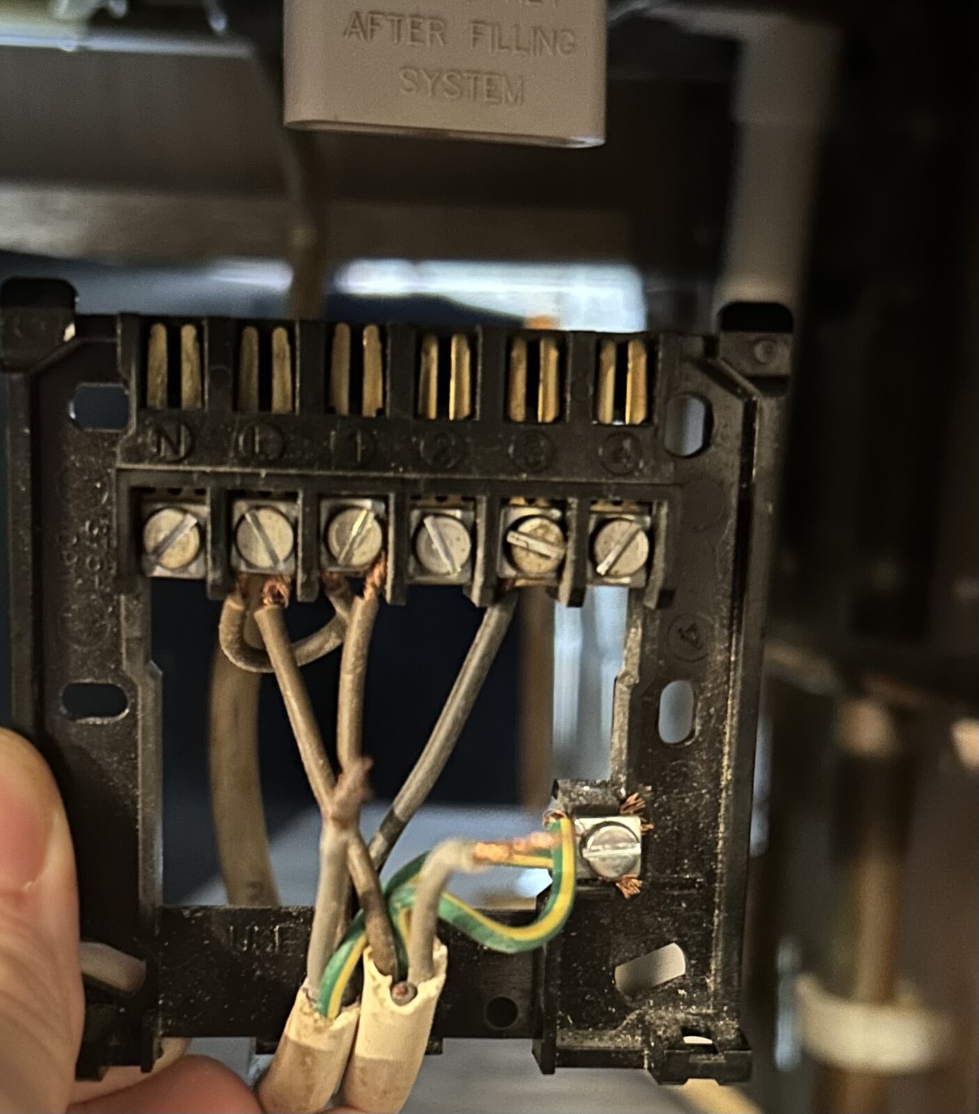

If it’s useful, this is how it was wired up originally to the WR1 receiver so I’ve pretty much mirrored this in the end but added the neutral back in. Not sure how this was operating without anything in the neutral terminal?
