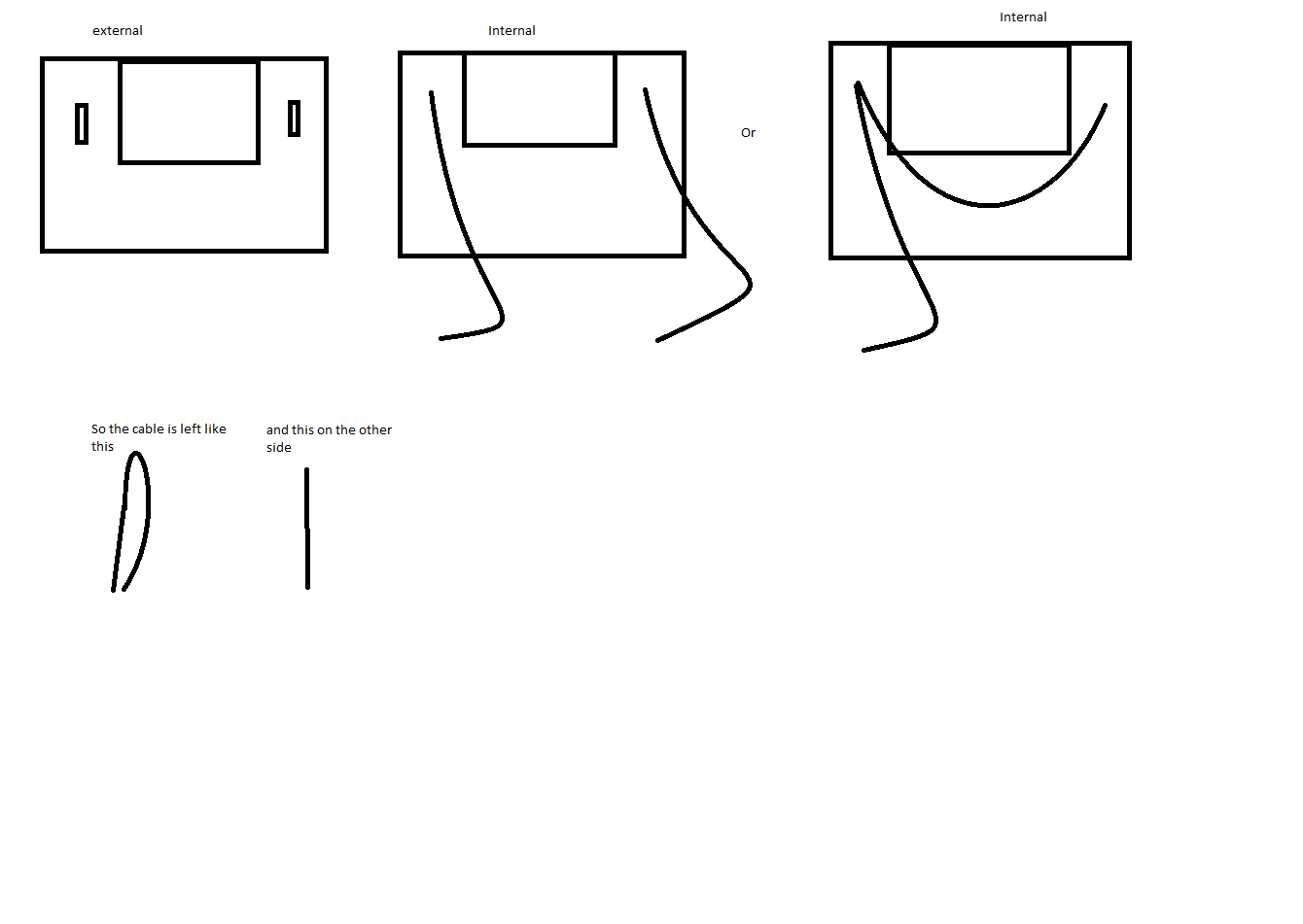

Hi,
I am converting my garage and while the door is being bricked up for a window I want to add cabling for 2 external wall lights either side of the window as per the diagram attached.
Looking at lights similar to this: https://www.diy.com/departments/blo...outdoor-wall-light-760lm/3663602893752_BQ.prd
I have 2 questions,
1, is 1.5mm cabling ok to use?
2, should I run 1 cable to each of the lights or 1 to 1 and then daisy chain onto the other
Many thanks for your help

Hi Bobbya82,
You can use 1mm if you want, but 1.5mm is fine too. If you want the lights to operate from the same switch you can daisy chain them.
Thanks,
Huggybear.
1.0 mm is all that is required. Why have got lights that light up the sky? Get ones that shine down only.

Nothing to do with building regs. Yes it would pass electrical regs, but absolutely no point and a waste of copper and money. Use 1.0 mm which can safely carry up to 16 amps so no problem.

Long is meaningless without knowing the load. LED lights are a very small load any anyway LED lights are not worried about voltage drop so don't worry about it and use 1.0 mm cable.
It may be easier for you to run one cable to each fitting, depending on the wiring space.
If you are wiring these lights from scratch, then run each cable back to the switch box and have the joint in there. Use a 25mm box.

It depends on the situation and position of the fittings.
Presumably you have an existing light.
Does the supply cable run to the light with a switch cable then down to the switch, or
does the supply cable run to the switch with another cable to the light, and
will you want the switch for the new lights in the same place as the existing switch, and
might you want a PIR sensor for your new lights?
Hi
This will be a new setup, there isn’t an existing outside light. However there is an existing light inside the garage, just wanted to put the cables in while it was being bricked up. Switch will be at the over end of the converted garage.
No sensor, just normal on and off lights
