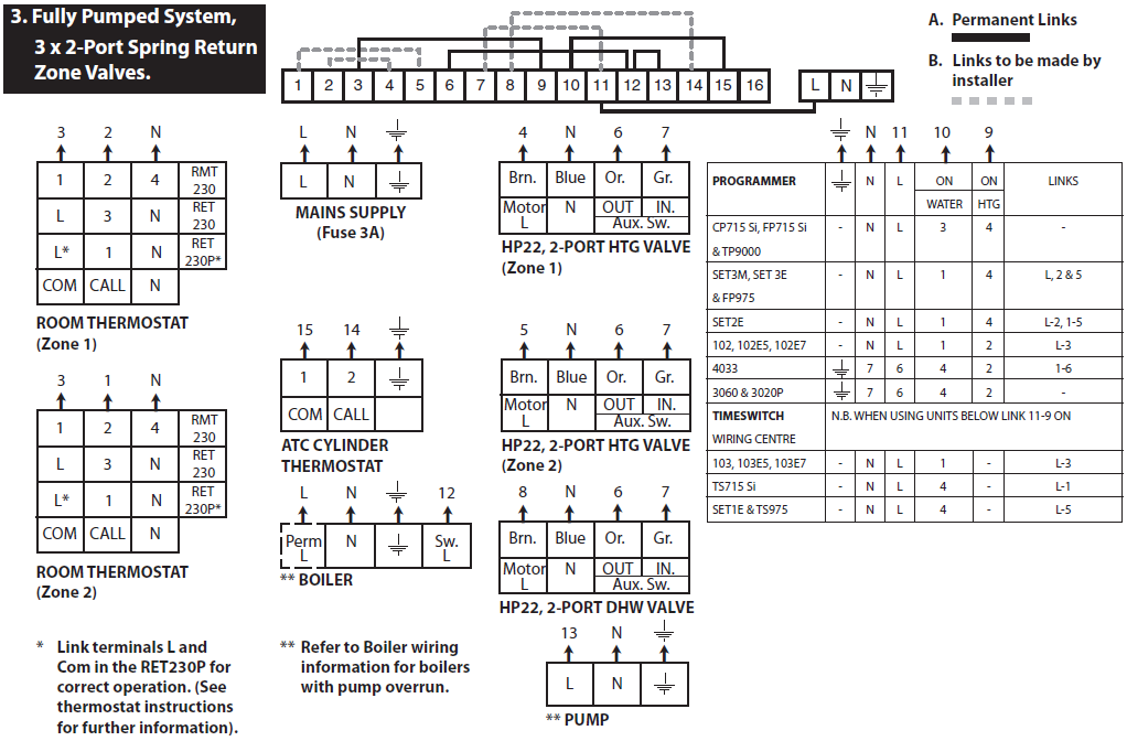

I have a Ideal boiler and tank which is a preplumed system and fitted with a Danfoss WC4B wiring centre in a S Plan with 2 x 2 Port spring return valves.
Trying to work out how to connect a heatmiser UH4 to the system. Namely, which wires go to the danfoss to call for hot water and central heating - all the zone actuators and Neostats are connected fine.
Believe it or not I have asked Heatmiser and they have turned round and said ask danfoss (like they cant actually tell me which wires are the heat calls).
This is the danfoss instructions
and this from heatmiser
I dont have the radiator valve.
Its just which wires from the heatmiser heat enable and hotwater valve go to the danfoss and which number.
This is on the inside of the actual wireing centre.
Any help gratefully apreciated, appologies if this is a simple/stupid question. Just got myself a touch confused looking at it all.
