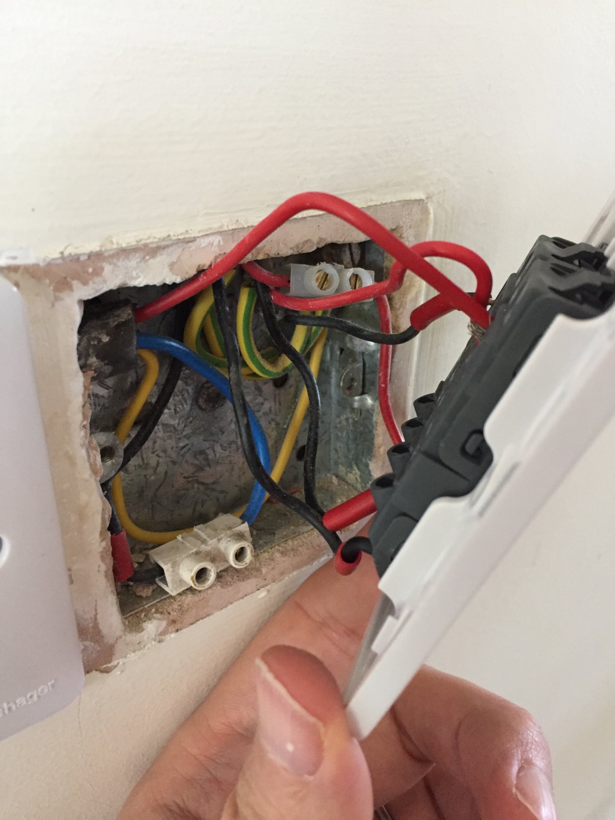

I have a two gang switch, one switch is a one way and the other is a two way.
When I unscrewed the old one from the wall one wire fell out but I couldn't work out from where so that was a bit scary.
I've wired it up what I thought was correct but it's tripping when I turn the fuse back on.

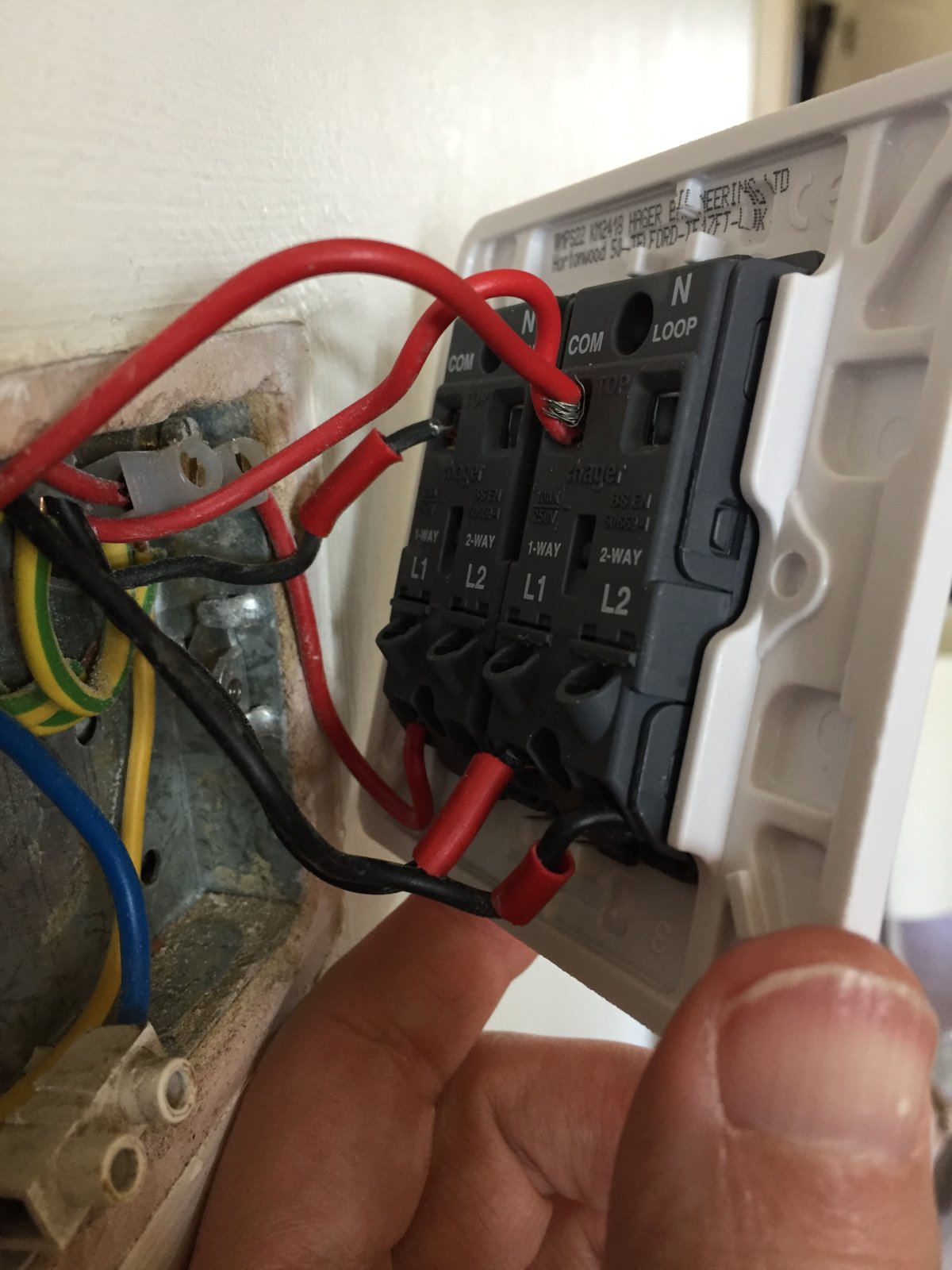

On the far switch I have one live going into L1 and one live going into COM.
On the near switch I have two live going into COM which is what was on the old switch and I have one live going to L1 and one live going to L2 however i'm not entirely sure if this is correct.

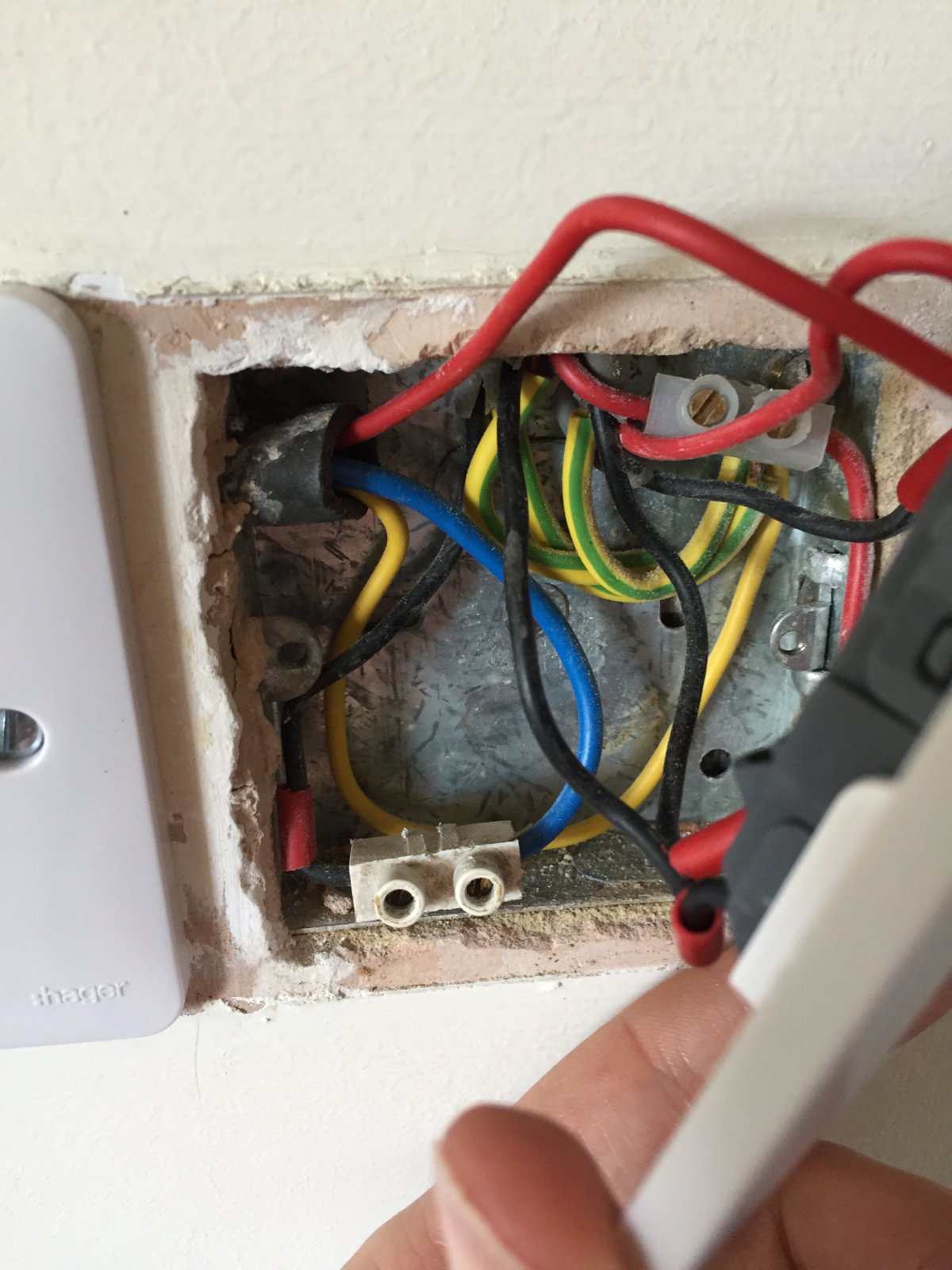

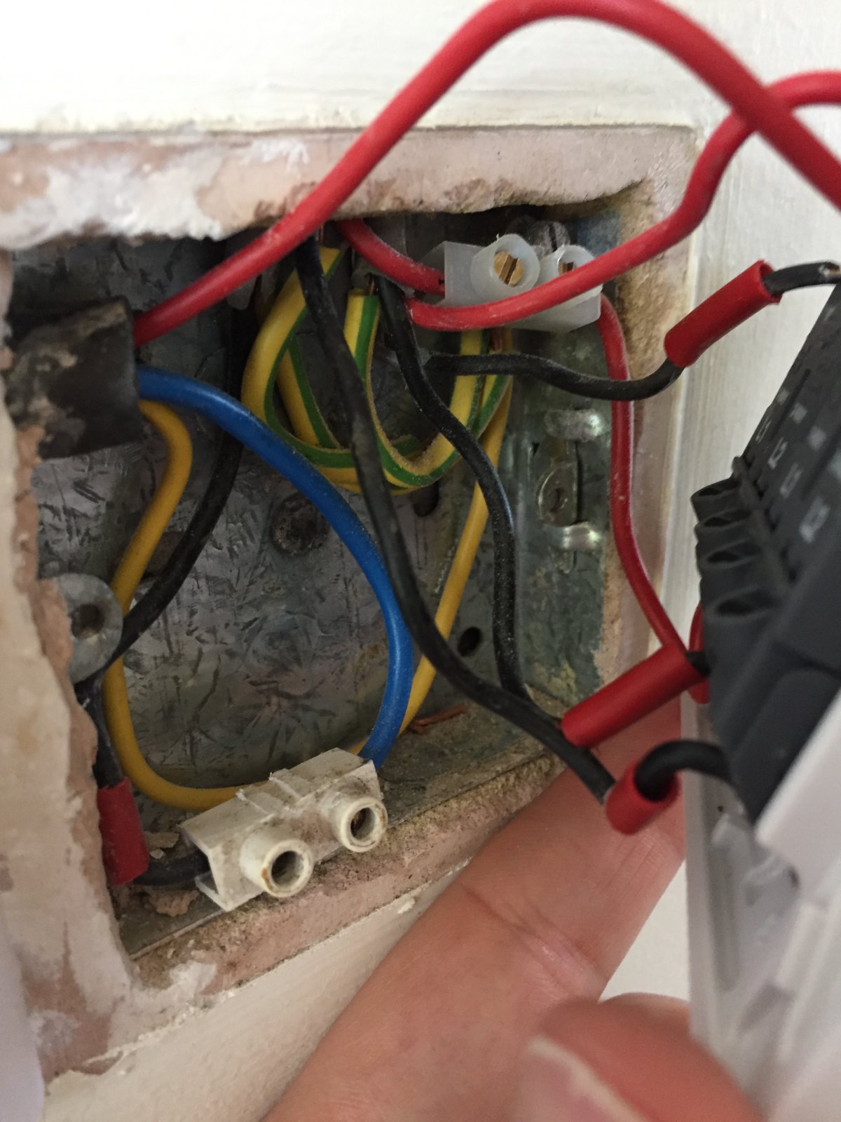

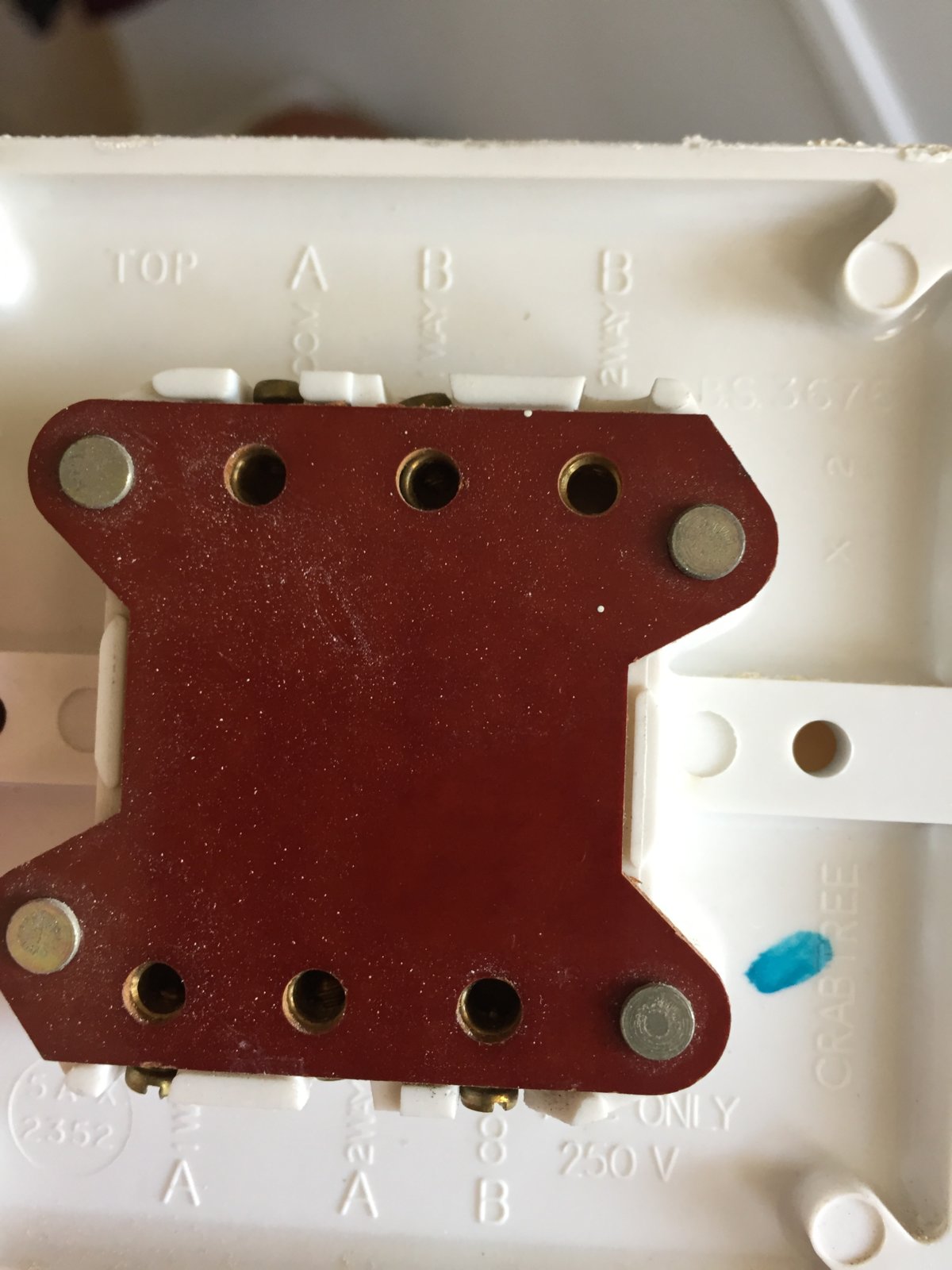

I've also included a pic of the old switch and a few more pics to show all the wires.
To be honest I think I've mixed up the wires and I stupidly don't have a pic before I started so not sure which one goes where.
I would like the far switch to be the one way switch and the nearest switch to be the two way switch

That all could be alright so I don't think it will be possible to tell from here.
(Yellow to earth could be alright if an unused conductor.
Red sleeved black which appears to be a Neutral - might not be of course)
Which wire was it that had come loose when you removed the old switch?
It was one of the black with red sleeves I think, I assumed it came out of the old switch marked A-2Way at the bottom
Can't see anywhere else likely, but if it was from a switch terminal then there's no way you can create a fault whihc trips a circuit breaker by putting it back into any of the terminals.
Unless you've got two different circuits there, and it's an RCBO tripping on a current imbalance.
