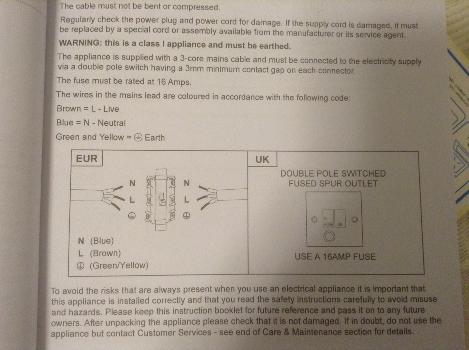

The manufacturer states ""This is a Class Two Appliance and MUST NOT be Earthed""
We've been through this many times before, and I do personally disagree with the "MUST NOT" wording that we very commonly see. As you go on to say, I think that the only reason for not doing it (assuming there is some exposed metal that could be earthed!) is ...
So what harm can come from earthing the appliance's exposed to touch metal work ? I am aware that if the person was holding a live bit of metal in one hand they could safely touch an un-earthed appliance with the other hand, but if that appliance's exposed to touch metal was earthed then they could received a severe, possibly fatal shock.
However, that's nothing to do with the safety of the appliance, per se, nor even anything to do with the fact that the object in question is anything to do with electricity - to address the argument you cite, one might just as well (in fact, probably 'more reasonably' in many cases) say that "this sink (or metal shelving, or metal window/door frame, or coat hook or ......) MUST NOT be earthed".

Given that there are some here who feel that one has to strictly stick to (or, at least, advise people to strictly stick to) the letter of the manufacturer's instructions, do you believe that use of a plug/socket would satisfy "...must be connected directly to the mains..."?
Kind Regards, John
Is there a reason the manufacturer might believe that that would make any difference?
Not that I can think of. However, it has been suggested (not by you or myself) that we should only advise DIYers on the basis of 'the letter of the MIs' (whatever those MIs might say).

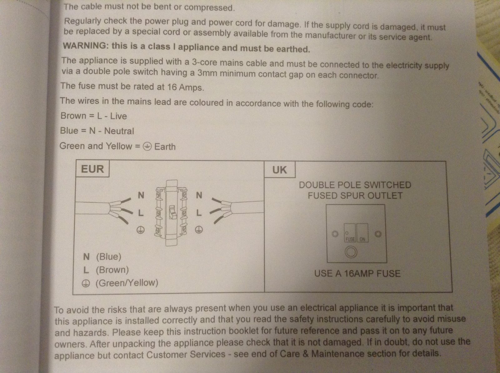

And if the manufacturers instructions are blatantly wrong and dangerous?
You would have to ask the person who said that we should only advise DIYers to follow manufacturer's instructions to the letter (as you imply, I don't think that is necessarily always sensible).
