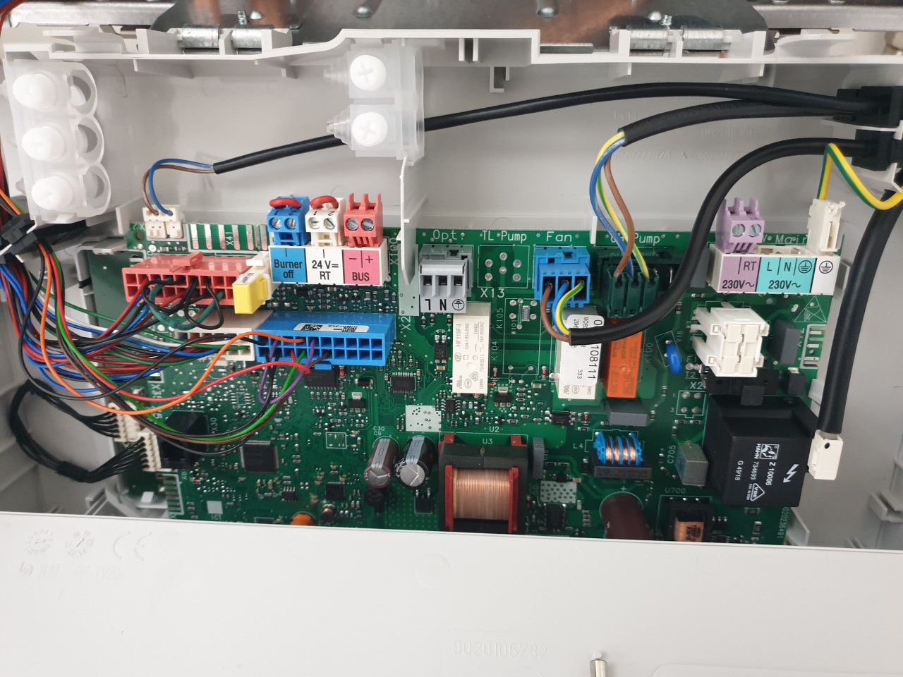

I need help wiring up a Vaillant system 637 ecotec
shall I just follow Honeywell s plan as shown below

do you mean the L cable from the boiler terminal has to terminate into orange wire in the wiring centre !

Not entirely.
The pump is integral to the boiler.
Boiler requires a permanent supply L,N,E from terminals 1,2,3 and an additional SL from terminal 10.
The rest is as shown, if you really are intending to have a separate timer and room thermostat in the style of the last century.

thanks for your help but I looked at the PCB there is no terminal for SL please see the attached photo

And don't forget to remove the red link wire in the 24V RT terminals or the boiler will run constantly.
I would guess some modification will be required with a modulating boiler, the thermostat should not turn boiler off/on but up/down yet the timer will still turn boiler off/on, so the thermostat will not be connected to the motorised valve as in old system but direct to boiler.
