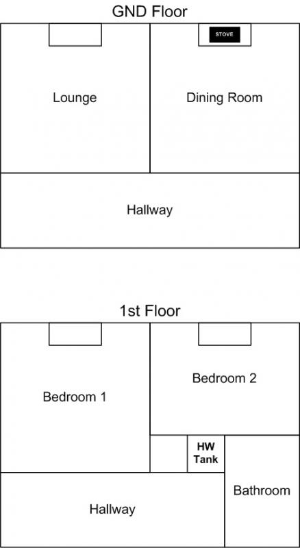

After a fair bit of research, and a weekend spent tracing out my existing plumbing, I thought I'd post an update.
The gravity circuit is near impossible so I can't do it. Basically there's not enough space in the loft around the edges of the room for me to get in and run pipes. Yes I can get in but access is really tight, and at under 10 stones, I'm pretty small. Unless I resort to a midget plumber, or ripping half the house to pieces it's a no-go.
So...
In answer to ericmark - it is possible to run a pumped system, and it does need to be triggered at a certain temperature to make sure the boiler runs efficiently and condensation isn't caused. But there should also be some additional protection. Here's what I think I'm going to do:
Pumped circuit through stove, triggered by temperature sensor behind stove so pump only runs when efficient temperature is reached.
small gravity circuit behind stove with heat exchanger, and dump connected to mains with a 95degree valve (so emergency heat dump on small gravity loop).
I found the details on www.heatweb.com - I'm probably going to buy one of their cylinders. They show all sorts of options and this is what they suggest if the cylinder can't be gravity fed.
here's a direct link:
http://www.heatweb.com/xcelinstall.pdf
see page 18.
I thought this might be of interest as the document describes all manner of installations and would be of help with any setup not just ones involving their equipment.
I'm just wondering how easily I could hide the small gravity loop behind the stove - the neatest way of getting it all installed. If I boxed in behind the stove is plasterboard heat proof? (i.e. there's a lot of heat back there behind the boiler)...
still researching, and need to get some floors up...
What about pumping the stove controlled through time clock,high and low limit pipestats, then no need to worry to much about routing to ensure gravity flow.
Pipestats stop pump from circulating The hot water in the store back to a cold stove until the stove is up to the required temp.
Store still warms like a buffer. Too hot no boom as anti boil relief to drain operates.all standard fittings on a dps store with solid fuel input.

lol. It was a good journey for me to go on though, and I'm such a visual person, I needed to see the drawings to understand it properly. I still need to understand a bit more about the anti-boil to drain - I haven't got much space behind the stove and I could do to hide the piping.
So my remaining problems (design related) are just weight I think. I was wondering if I could install a smaller unit in the exisitng airing cupboard upstairs, coupled to a second much bigger heat store downstairs (say in the garage). The reason I'm thinking this is that it would good to store a good chunk of heat every evening, so the house is warm when we get home the next evening, before lighting the stove. I don't like my chances of putting that monster in my airing cupboard though!!
this weekend I'm pulling up carpets and floors to find the rest of the existing plumbing and look for suitable routes for the new circuits...
