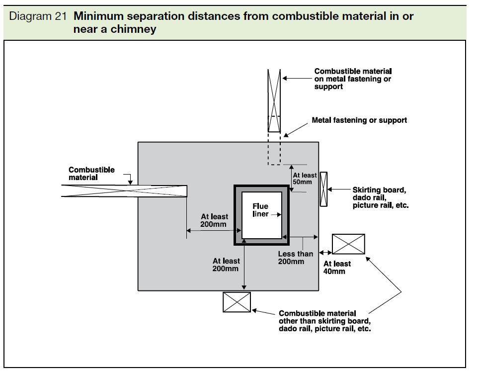

Part J regs and the BCO - do I need to re-seek approval for the stove/chimney given it's already in place? If Yes, do I notify in advance just as if I was having an extension done?
Part J regs - distance from combustibles. I'll have the cheeks/back of the fireplace wet plastered so there are no combustibles (plasterboard or studwork) anywhere near the stove, and I think any other combustibles should be 3x diameter of the flue away from it. No problem. Other than this piece of timber I was thinking of fitting as a substitute mantle.. The stove doesn't get regular use but that doesn't mean I want to be fitting timber where it's likely to char or ignite. Using timber here would give more options with regard to hiding signal cables. I've learned from a previous post that I cannot embed trucking horizontally into the chimney breast.

A sound approach, and given there's already a concrete lintel there then this is promising. Do you take any measures to protect the faced oak beam from the direct heat from the top of the stove? I measure the top of my stove to the bottom of the register plate (which is in contact with the lintel) as 11".

As long as there is at least 100mm thick walls to the chimney a mantel shelf can be fixed directly to the chimney breast. If you read the note in Part J 2.18.c page 34 accompanying Bernard's diagram, skirting board, dado rail etc. and mantle-shelf are OK.
A friend had a woodburner installed a while ago (by a "qualified fitter") with a full depth structural oak beam spaced only about 25mm from the black enamel flue pipe. The oak beam was burning nicely with the heat from the flue pipe that close. If you manage to char a timber mantle with 11" separation from the appliance I would suggest you've got a thermonuclear device and not a woodburner.
