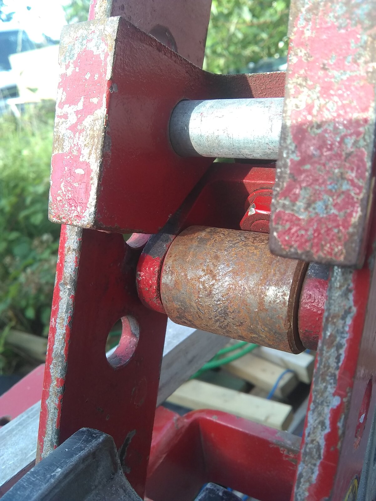

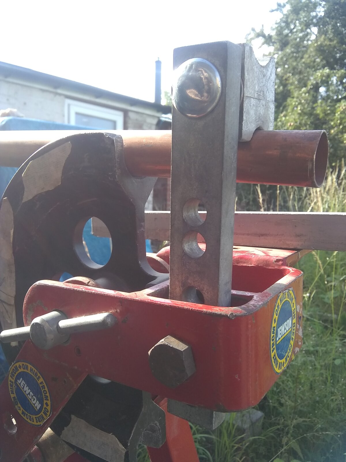

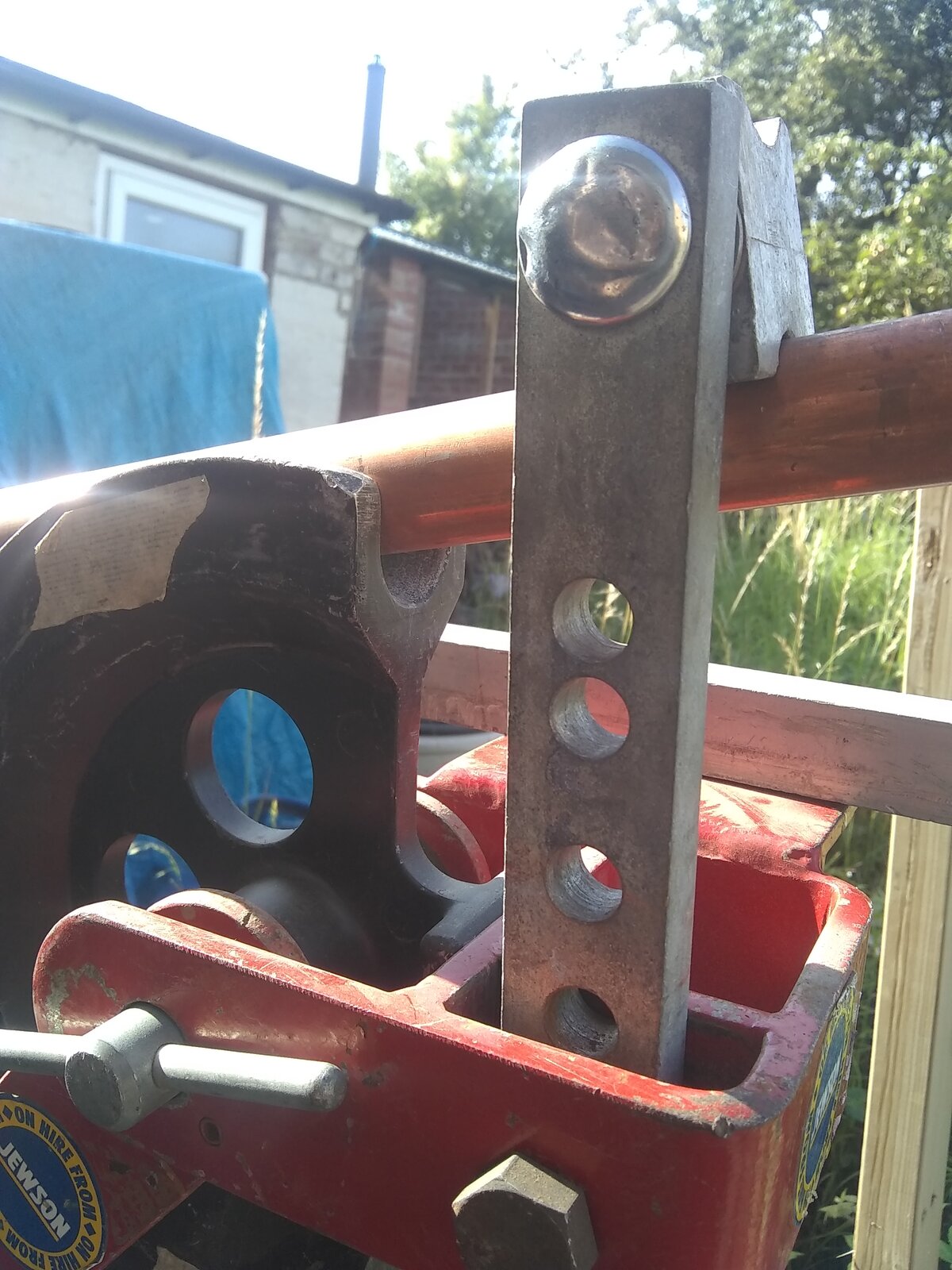

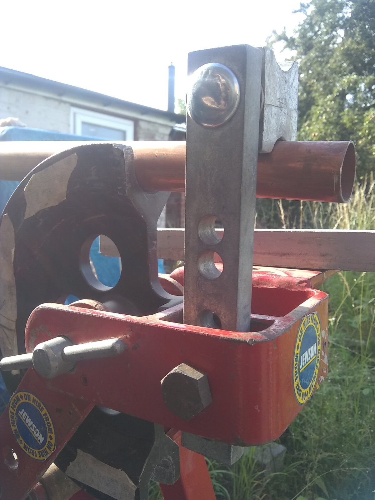

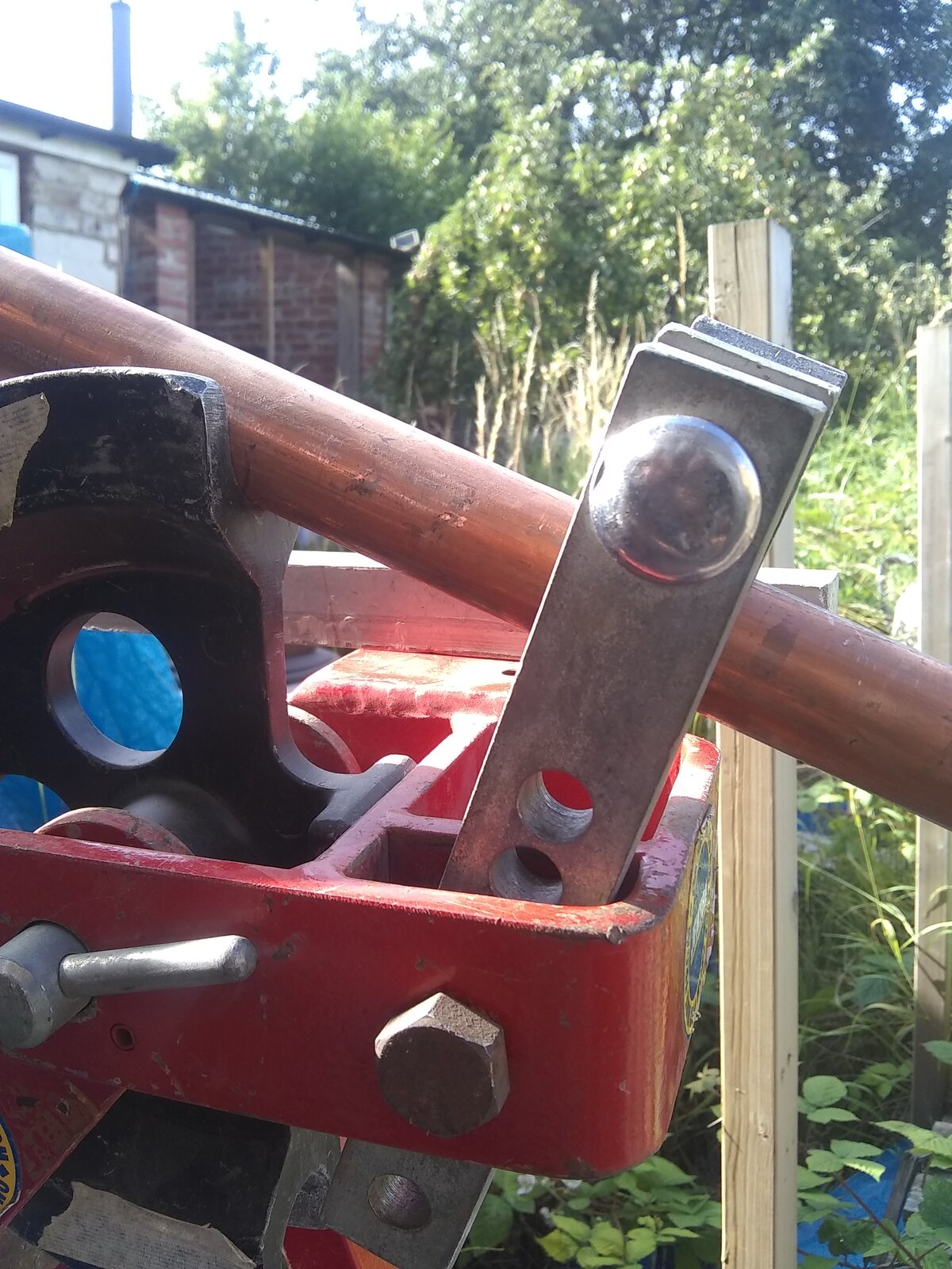

This hired one looks like a Record 35, i've set the end hook so tube is level in the form, i've set the roller so clearance from bottom of form to roller is 44 mm (thinnest point of die is 16mm, tube is 28mm). Is that anywhere near? (Had a good search on here and Youtube for setup clues, no joy. No guide marks on the side of the roller carriage, Jewson instruction sheet says put the right size form & die in and bend away. Ta
I take it that you are pulling the bends up and not downwards, put the hook/stop in the third hole down for 28mm, (the first one's for 15mm) slide the pipe in, it should be running down away from the back of the bender, slide the guide in and rotate the handle until the wheel bites on the guide but not too tight, then pull away.
Maybe not a Record 35 then, this thing reckons it bends from 12 to 35mm, i've got forms for 15,22 and 28.

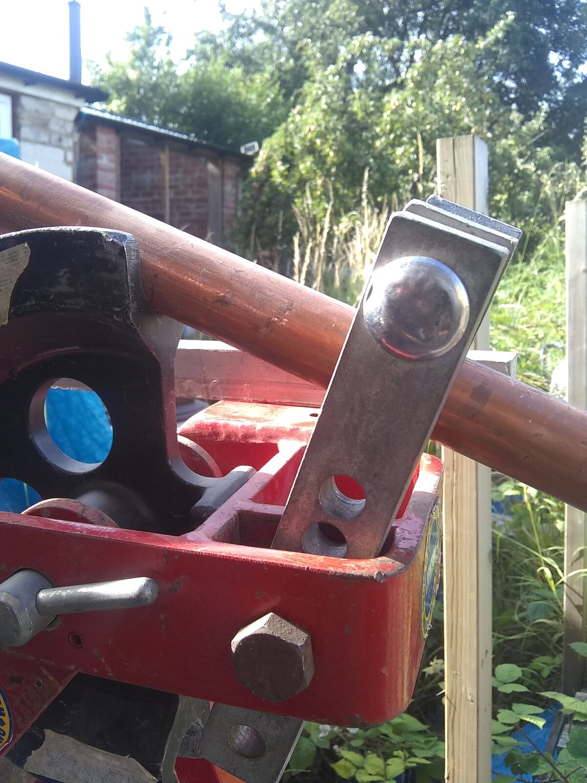

Hook has 5 holes. Option 4 looks the closest but it doesn't look right.
3rd hole
4th hole
5th hole

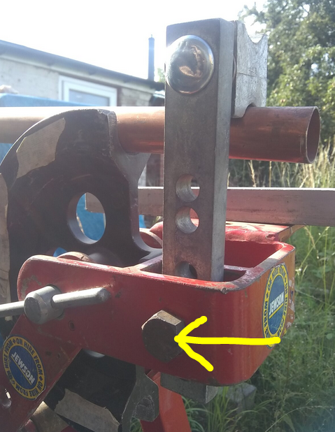

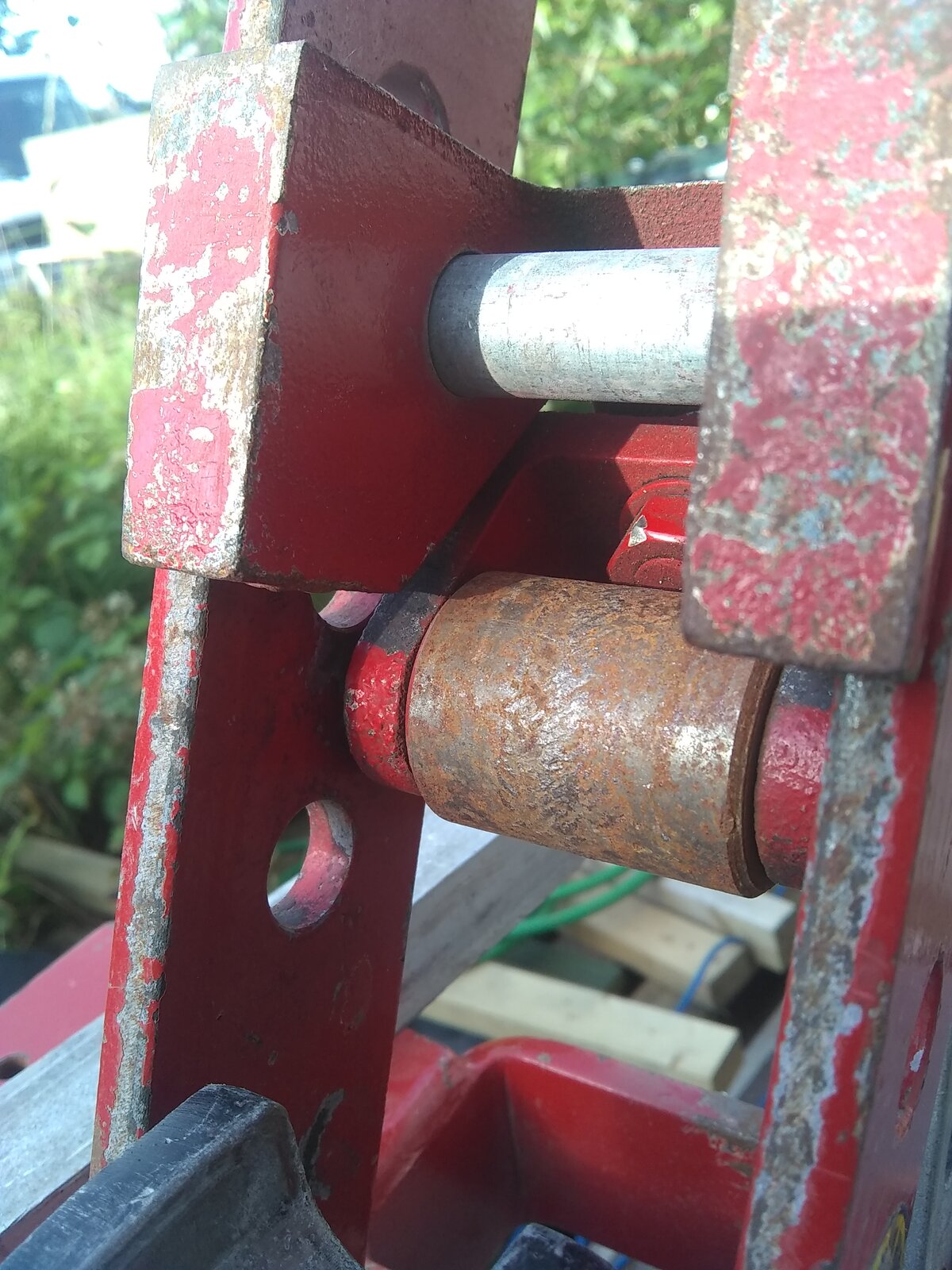

The roller only has 4 hole stops and a bolt for adjust, got it set pretty much as your description. If it was 22 i was playing with i've got enough scrap bits to experiment, 28mm is a bit precious for that.
And no this one bends down
Arr, i was looking at the thing & pondering that solution.
Another little foible with this thing, the roller height adjust is not parallel to the lever. Should the roller be in the middle (my bet looking at my toy one) or leading the lever or trailing the lever?2020-07-29 18.16.42.jpg

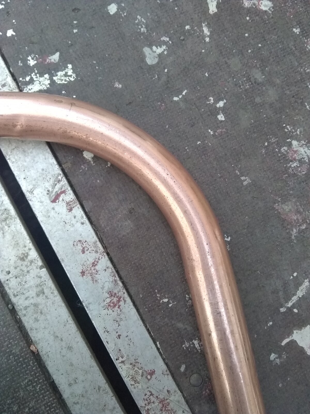

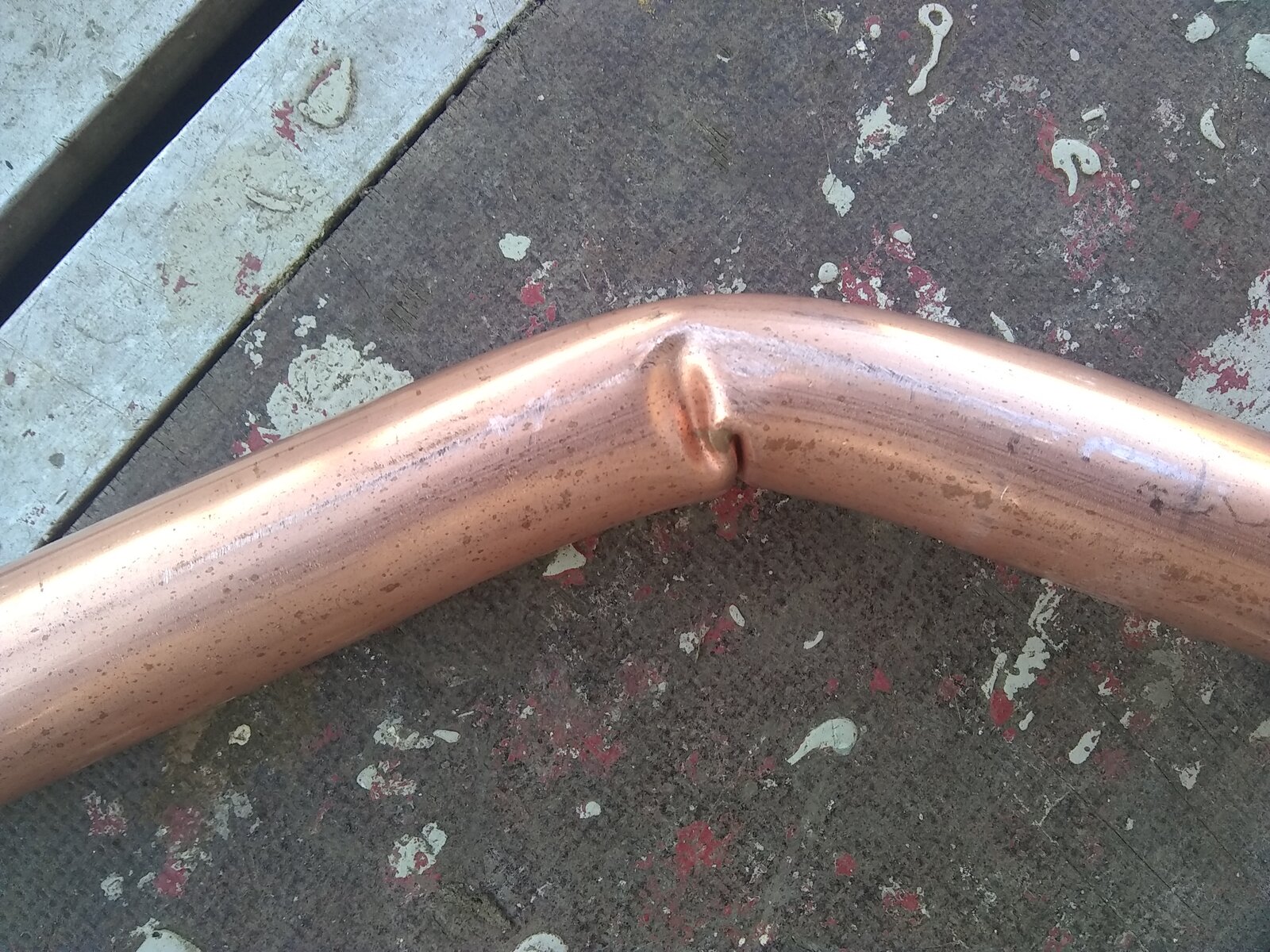

Ta. Just about to do a proper bend (80 degrees), done several 20 deg offsets & they"re getting better but still not nice and smooth. See what happens with this one.... :)

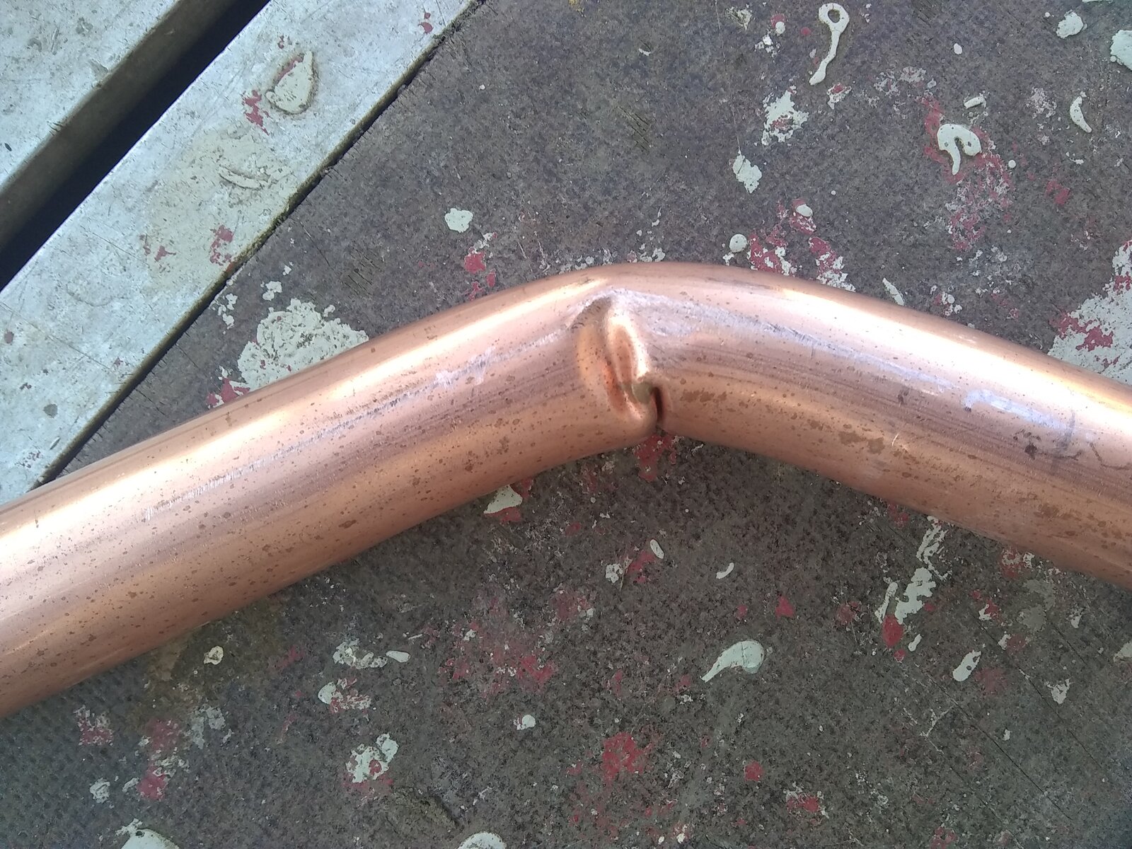

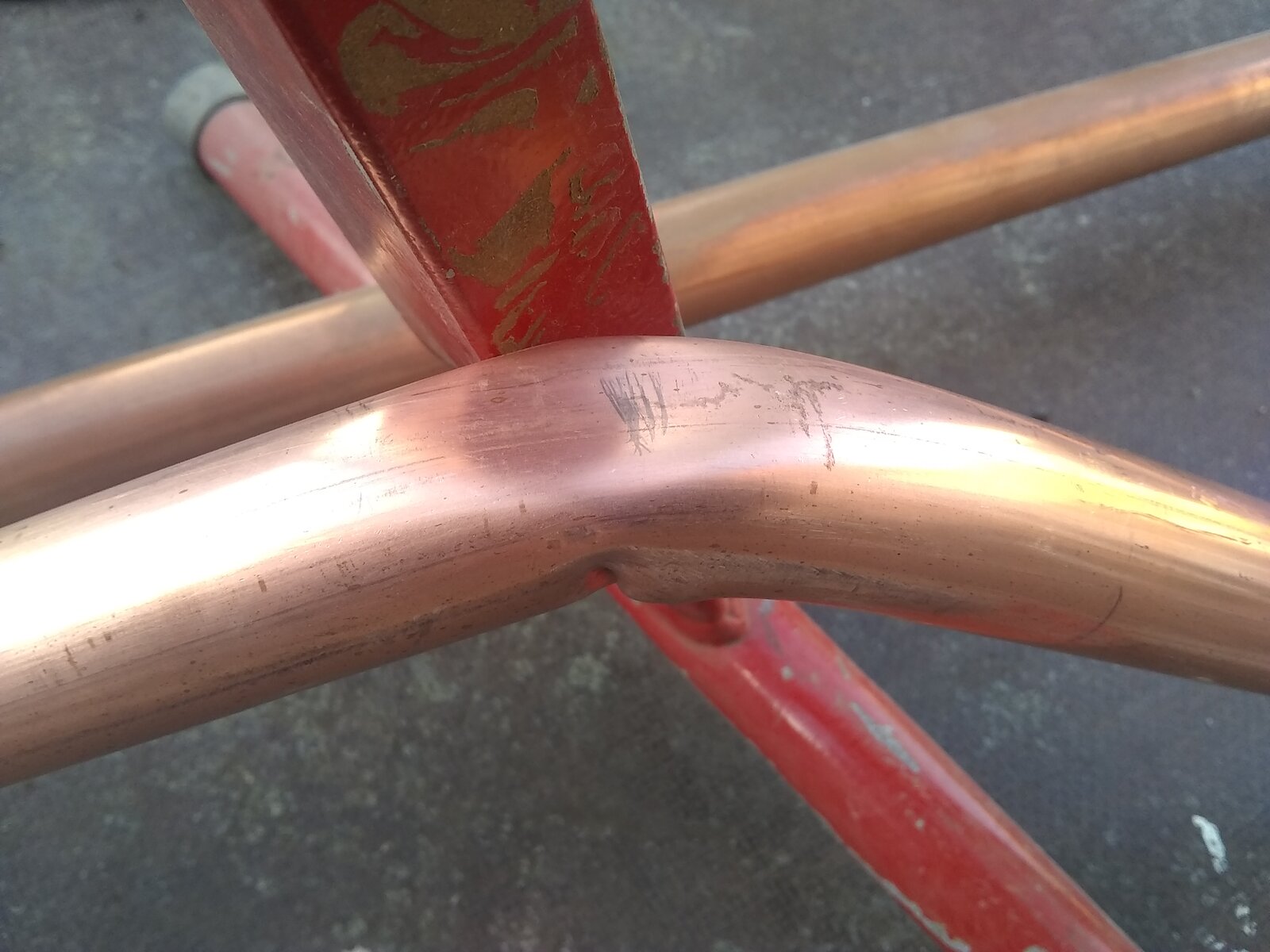

Well that didn't go well. I can feel Plan B coming on (unless anyone can look at that piece of scrap & tell me where i went wrong :(

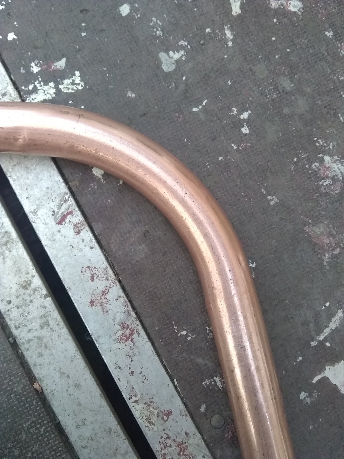

And now i'm very confused- the form looks symmetrical but obviously it isn't (the stamping where it says 28mm was upside down so swapped it round, pulled another one from the bottom and hurrah!
Trouble is i'm now going to spend all night wondering whether to redo all the jogs (= scrapping 3m of tube). At about £6 a metre.... I think i probably will, the smooth bends look sooo nice (and the kinks will be bad for flow in a gravity assisted circuit).
