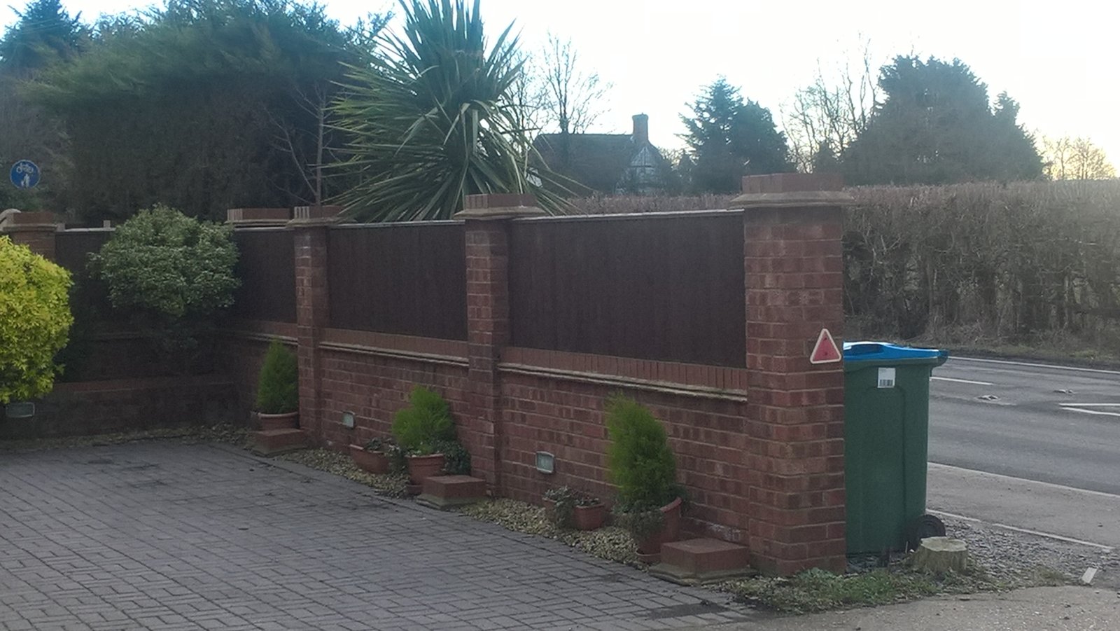

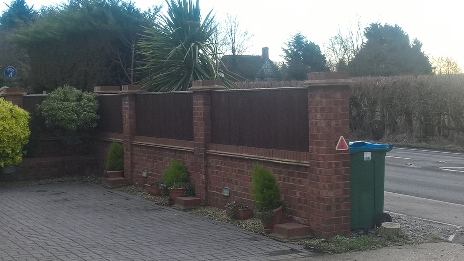

I am trying to achieve the following:
The brickies have built the wall. How do I achieve this please? Some diagrams/pictures would be very helpful.

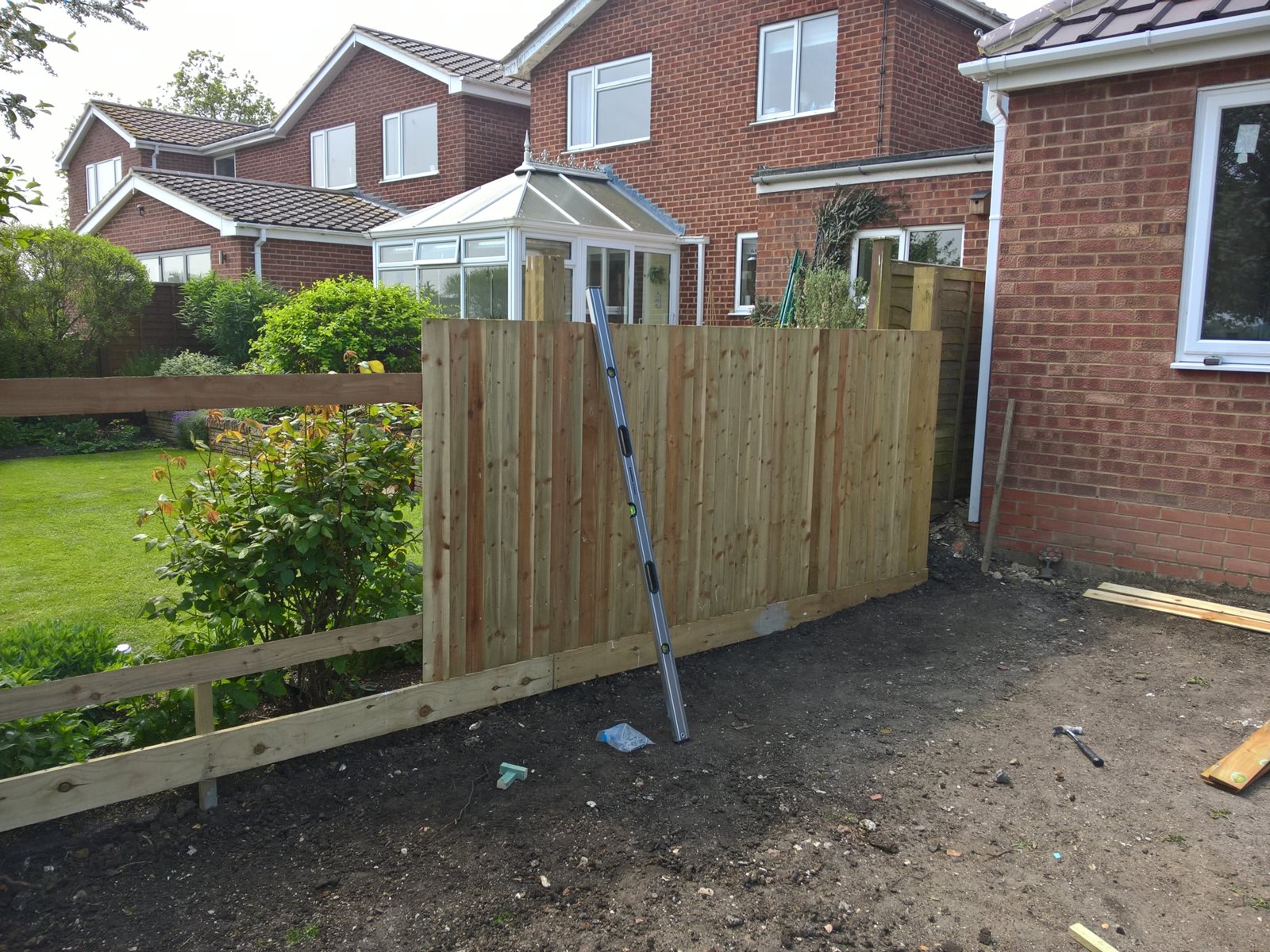

To manage expectations, I have done he following but clearly the above doesn't have a visible arris rail:
Thanks in advance

Presumably the example either has steel inserts for the hidden arris rail or has a bracket screwed on so an arris can be added. Then each side has (tongue and groove?) fitted and a top rail added as capping.

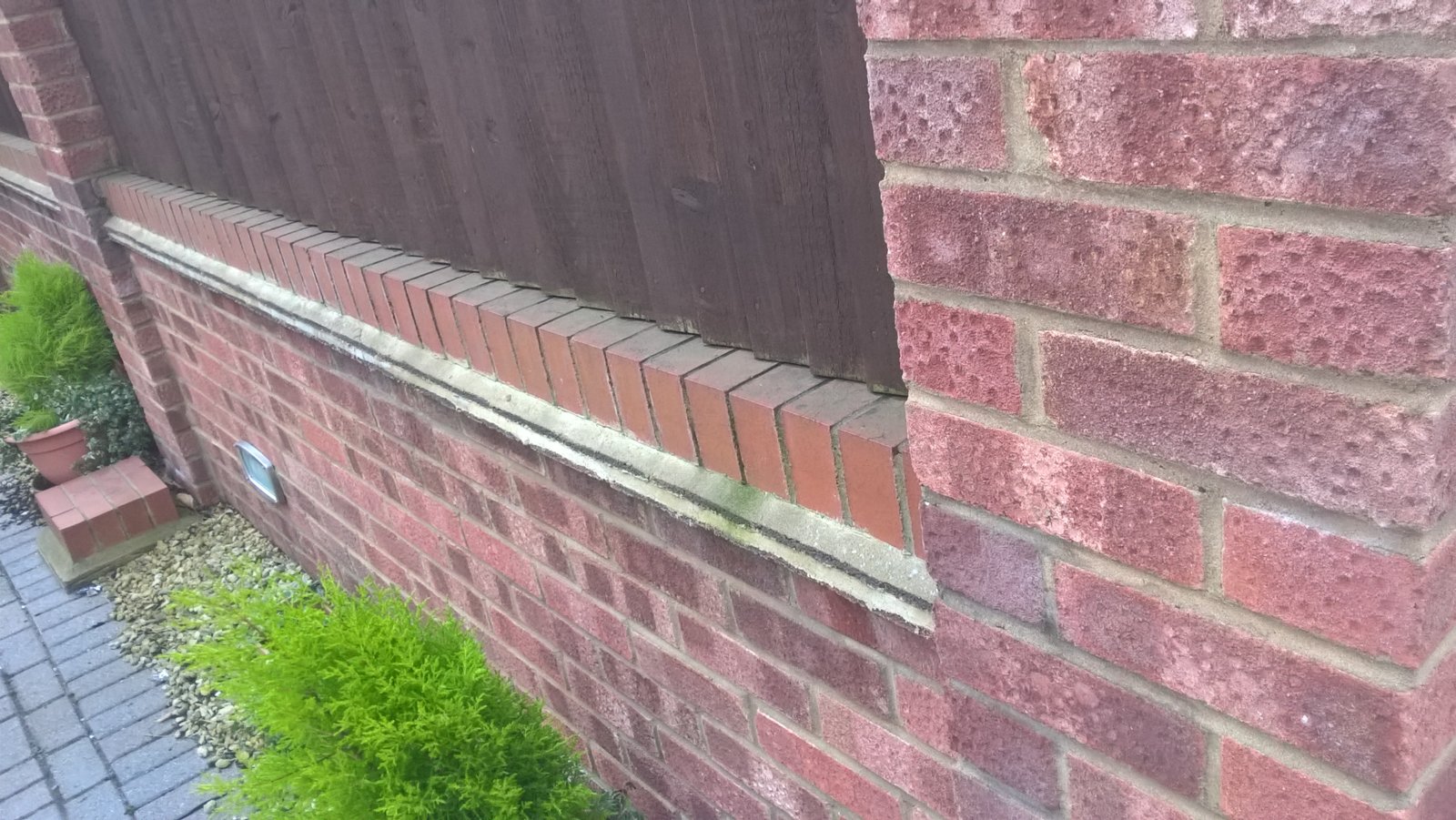

sorry guys, , let me clarify. This is a picture of my neighbours wall:
I want to achieve the same effect with my wall. I don't have a picture of my wall but it's the same as my neighbours but without the wooden panels between the piers. The builder has built the brick wall and I need to construct the wooden infills.
They appear to me as featheredge fencing but without a visible arris rail. They look the same on both sides. How do I constrict this please?
To complete the puzzle, I also posted a picture of my garden fence post my original post. sorry to cause confusion with this. I constructed this featheredge fencing. I thought it was worth demonstrating that im not a complete novice!
Does that help guys?
Doubt there is any arris rail, probably 3x2 frame clad either side with feather edged and capped to slow rot.
thanks @foxhole. That makes sense. Do you have any tips on how to construct the frame and where the fixing points should be? I would like to know which directions the 3x2 should run in and whether there should be any supports, etc.
I'd have 3x 3x2's horizontally witness the top one right at the top so you can cap it.
Do one side then fix it with some brackets, then put the feather edge on the other side to close it.

Any treated and if you put verticals in don't break/cut the horizontals.
Capping you will have to go and see.
