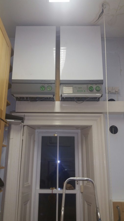

Back on the thread due to a year of inactivity on the replacements, with other priorities, the old 350s struggling on.
is the situation we have at present with the boilers high up above the window. I have 960mm from ceiling down to the top of the pipe boxing in and about 1070mm to be within the box. The WB 350s are about 315mm deep which allows an adjacent cupboard door to open across them.
The left hand boiler CH supply and return and DHW go upwards into the bathroom above, which we are at present remodelling and have the floor up so now would be the perfect time to upgrade the boilers, as I quickly realised last year that there was no such thing as an easy swap, as the flues would need to be re drilled higher and the pipework upstairs altered.
You tried to help me last year, Dan and perhaps you or someone else would know whether there would be enough room to get the flue of the Intergas ECO RF 36 in the height I have available. Their website says the case is 710mm for the RF36 model.
It also appears quite shallow at 240mm, which is very useful as the WB replacement is too deep at 370mm. Can, in effect, a hollow boiler support be built to allow the pipes to go upwards behind the boiler.
