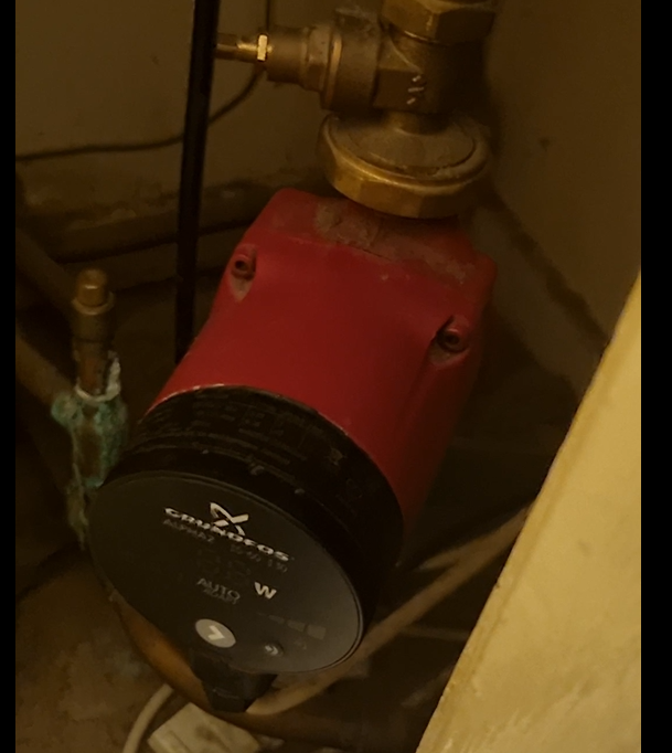

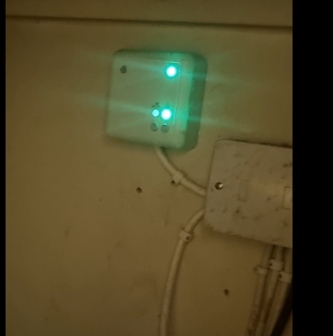

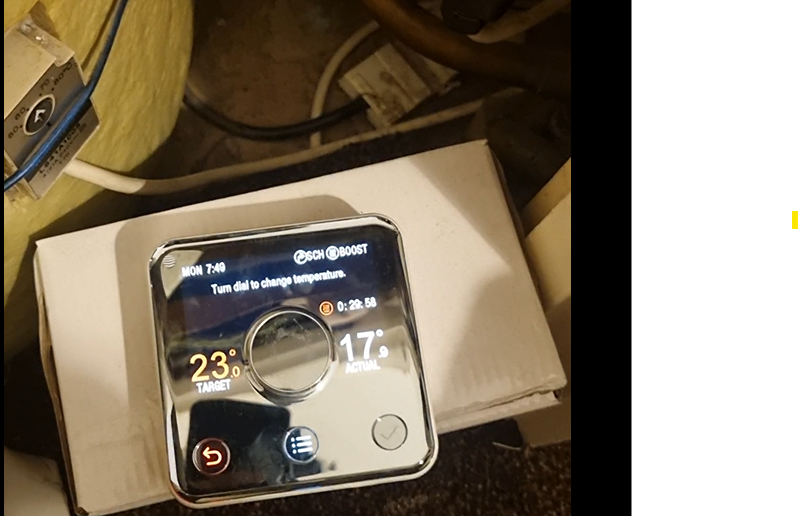

Hi all,
I came across this forum while trying to search for an answer with an issue with my boiler.
I have Worcester Greenstar 15Ri boiler, Grundfos Alpha 2 pump. I have an Hive thermostat which I use to schedule hot water/heating, or to manually switch on/off heating/hot water.
For past couple of weeks, sometimes, when I switch either hotwater/heating on, nothing happens. The boiler doesn't kick in, the water pump remains off. On other occassions it comes on fine, and works properly as if there is nothing wrong.
I had a boiler engineer who came over, but everything started working properly and he couldn't diagnose anything. I have changed batteries on my thermostat, but I still get this issue.
Here are screenshots from a video that I recorded yesterday. You can see that thermostat is on, the reciever has green light for heating, but the waterpump/boiler are not kicking in.
Any guidance would be welcomed!

I have had the microswitches in the motorised valves stick. There is a sequence of events, the thermostat tells the motorised valve to open, once open that in turn tells the boiler and pump to run. So is the valve opening, the lever will go slack when it has opened.
Even if the motorised valve is opening OK, it can still fail to trigger the microswitch which means the boiler and pump won't run.
You can get replacement valve heads, with motor and microswitch, that can be fitted without disturbing the plumbing and are quite cheap.
I always have one of these "in stock" as a standby.
