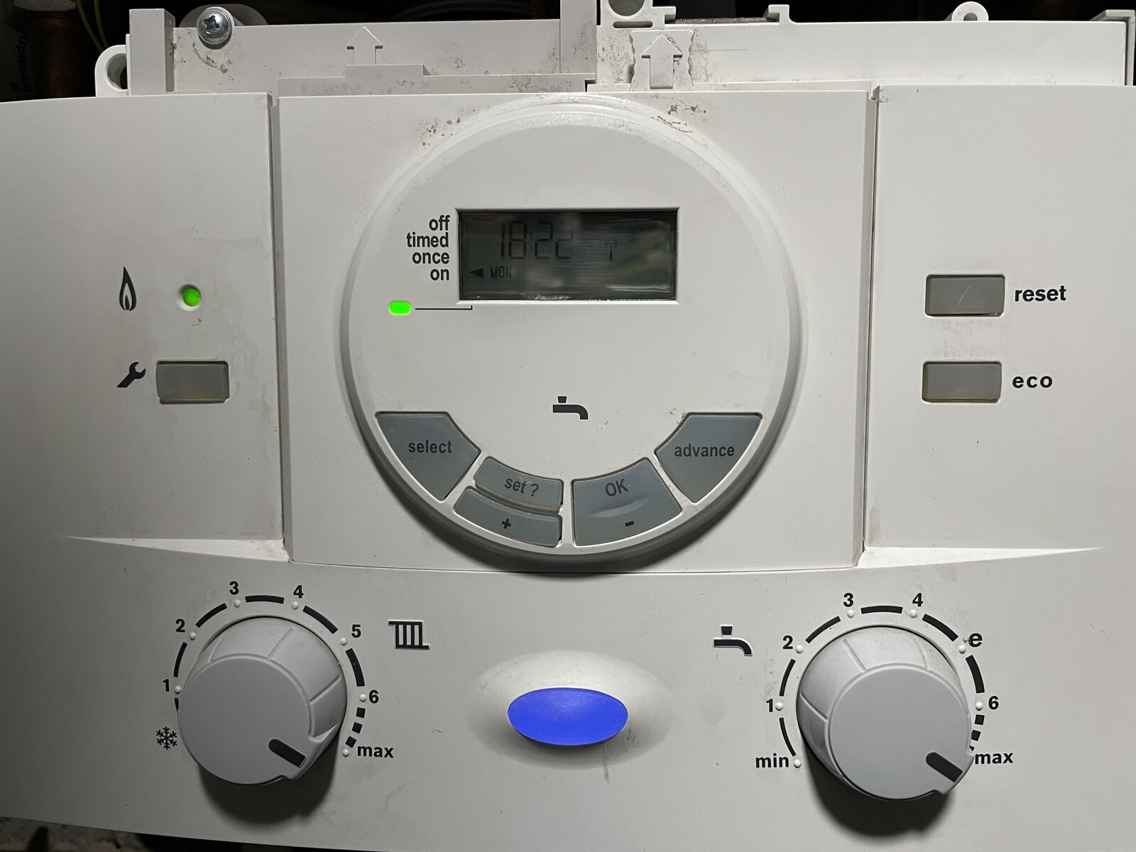

Hello all,
I've wired up per the excellent instructions here:
https://www.diynot.com/diy/threads/wiring-hive-on-worcester-bosch-greenstar-25-si-or-30-si.474730/
My Hive Receiver powers up and I've been able to complete the initial setup via the app, however the boiler never fires at the request of the Hive system.
I can see on the receiver that it's accepting the command to fire the boiler, hear the relay inside the Hive receiver click but the boiler never springs into life. I've tried it with and without the connection from Live (L) to Loop to Live (1) and it makes no difference.
My Boiler has a WB Digistat - a remote wireless thermostat. This remains in place and is still working - do I perhaps need to isolate or bypass this before the heating demand from the Hive will be accepted?
TIA.
Post a pic of the front control panel of your boiler is the receiver built into the boiler or do you have an external receiver
The receiver's integrated, yes.
I've attached a picture of the front panel on the boiler.
Thank you for the help.

Yep thought it would be that one, behind that is a ribbon that connects it to the PCB , you need to have that ribbon disconnected, if you dont it will keep looking for the Drayton stat and will act on what that is requesting
Just bolted it all back together now the kids are in bed.
I'm pleased to report that it works BEAUTIFULLY. Thank you so much for your guidance - I'd never have figured that out in a month of Sundays.
