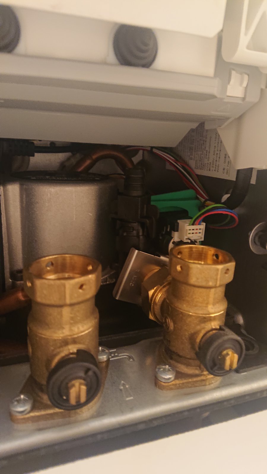

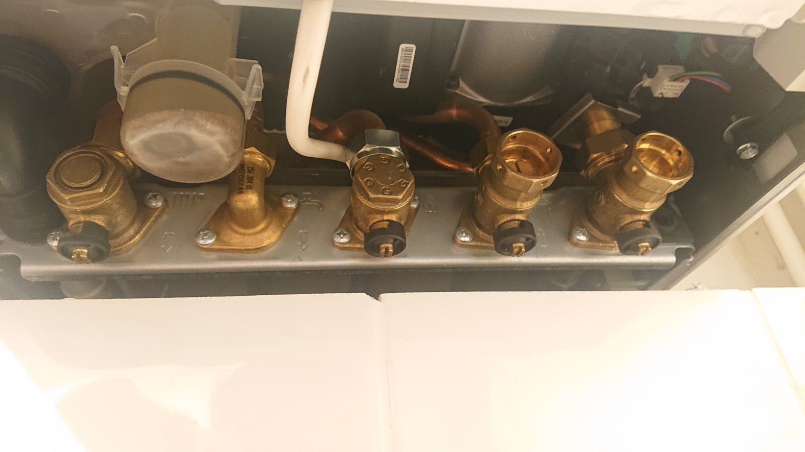

Worcester Greenstar 25i repressurise issue.
4 May 2020
2
If someone could have a look on that pictures and let me know how can I repressurise this boiler.
Thank you.
Good photos, unfortunately neither are relevant. It appears there’s no key, so your looking for a braided hose, could be anywhere. It could also be connected or disconnected.
Get it serviced and they will show you. Your condense will prob be blocked next year then it won’t work.
Think emergency breakdown!
Thanks everyone for help!
I found external filling loop - which in my place is located next to the washing machine below the boiler - the valve was quite hard to turn, but finally it works!
