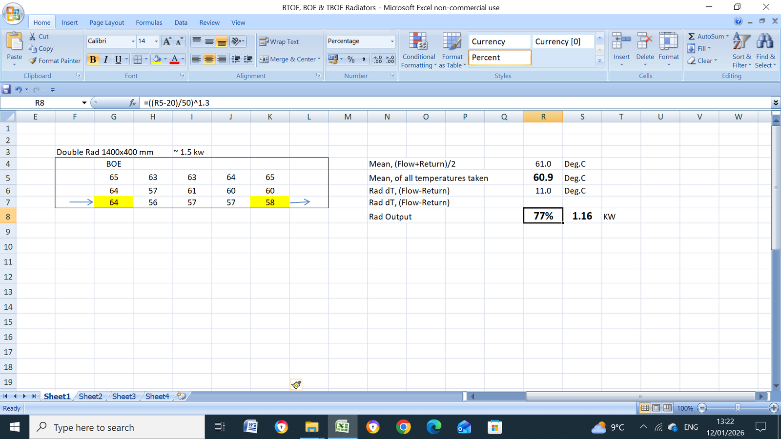

The Issue: The lounge and kitchen area (open plan) is taking an excessively long time to rise from an overnight 14°C to 19.5°C, with significant cold spots in the far end of the room from the single (undersized) radiator. Gas usage is high (55-70kWh/day including showers and hot water usage) because the boiler appears to be throttling or cycling prematurely. Reflective foil has been installed behind all the external wall radiators in the flat and the lounge radiator has 2 x 5 fan units running on the top to move the air through faster so as to get the heat to reach the cold spots.
Despite prioritizing the lounge, the radiator surface struggles to get past 50°C. However, the boiler's service menu i14 (Return Sensor) reports 60°C.

  • Manual pipe reading: 45°C on the Return pipe at the filter. (Measured using a digital kitchen thermometer held firmly against the copper pipe).
  • Lounge Radiator: 50°C (measured with a radiator fan sensor and the same digital kitchen thermometer)
