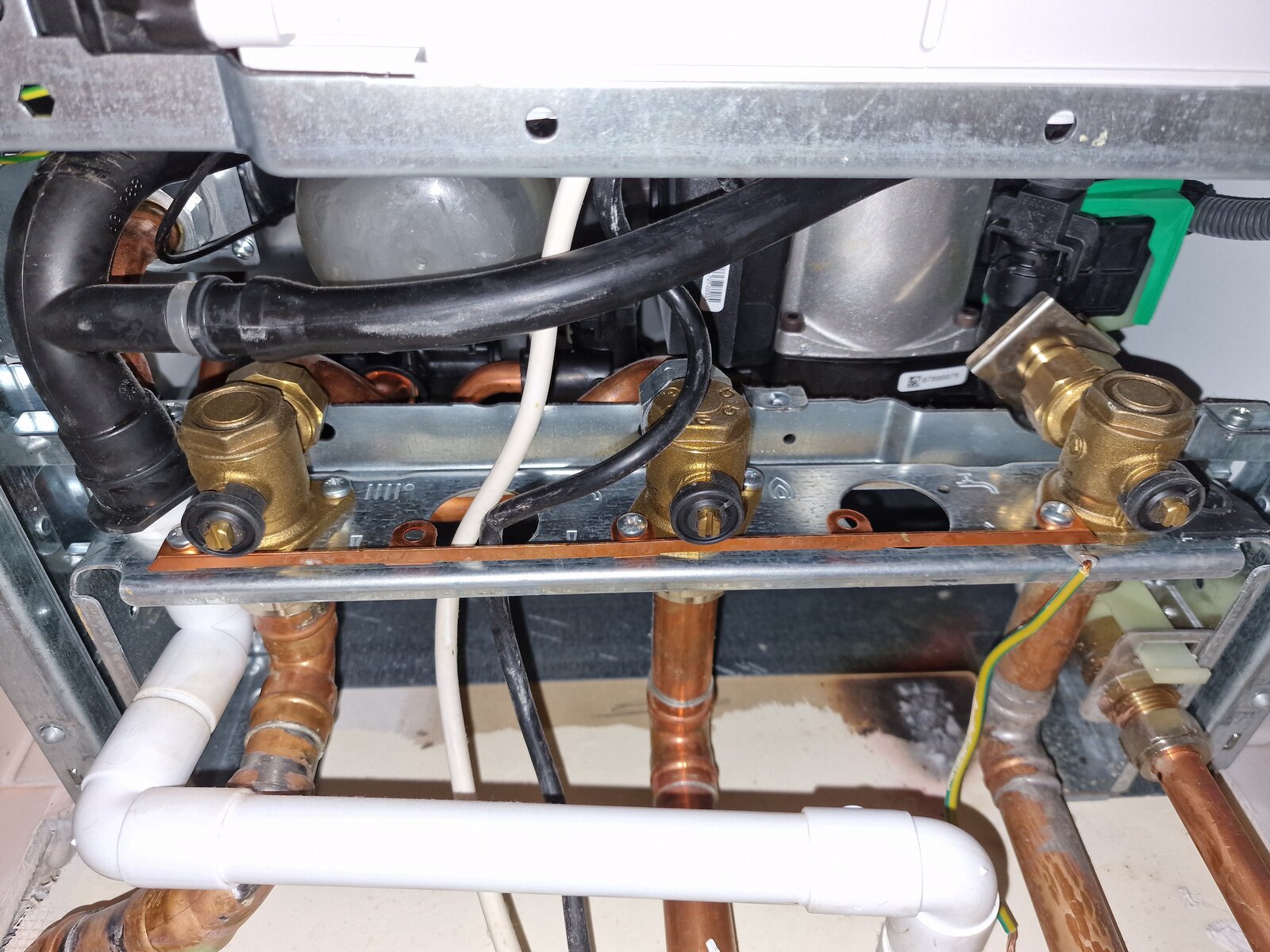

The pressure is down below 1 and in the red. I have looked extensively and can't see anywhere on the system to repressurise. (I'll attach pics separetely)

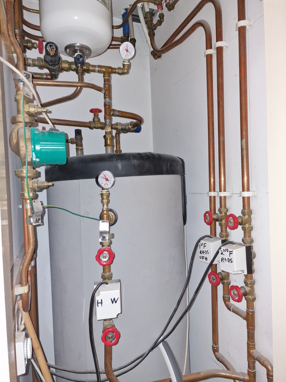

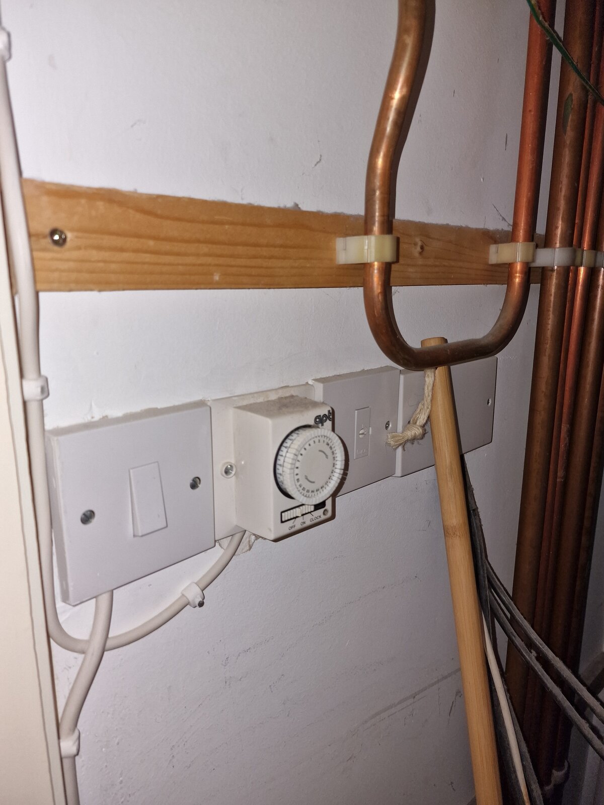

We also have a smartline hot water cylinder (pic attached). Is the gas supposed to heat this or is it more of an immersion system? Had the switch beside the clock turned on for a while and we had loads of hot water, however looking at gas and electric meters, we've spent a fortune.

Your boiler heats the hot water cylinder ,and there is likely an electric immersion heater in the cylinder as a back up ,but I can't see it in your pic.
The filling loop often looks like a silver ,braided ,flexible hose. And it's not visible in your pics.
I don't seem to have the filling loop to attach the key to unfortunately.
Like this? So if I allow some water to flow, it should increase the pressure on the boiler?
That's your filling loop. Black plastic handles on both ends ,1/4 turn on both opens the filling loop and allows water into the system to increase pressure. When upto around 1.4 bar ,close both back to original positons
Sorted.. thanks for this.
There’s usually a pressure gauge on the pipework too, the one uppermost in that photo could be the one
