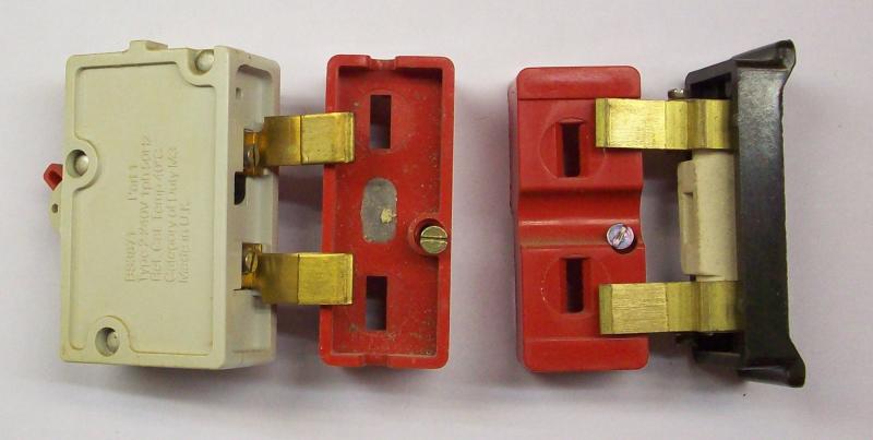

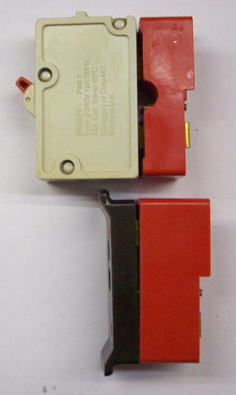

If you mean a plug-in mcb, then no.
As AndyPRK said, that is not correct. As for your subsequent 'Why', there are two reasons. Firstly the pin spacing of the plug-in MCBs is different from that of the fuse carriers. Secondly, the 'holder' for the fuse carrier is much 'deeper', and would hold a plug-in MCB so far out that its pins would not reach the contacts even if they did have the right spacing to go through the holes.
If you don't believe me, I can take some photos!
Kind Regards, John
... there are two reasons. Firstly the pin spacing of the plug-in MCBs is different from that of the fuse carriers. Secondly, the 'holder' for the fuse carrier is much 'deeper', and would hold a plug-in MCB so far out that its pins would not reach the contacts even if they did have the right spacing to go through the holes.
In anticipation of non-believers, I took the photos (not very well, in haste), anyway:
Kind Regards, John
