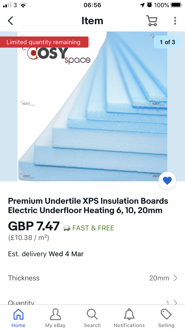

I can’t quite decide if this is a good idea. I’ve laid a 125mm thick concrete slab for the hot tub and was thinking to put Celotex under it to retain the heat. I e-mailed them and they said it wasn’t suitable and to use something with a higher compressive strength.
Now I’m thinking 20mm of this but not sure if the numbers add up:
And the spec:
There will also be plastic grass between the tub and insulation but if it would be better I could cut that around it.
Any advice would be much appreciated.

I don’t understand those figures either so I googled the difference between EPS and XPS and there doesn’t seem to be much.
I’m going to give it a try and if it fails for whatever reason I can always get rid of it or swap it for something else.
How much does the hot tub weigh, and over what area is that weight distributed?
As an example, if it has a flat bottom, then tonne over 1 sq metre applies an even pressure of 10 kPa. Compare with the quoted 300 kPa for 10% compression of that XPS board.
On the other hand if it puts all the weight on four feet each of 5cm x 5cm, that’s 1000 kPa under those feet.
It’s spread through a flat bottom that measures 2.1x2.1mtrs. It weighs 300kg dry but must hold at least a ton of water, I’m not sure of the exact volume.
Thanks endecotp (y)
Does the 300kpa mean that the 1595kg could sit on as little as 53sq/cm?
