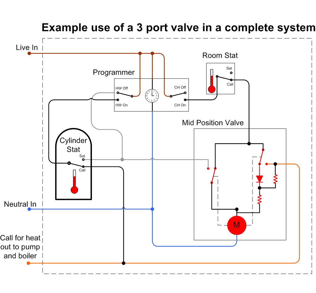

Afternoon all.
I have recently come across an apparent "downside" of Y-Plan heating systems, whereby the valve can be held in position, even when no heating or hot water is required.
In my ignorance, I have never noticed this, despite having lived in my house for well over ten years.
I realise that the motors are designed to handle the heat and the electricity to hold the valve, other than in the B position, is insignificant.
However, I was just wondering when does this happen and how can I recreate it?
The valve will stay in its last position when the programmer/stat is switched off however if both HW and CH are running and the valve is in the mid position and shut off together the valve will spring return to HW only. If only the CH is running the valve will stay powered and remain in the CH position, as it is kept powered from the HW off connection of the programmer.
To recreate, switch on CH only until boiler fires, then turn CH off. The valve will remain powered until HW is switched on.

In the summer if the central heating isn't being used then the valve will sit permanently unpowered in the hot water only position.

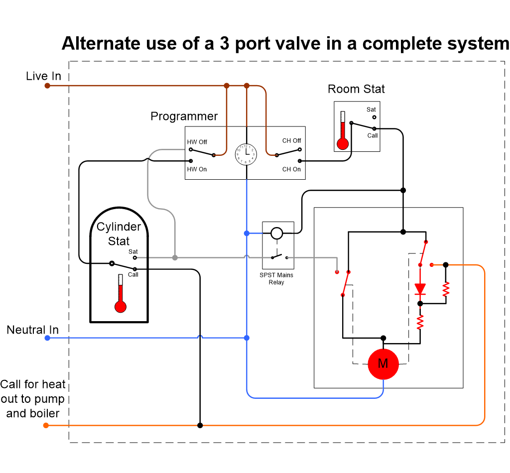

One might think that it will remain unpowered at least overnight by programming the HW only on for a few minutes last thing at night but this will only work if the cylinder stat is also calling for cylinder heating. Attached is a modification that ensures it will only be powered when CH only (or CH+HW) is calling, the Unmodified schematic is also attached.

That modification would certainly increase the life of the synchron motor as well as save some electric.

It may not require science to wire it but it does require a reasonably good knowledge of how this truly ingenious device works, especially when trouble shooting it. It requires both the programmer "HW OFF" contacts and the cylinder "Satisfied Contacts" to supply 230V otherwise the valve will never move to the CH only position, the HW OFF contacts are required if CH only is required and the cylinder Satisfied contacts are required if both CH&HW are requested but the cylinder stat is satisfied, the mid position is achieved by changing AC to DC and using this as a electric pair of brake shoes as like poles attract, then, to avoid the motor poles becoming permanently magnetized a very small de magnetizing AC current is supplied with CH only on. Maybe just a small touch of electrical (rocket?) science.
I did exactly this and the valve did indeed stay in the A position. I cannot believe that I had not noticed this before - my central heating (in the winter) will always go off after my boiler, so I will have had this position every night for weeks on end.
I can now completely see why this approach will not work, now.
That extra relay hack is really very clever and something I might now do. Is this something that could theoretically be done or do many add this to their Y Plan in practice?
