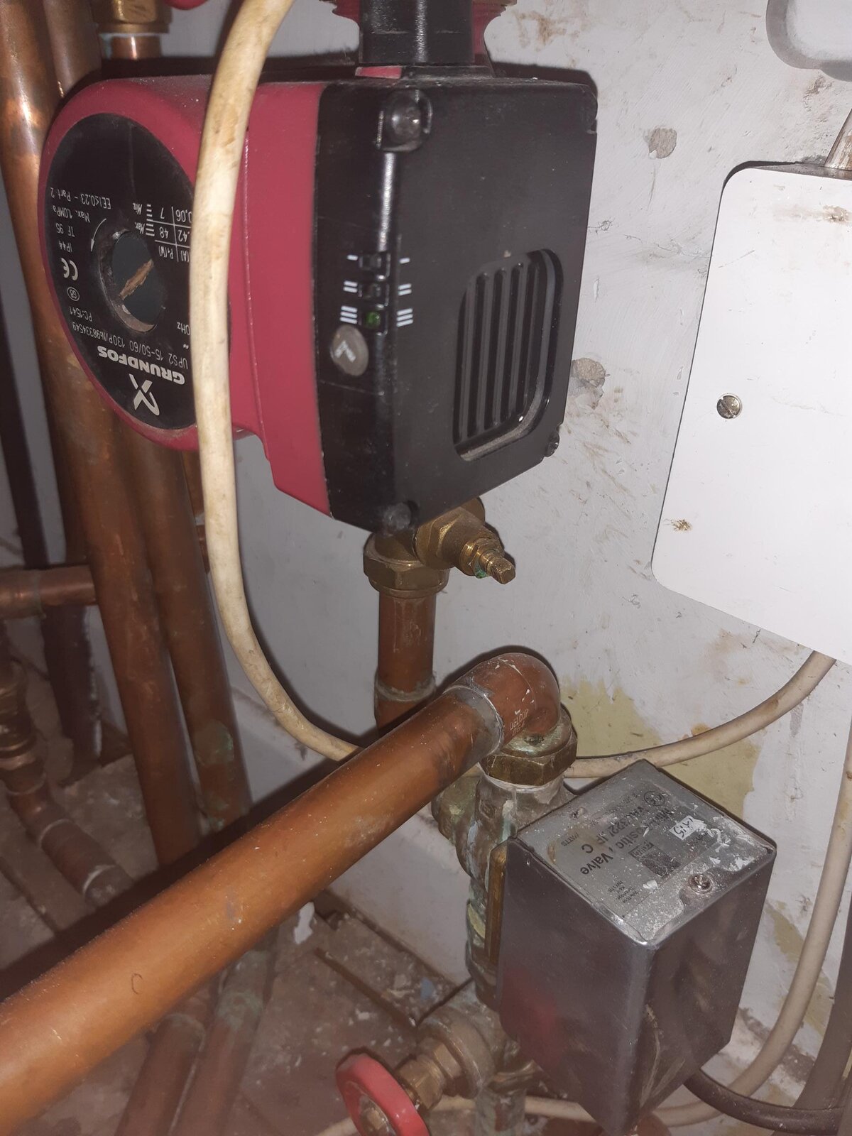

I have a Y Plan heating system and there is a "boom" during the hot water schedule when the heating side calls for heat. My understanding is that this is caused by the pressure of water against the valve when the pump initially starts up.
My question is, what is the best way to overcome this?
