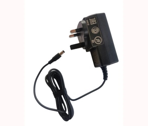

If it has batteries in the bell box they might last a couple of years, but you may possibly have a transformer supplying it from the mains. This can be unplugged, and the bell will (should) stop after 20 minutes. The systems I have experienced have wireless sensors, sending to a control box, and the control box turns the siren on. So if you disable the control panel, it will stop.

Power supply may look something like this. The old ones were white.
