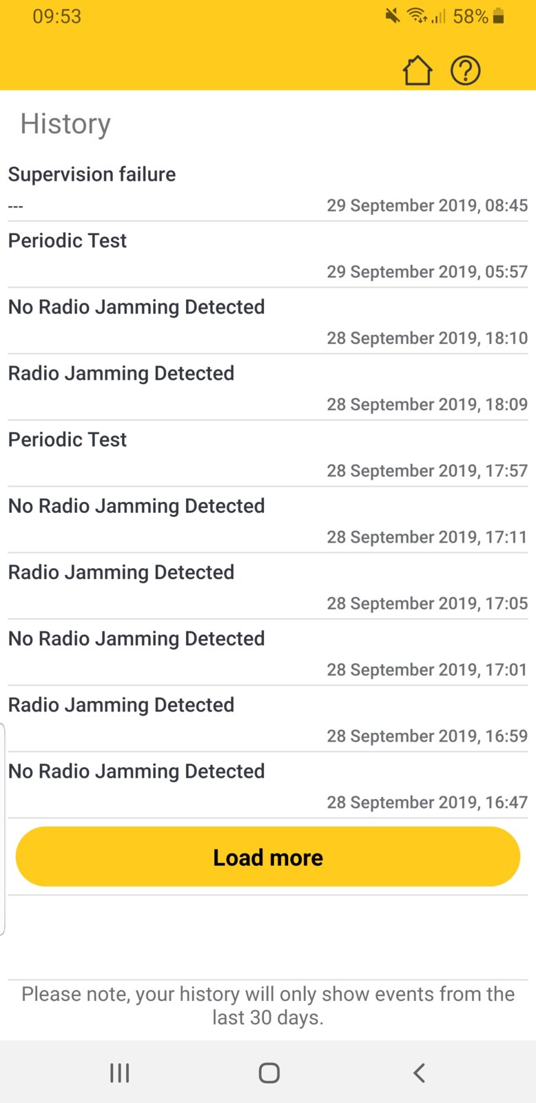

I installed one of these last year as it seemed a simple fit and forget. The alarm is not great. It needs a lot of attention. Constant errors about jamming and supervision. Tamper alerts. Battery in the pirs does not last that long. Am I best to sack this off and get a wired texecom? Does anyone else have a yale smart series. Any issues?
That's interesting. You're getting several short-term instances a day.
Your alarm isn't near the wifi, and you've turned off your baby alarm, remote-control car, cordless doorbell and so on? And you aren't using an electric drill, spot welder or anything? Motorcycle with no suppressor? How about your next-door neighbor?
Jamming from 17:05 to 17:11 means for 6 minutes your alarm would be un-likely to activate if there was an intrusion.
