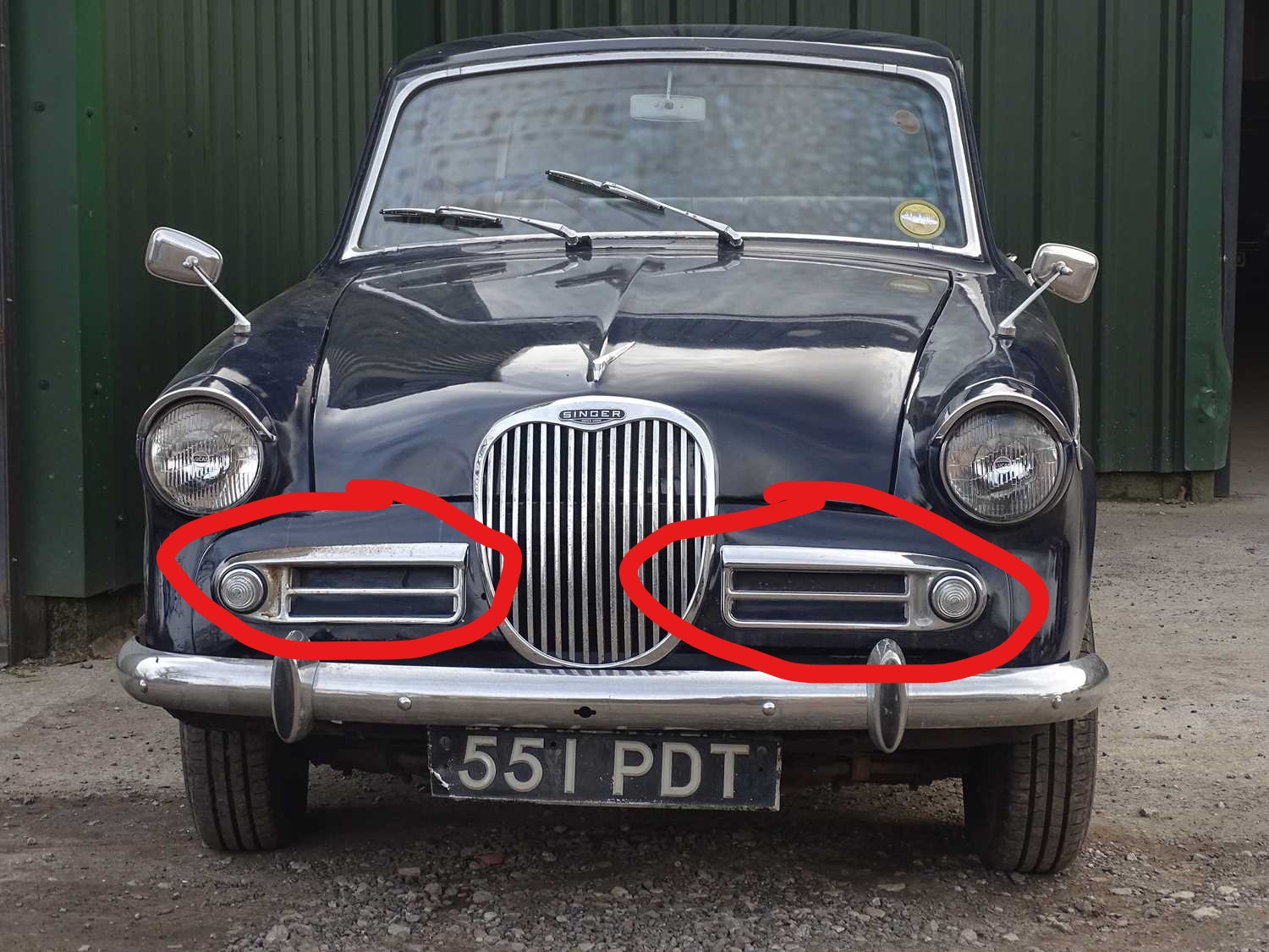

I need to get a few pieces from my car re-chromed and they're made from Zamak. It's just two grilles and a boot ornament.
There's one place in Derby but they are incredibly expensive. I may have to end up going there, but before I do I was wondering if anybody had any experience of a firm who do this. I couldn't find one in Nottingham (I'm trying to stick local).
Parts aren't huge (maybe 12"-14" in length and no more than 8" in height.

£450 for these and a number plate surround! That might be good, so I'll get saving

Yes I'm a big fan of Rootes cars (mine is Lake Blue with the Sea Foam White flashing -- pics above just for reference). I used to have a couple of Super Minx, too.
