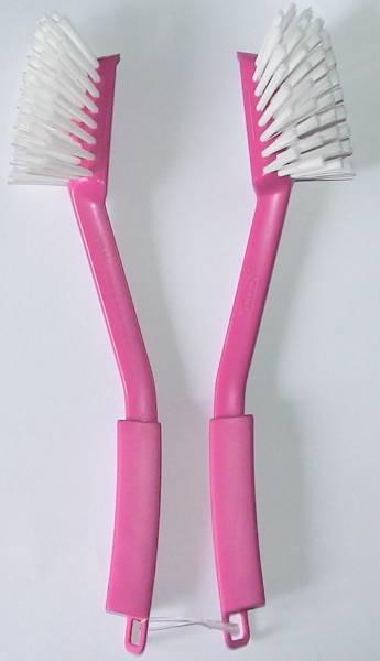

Anyone agree or disagree to using cocktail sticks to poke into the nozzles above the powder/conditioner tray to aid cleaning? I don't know what's in the water feed system above to know if this is likely to damage anything.
Mike
cup brush or bottle brush will be better.
I've used an old tooth brush before (when the trouble first started) but that didn't get into the nozzles enough (i'm presuming). I think that a cup brush or bottle brush would have similar results, or is it how i use it that's a problem? Not sure. Advice appreciated.
Mike
its bigger for starters its like a tooth brush but 20 times bigger it will get into the little holes no prob.
Ah, I see. I guess i'd call that a washing up brush, but then it's only a name i've given it as I don't know what it's really called.
