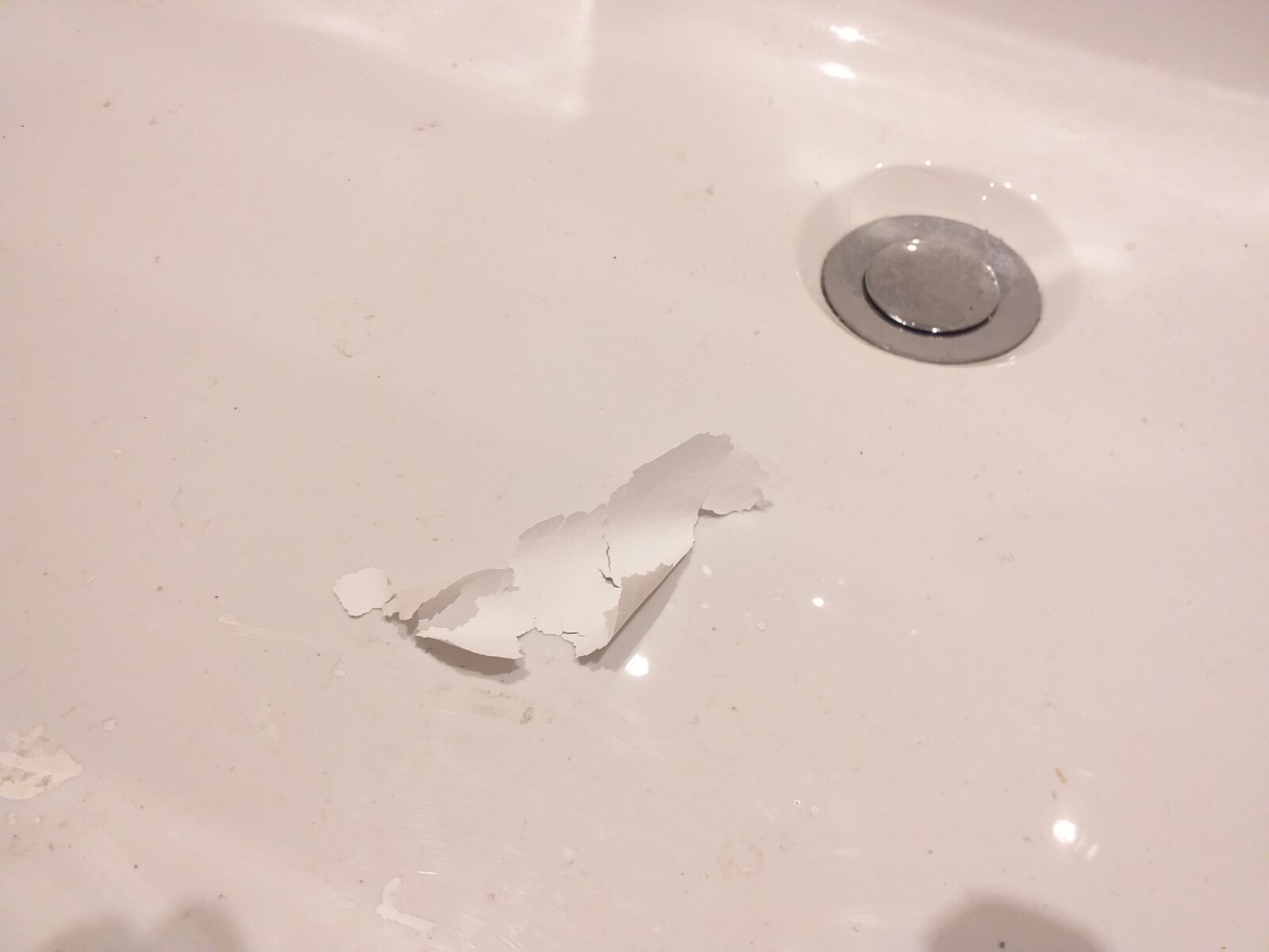

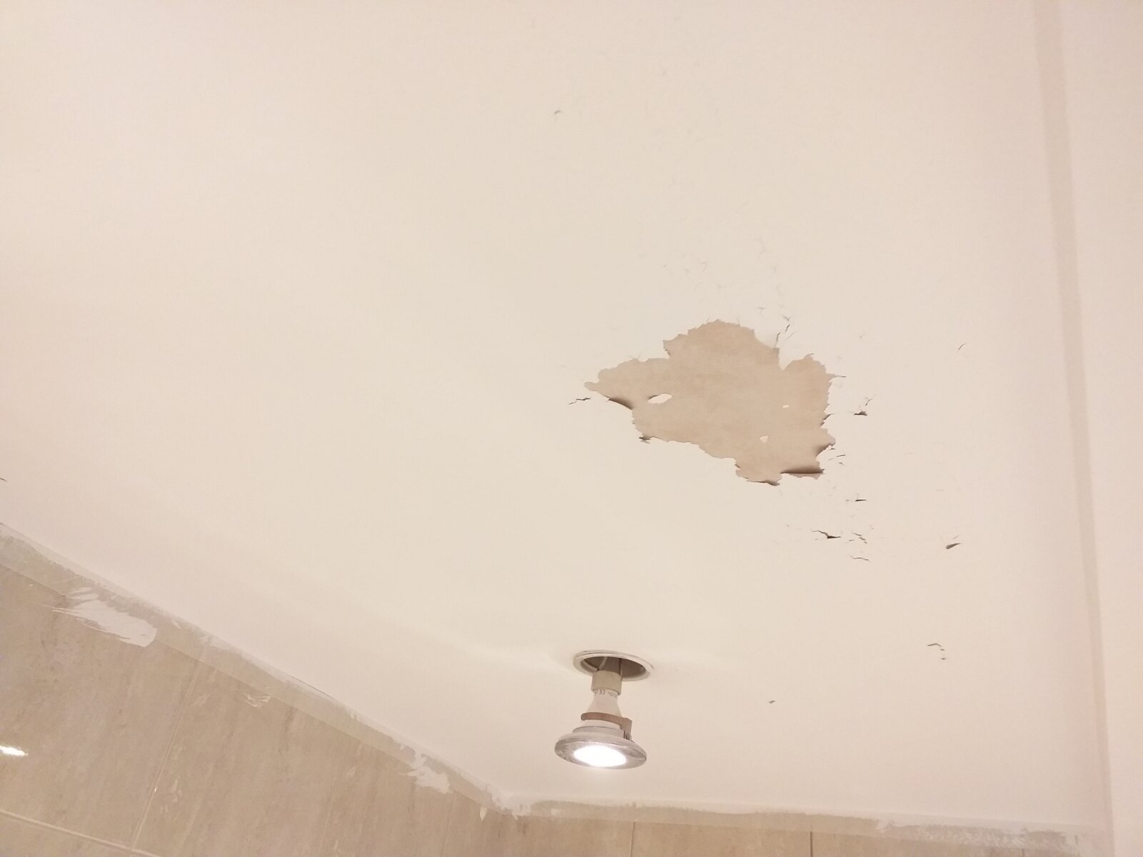

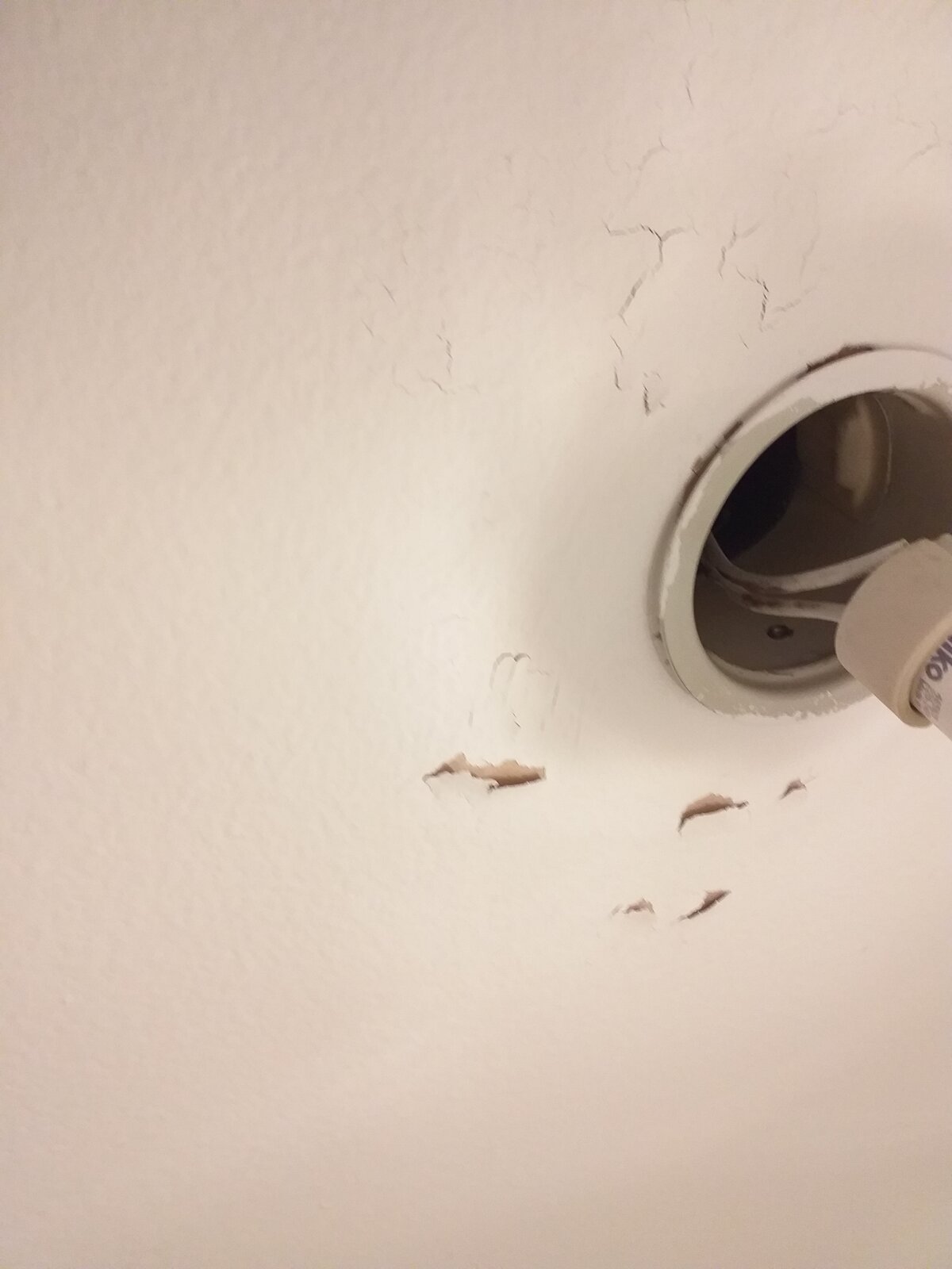

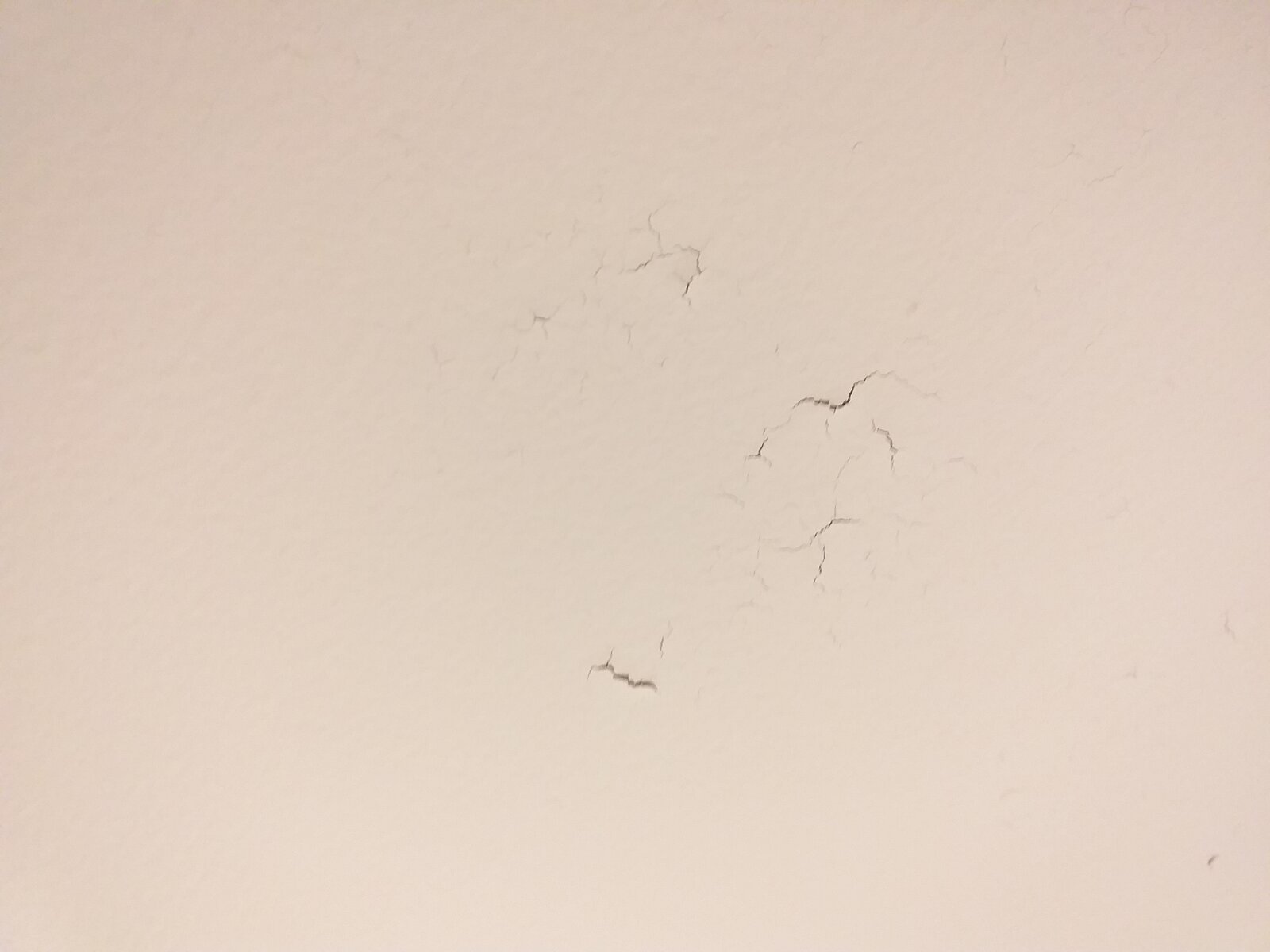

Just bought a house and redecorating before moving in. The bathroom ceiling seems newly plastered, and I wanted to paint it over before starting to use the bathroom. Started off alright with skimming polyfilla over some minor holes and wiping down the ceiling with a damp sponge. Next day, painted on a coat of Zinsser Ceiling Pro 5-in-1. Within the hour, part of it had started cracking. Next day, large blotches of in one part have peeled off and/or cracked. This is all in the same area, and 2/3 of the ceiling are alright. I tried painting over again and got the same result. What is going on? There should be almost no moisture in the ceiling.
How can I make the thing stick? Skim with polyfilla then sand and paint again? Sand, then skim, then sand, then paint? Or...???
Edit: photos uploaded:

I can't say what has happened although it's not a product I'd use as the application data sheet has no mention of plaster.
It says all surfaces though but I myself would phone the help line first if I wanted to use it.
I'd of given the ceiling a coat of gardz or other primer like acrylic primer undercoat to seal then the 5 in 1 Pro to be sure.

No, never put pva on a surface you're planning to paint. Was the ceiling mist coated first? I'd give the problem area a light sand, then mist coat and repaint.
No, it wasn't. The Zinsser ceiling was supposed to be the primer, so I didn't assume it needed to be primed/mist coated before (by 'mist coat' you mean using the final paint in a thinned consistency, right?).
Yes that's right; I always do one on bare plaster/filler. I'd not use your fancy paint though - just some super cheap emulsion watered down.
