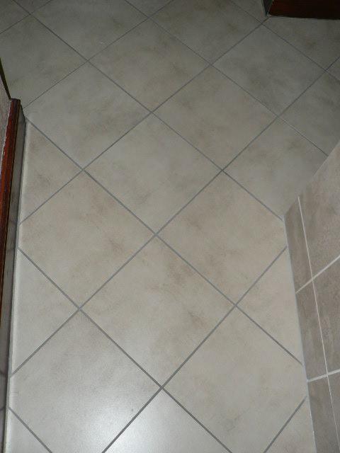

Yeah, 4 or 5mm spacers for the floor are ideal for tiles that size. This is my bathroom floor done a couple of weeks ago with the same size tiles and 4mm spacers.
You forgot to mention pub breaks to relieve the stress of diagonal tiling
:wink:
You forgot to mention pub breaks to relieve the stress of diagonal tiling :wink:
You're not wrong. The worst bit is that I can't make the cuts with my Rubi cutter because the breaker is fixed at the top. Meant that every cut was with the angle grinder and meant a trip down and back up the stairs. :roll:
