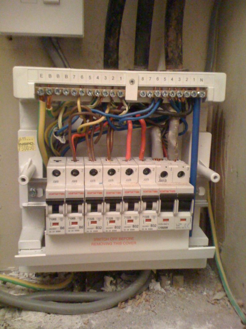

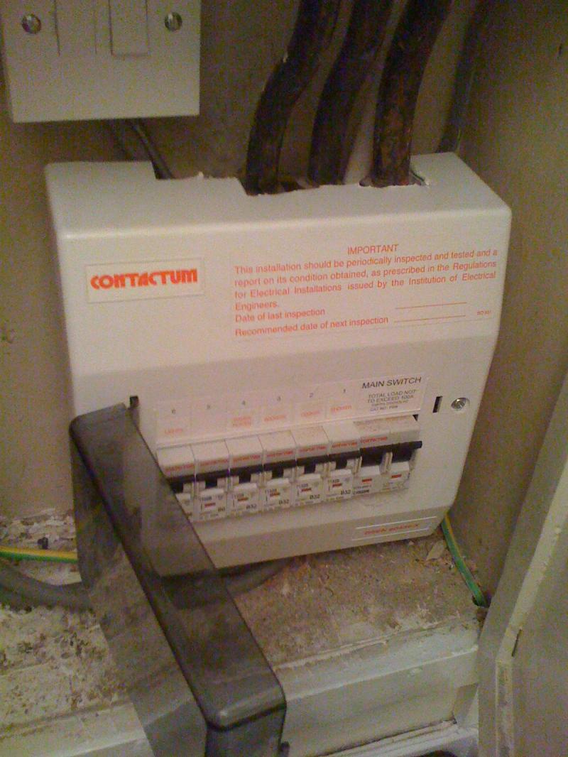

Doing a bit of tidying up in my new flat I have noticed that the new consumer unit has been installed in a strange manner. Flat was rewired completely a couple of years ago apparently (mixture of old and new colours says otherwise...).

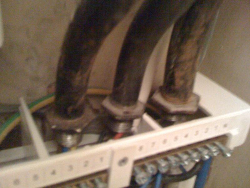

The original steel conduit (entire flat is wired in conduit) has been left as-is and the plastic casing of the CU has been hacked to accommodate. This leaves the conduit un-earthed, and although it is not used as the earth, this doesn't seem right to me.
Should I do anything about this? Only solutions I can think of are to use pipe bonding clamps or piranha nuts on the threads, however I think it is imperial conduit (built in the 60's)
Oh and the 2.5mm water heater feed on a 32A breaker is on my to-do list!

That's a shocker of an install and I would recommend getting a full periodic inspection report done by a reputable firm/electrician asap.
Unfortunately the likes of that is all too common but clearly not done by anyone who knows or cares about the quality of their work, and with no regard to current regulations (or those in force when the 'full re-wire' was done).
As part of the remedial work I would recommend earthing the conduit.

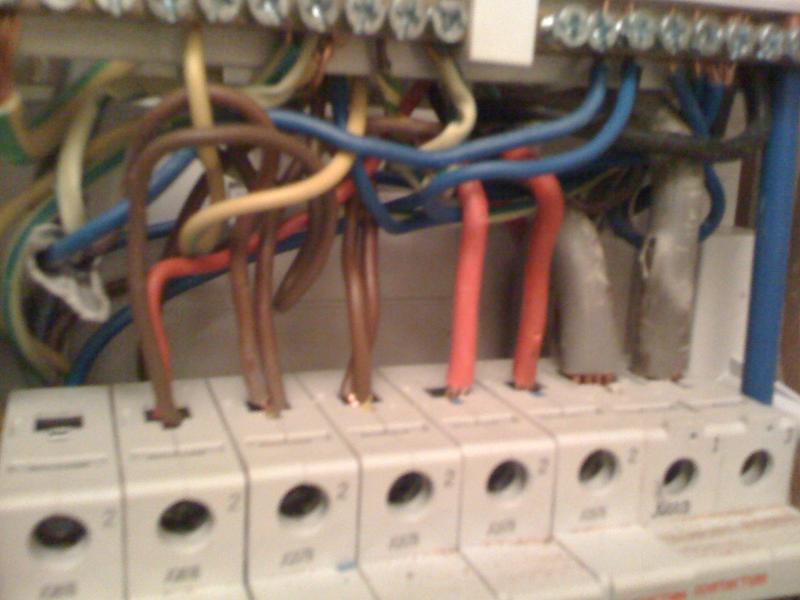

Sheer mess, badly mangled sheath, lots of copper on show..

Other things - looks very untidy, damage to sheath of incoming tails, not seeing proper labels, looks like sockets not on RCD, possibly other circuits which should be not on RCD, big holes in the top as you mentioned, general warning bells going off backed up by your comment about recessed surface boxes elsewhere etc. In that nick the chances of it having been properly tested are remote I would want to be checking the continuity, insulation resistance and earth loop impedance . . .
Piranah nuts won't work. As pointed out above, you would have to rethread the conduit ends as the thread will be diferent.

Better to shorten the conduit, re-terminate it properly in an earthed metal adaptable box containing, if necessary, joints to new cables running the last few cm to the CU, or with plastic conduit glanded to it to contain the existing singles.

Apalling work.
If fitting a metal box above the cu to join the conduits was impractical then a metal-clad consumer unit could easily have been used.
Holes in top of cu are way too big, IP whatever it is...
Tails hacked to bits.
Nearby switched fused spur looks like it hasn't been fitted with correct box.
Surely something there requires RCD protection...?
