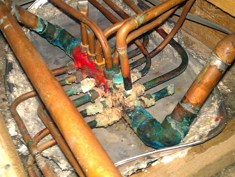

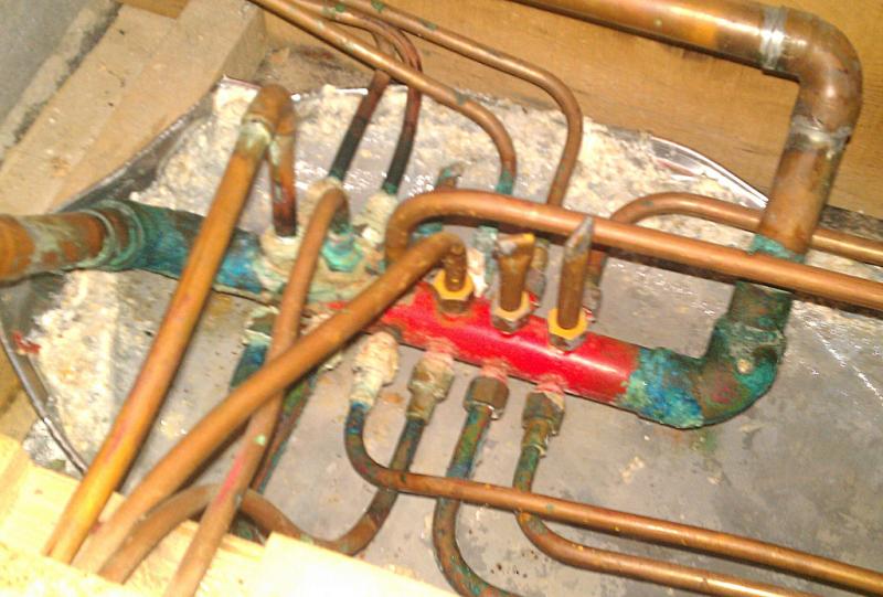

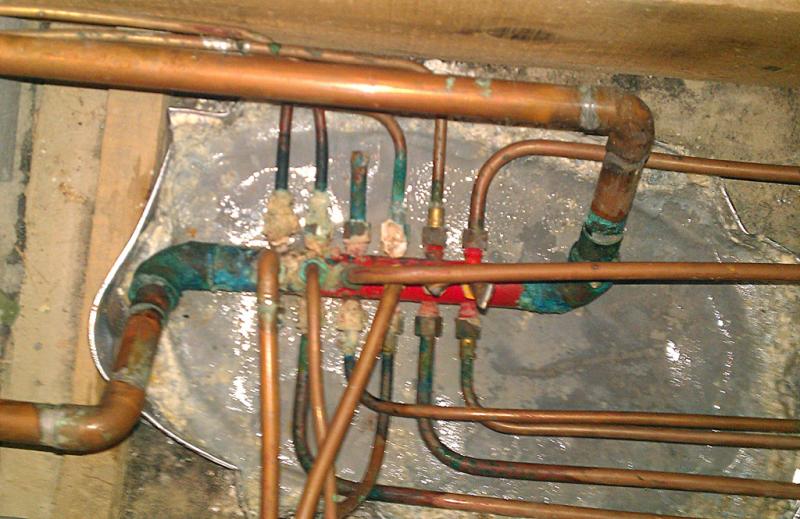

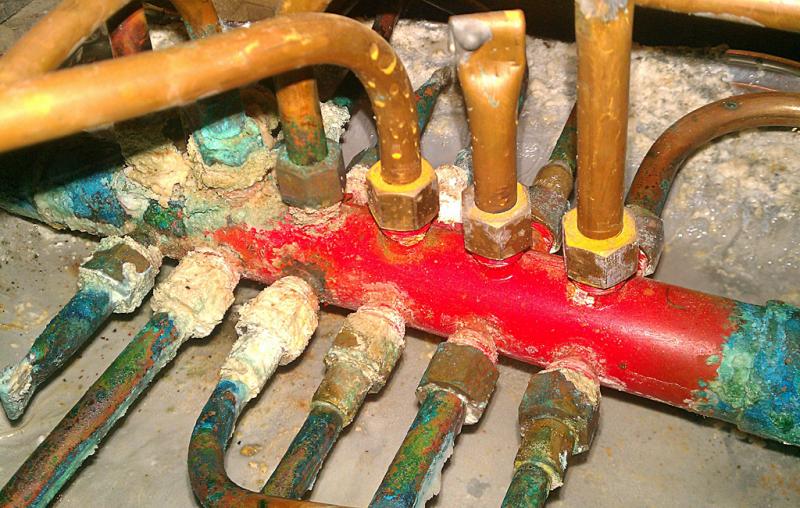

Any assistance is welcome in identifying this old leaky manifold!
It's given good service and I would like to replace it with an identical model if possible...
Are there any reliable sources for new or refurbished components like this?
Thanks in anticipation

You know why the tray under it has failed :?: Cuz it`s ali and it`s touching the copper - it`s a sacrificial anode :LOL: . Replace the tray with a plastic one - dose the system with a leak sealer - Screw down the floor -save yourself £100 Simples :mrgreen:
It looks as if it is leaking at the compression fittings on the microbore. They may respond to tightening with [I think] a 16mm spanner, or it may be disastrous! The inner ones are difficult to access, you may find a cutaway or skeleton ring spanner with do it. The green stuff on the solder 22mm fittings is just flux residue from careless workmanship.
This was a normal micobore manifold with a stop in the centre to separate the flow and return. I think it is a Yorkshire product, but it's about 25 years since I fitted one.
