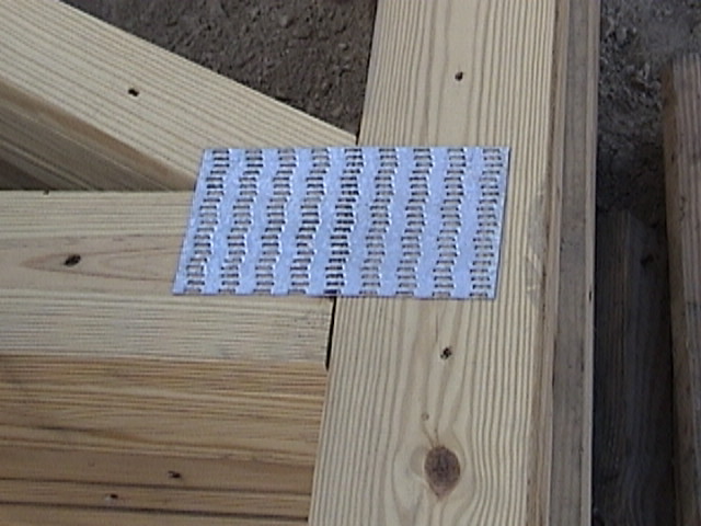

Hi,
I am wanting to make my loft hatch wider as it is barely biug enough to get through. The red dotted line shows where i would like the hatch size to be if possible. The beams going from left to right i think are 6x3. Can anyone give me some avice on the best way to go about doing this?
Shot at 2007-07-18
Is your roof gang nailed trusses?
No it is not like that. The roof has like a H in 2 place's holding the hipped roof.( if that makes any sense).
If it is a traditional roof, not gang nail roof trusses, the you can make the hatch larger by cutting back and inserting trimmers.
This site http://www.loftshop.co.uk/lofty_ideas2.asp might give you some ideas on how to go about it.
Support the trimmers using joist hangers like these
I'm assuming where the double ceiling joists is resting on the bearing wall? The trimmer is the joist across the ceiling joists that you're going to put in, best to make a double joist trimmer on both side unless one of them is resting on the wall
Still confused with this. The joists that run along side each other that i need to cut are not on a wall. :confused:
Can you do a photo, on your drawing the joist in opposite direction, are they ceiling binder, another word the whole length?
I will check this later today when i get a spare 5 mins and will try and get some photo's.
The rafters are 3x2 and the beam going across is 4x2. I have managed to take the following pics if they are not clear then let me know and i will try and explain which is which part in relation to the hatch..
