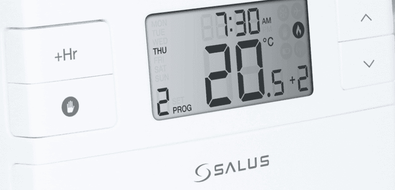

1. Thermostat Screen is Blank or Won’t Turn On
If your thermostat screen is blank and doesn’t respond after changing the batteries, try the following:
- Use quality alkaline batteries like Duracell – avoid cheap zinc ones.
- Make sure the polarity is correct (plus and minus the right way round).
- Don’t press buttons while inserting the batteries.
- If the screen remains blank, remove the batteries for at least 30 minutes before reinserting them.
- Try pressing the small reset button (usually located in a pinhole on the thermostat case).
If it still doesn’t power up, chances are the thermostat has failed and will require replacement.

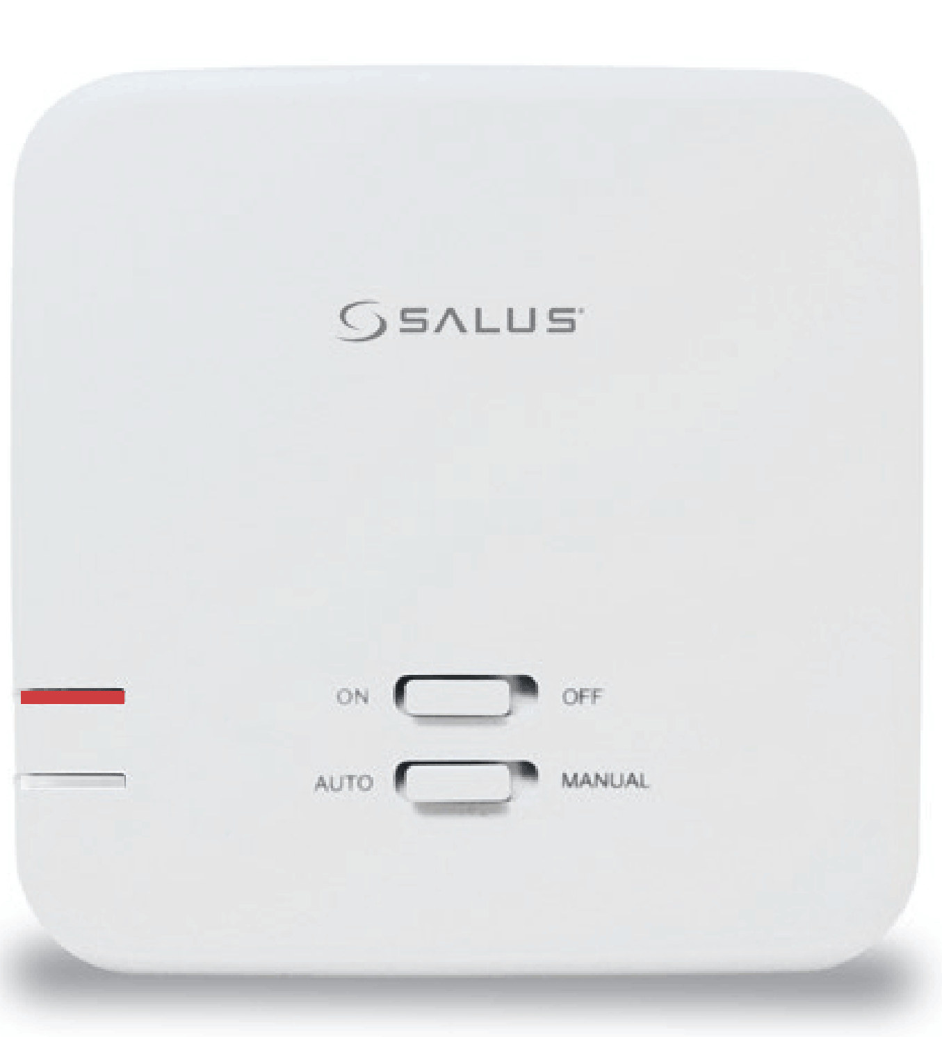

3. Heating On Thermostat but Radiators Cold
In cases where the flame icon shows on the thermostat, but the boiler doesn’t fire:
- Check the receiver – the red light means it’s powered, the green light means it’s receiving a signal.
- If the green light isn’t coming on, it’s likely a communication issue.
- If the green light is on but the boiler doesn’t respond, the relay inside the receiver may have failed.
- Try switching the receiver to ‘manual’ – this should force the heating on.
If that works, then it means the thermostat isn’t communicating properly with the receiver. If that’s the case, then you can try re-pairring the thermostat and the receiver together. If this still doesn’t resolve the issues, then it may be time to consider replacing the receiver or possibly the entire system (receiver and thermostat).
4. Red Light Flashing on Salus Receiver
A flashing red light on the receiver indicates that the receiver hasn’t heard from the thermostat for over an hour. This can be caused by:
- The batteries in the thermostat are weak and need replacing
- Interference from nearby devices (Wi-Fi routers, smart doorbells)
- Signal range problems (especially if the thermostat is far from the receiver or behind thick walls)
Move the thermostat closer to the receiver. If the red flashing stops and the green light appears, then the problem is most likely interference with the signal, or the range between the thermostat and the receiver is too far.
If that is the case, then you need to relocate the thermostat closer to the receiver or if interference continues then, if possible, change the RF address (refer to the manual for instructions on how to change the RF address).
