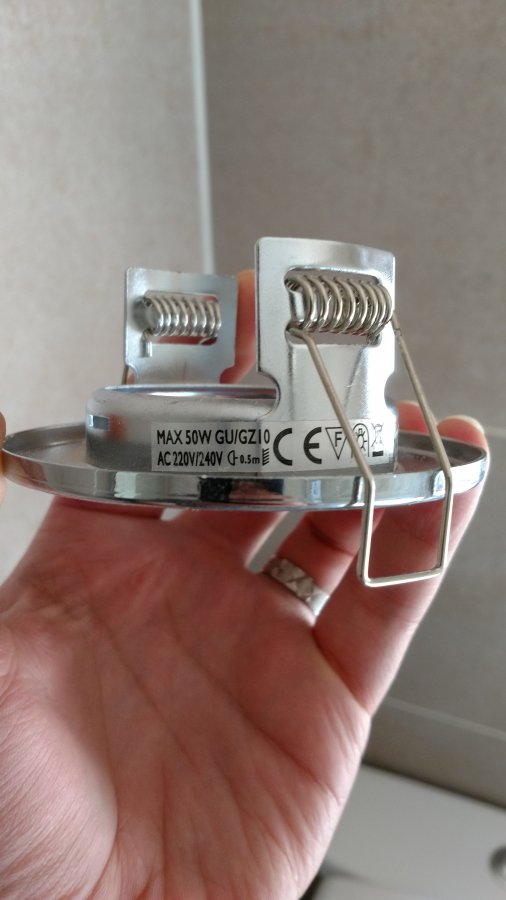

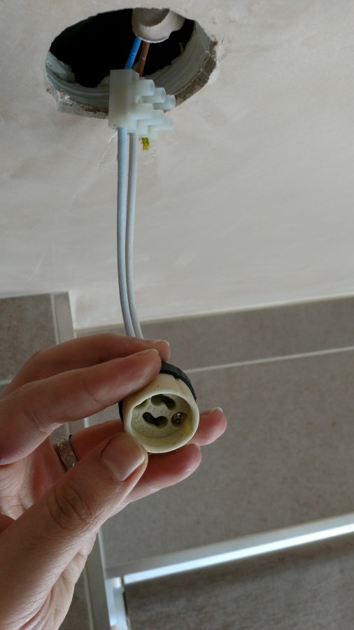

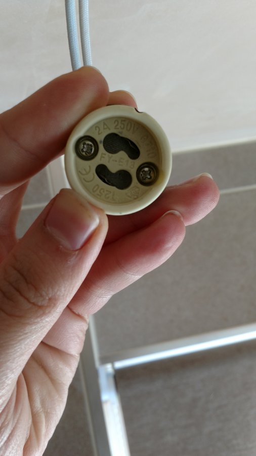

Is this new wiring safe?

The bulbs are 7w LED running off of mains voltage so shouldn't generate much heat, is a cap required in that case?
Frodo, sorry for my ignorance, but what's the relevance of that? Is it ok?
The main point is that the earth should be retained up to the mains voltage light, regardless of if they need it, you seem to say only L and N were taken to the connecter.
This was approached in earlier posts addressing the issue of whether the lights were Double insulated.
Either mains or 12 volt the wire blocks should be in an enclosure, preferably the one supplied with the fittings.
The fittings are a poor choice, nowadays there are better fittings that make it easier to reinstate the insulation to Please Building Regs.
C types are not generally used in domestic properties, certainly not unless the EFLI satisfies.
C types have a maximum EFLI half that of B types for comparable current values.
Eg, if a B type 10A breaker is 3.68 Ohms, a C type 10A is 1.84 Ohms.

So just had a conversation with the electrician.
There was apparently some miscommunication. He thought his brother and enclosed all the connections and vice versa (there were two of them). They'll come out to sort it, and also tidy up the wiring.
