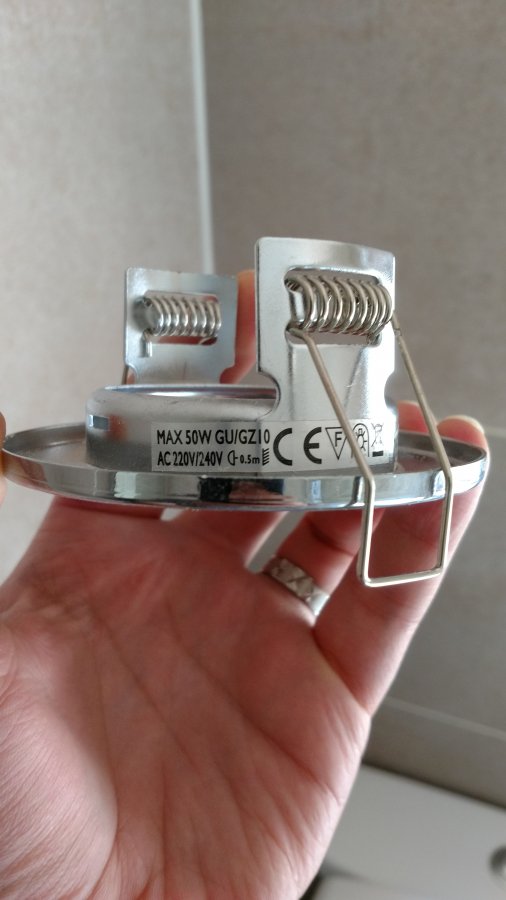

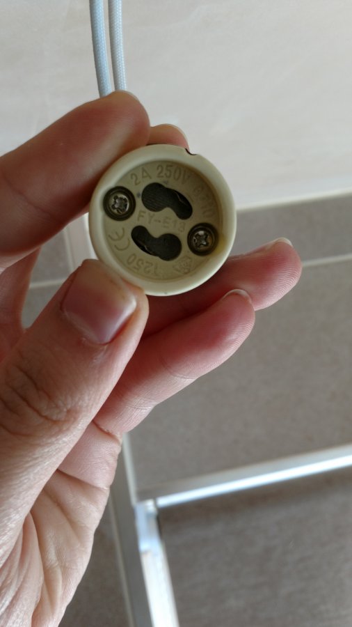

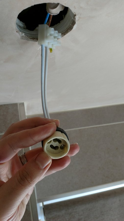

Had a look at the spotlights this morning and they don't appear to have any double insulated symbol. Here's some pictures. Are these ok?
Usually, with that kind of fitting, there is a metal arm that attaches to the recessed fitting to allow the terminal block to be fixed and enclosed. The terminal block is a 3 way one, not sure if this was supplied by the manufacturer, but there is normally provision to park an earth wire, even if the fitting does not require one. Incidentally, there is nothing on the fitting to say either way.
The regs demand an earth connection at every wiring point, even if not utilised. Terminal blocks, both LV and ELV should be enclosed.
Edited for clarity.
May I ask why please
C types are not generally used in domestic properties, certainly not unless the EFLI satisfies.
C types have a maximum EFLI half that of B types for comparable current values.
Eg, if a B type 10A breaker is 3.68 Ohms, a C type 10A is 1.84 Ohms.
Just picked up some chocboxes to remedy the terminal blocks being exposed so can sort that at least. Still not sure about the earth situation. Could it be it's not an issue since the light surrounds aren't actually part of the electrics?
It could be.
Even when these types of light do have an earth connection, it is only on the metal bracket - with only a tenuous connection to the rest of it by means of the spring coil into which the bracket clips.
