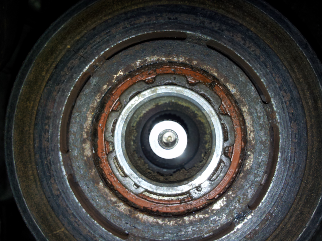

I did think it was quieter when I charged up the refrigerant a couple of years back. That was probably psychological. I have identified the problem now. The compressor bearing was very well worn. That needs to be changed. I got to it but I don't have a 90 degree circlip plier to get further.

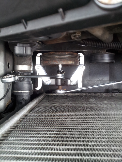

Tricks discovered through thrashing around:
1. grip clutch plate using plastic-rubber jar opener to undo central bolt
2. plastic hammer on seized clutch plate + WD40 in central bolt hole (the splines could be lubed via the hole )+ lots of patience and hammering dislodged the plate eventually
Although a dedicated puller tool was available to buy at an OK price, I thought I'd try an improvisation with a couple of 3 jaw pullers and various bits and bobs. There was no room to apply force and I had to fight every millimetre of it. In the end I resorted to using a wide chisel as a pry bar. I prevailed. The bearing was an NSK 35BD5222DUM18A, The compressor was a denso unit, model unknown.
Extraction of the bearing by pressing was impossible using a mini bench vice. Probably the handle too short. It was easily pulled out using a lead screw and some large washers.

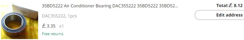

This is my first foray into china precision bearings. I am hopeful it will be fine. If not, DIY instructions are on the internet! Bearing dimension is 35x52x22.
