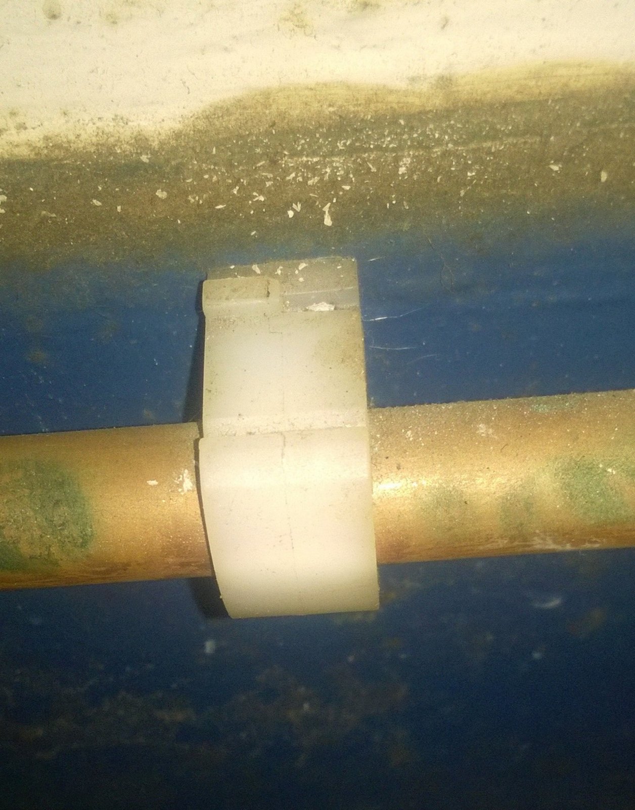

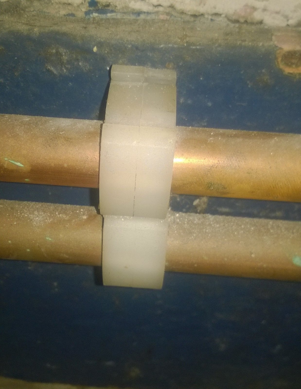

I am not a plumber or heating engineer I want to remove a skirting so I can line the walls with wood.
Unfortunately when the central heating was put in this room the engineer decided to screw the pipes to the skirting instead of under the floor.
I need to remove the clips so I can remove the skirting and get behind the pipes. I can then fit my panels and refit brass clips to hold the pipe. At least make them look slightly better than plastic
The problem is the clips. All I do is break the clip with a bradle between pipe and the front of the clip and unscrew the clips from the wall. But still cannot remove it as it is tight between walls and pipe. before going under the floor or into the radiator which obviously cannot be moved without a lot of work
Am I missing some easy way of doing it or what can I do? I have about ten clips to remove and replace.

OP: you'll be in the same situation when it comes to resecuring the pipes back with brass Munson rings!
You need to...
Isolate rad by closing valves
Drain rad
Uncouple pipes from rad
Pull pipes away from wall and clips
Do your thing
Reverse above to reinstate
Otherwise you'll be between 2 fixed points all the way :)
I was hoping I would not have to do that but it seems like the only way. I was thinking I could slice through the clips behind the pipe, separate the two parts and pull them out that way. I was hoping someone had a "trick of the trade" that might work before I tried anything
If you have a multi tool you could cut the screws behind the pipe, plastic in situ. Once skirting removed will that allow enough room for the wood you want to attach to the walls.
Also thinking if it’s that tight easier and quicker to drain down and remove radiator
Regards david
As others have said... multitool to get them off but how're you gonna get replacement clips back in?
It's a simple task to drain and remove the rad... that way you can also clad behind the rad!
