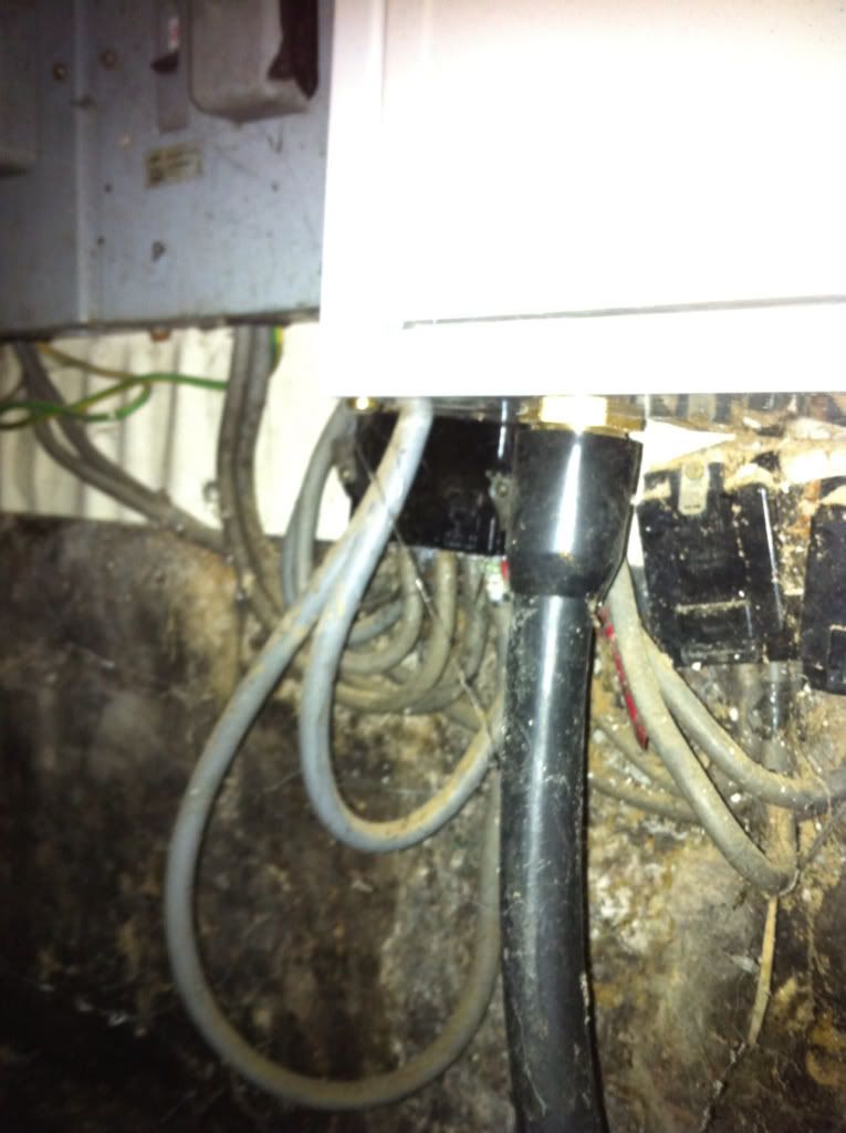

Spot the fault...

I got lost in all that so I don't know if we're still guessing. Is it two tails going through different holes in a metal box?
I thought of that one, but rather discounted it because, if that were the case (and goodness knows how RF could have expected us to see this from his photo, anyway!) I would have expected the thermal image to show a hot part of the bottom of the box - which i don't think it does.

The warm tails prompted me to have a bit more of a thorough look, and I found another three henley blocks tucked away under the proteus board. This is in a chilled cellar kept at a constant 14°C
I know this pic is even worse than the first one, but the insulation has completely burnt away from the tail for about the first 25mm after one of the henleys.
Come on now, we haven't got 3D photos on the board yet - how were we supposed to see those in the first picture :rolleyes:
EDIT: Does show the value of thermal imaging though.
True, but if that lot really was at 80°C or so, then I might have expected the old fashioned techniques (touch and smell) to have identified the location of the problem!
