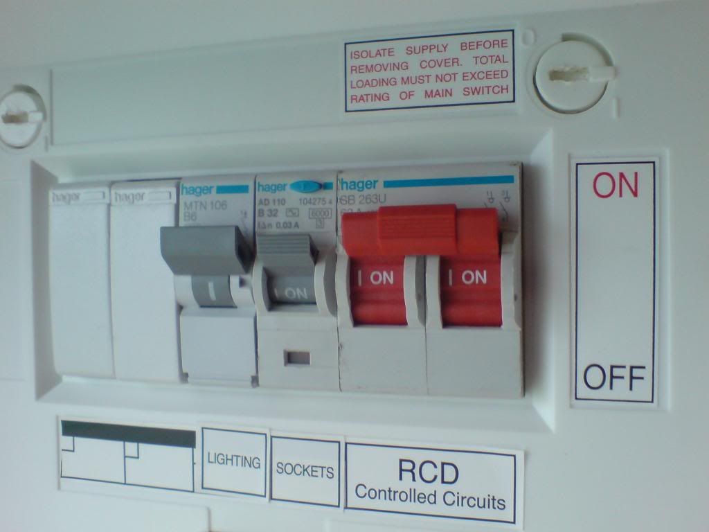

why split load? If theres only two circuits, fit a 4-way unit with a mainswitch and an RCBO for the circuit you need protecting.
I'll find you a picture of mine.
Cover on:
Cover off:
This is cheaper than a split load, because your only paying for an RCBO instead of both an MCB and RCD.
