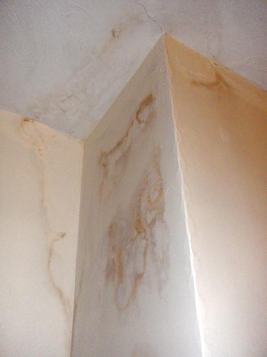

A homeowner in a wet, windy part of Scotland has a 1965-built house with a chimney that used to serve a coal fire, then a gas fire, and has been out of use since a gas leak was found. The stack was repaired, the bricks sealed with a waterproof coating, a new cowl fitted, and the flashings tidied up. Despite all that, damp patches have started showing on the upstairs chimney breast, a crack has opened in the plaster next to it, and the damp is now creeping onto the ceiling. It gets worse after wet, windy weather. The loft is dry, the felt is dry, the tiles look sound and the gutters are clear. They want to know where the water is coming from before spending any more money.

Nine times out of ten with a disused chimney showing damp near the top of the breast, you're dealing with one (or a combination) of three things: condensation inside the flue, trapped moisture in the brickwork, and rainwater getting in via the stack or flashings. In this case the story points strongly at the first two.
Here's the chain of events. The flue is cold because there's no fire warming it. Warm, moist air from the house still finds its way up the chimney (the fireplace isn't sealed at the bottom), hits the cold brickwork inside the stack, and condenses. That water then soaks into the porous brick from the inside. On top of that, when the stack was 'sealed' externally with a waterproof coating, any moisture already in the bricks, and any new moisture arriving from inside the flue, now has nowhere to go. Water always finds a way out somewhere, and it tends to show up on the warm side, which is your plaster. Add in years of coal-fire use and you've got hygroscopic salts in the brick and plaster that actively pull moisture out of the air, which is why damp patches can appear even in summer.
The wet-and-windy correlation is a red herring on its own. Driven rain will make any porous wall damper, but if the roof, flashings and cowl are genuinely sound, the main driver here is what's happening inside the flue, not outside it.
Simple checks first
Don't guess, prove it. Work through these before calling anyone back out:
Brown water staining and damp patches spreading across a white painted chimney breast corner and ceiling in an upstairs room
Typical damp staining on an upstairs chimney breast, spreading onto the ceiling after prolonged wet weather.
  • Look at where the damp is worst. If it's highest up the breast and on the ceiling near the stack, that points to the flue itself (condensation or rain down the pot). If it's low down or in a band, think bridged DPC or penetrating damp lower down.
  • Check the cowl. On a disused flue, the cowl should be a purpose-made vented cap that keeps rain out while allowing airflow. Have a look with binoculars from the ground. Is it intact, sitting square, and is there any staining running down the stack from it? A gas terminal (designed for active gas appliances) fitted to a disused flue can restrict ventilation and allow rain ingress, so check what type has been fitted.
  • Feel the chimney breast in the loft again after a spell of wet weather. Cold is normal. Actually damp to the touch is not. If it's dry in the loft but wet in the room below, the moisture is arriving inside the flue or through the breast itself, not through the roof.
  • Check the flashings properly. Lead should be dressed neatly, tucked into a chase and pointed, with no lifting edges. Bitumen slapped onto lead is a warning sign, it usually means someone was chasing a leak and didn't fix the cause. Bitumen also cracks and traps water underneath.
  • Look at the fireplace opening downstairs. Is there any airflow at all? Hold a bit of tissue near it. No movement means the flue isn't ventilating, which is exactly the condition condensation loves.
  • Salts test: if the damp patches feel slightly furry, fluffy or leave a white bloom when they dry, you've got hygroscopic salts pulling moisture from the air. That confirms historic contamination from the old coal fire.
  • Check inside the pot if you can get a look. A capped or restricted pot with no ventilation will guarantee condensation problems in a disused flue.

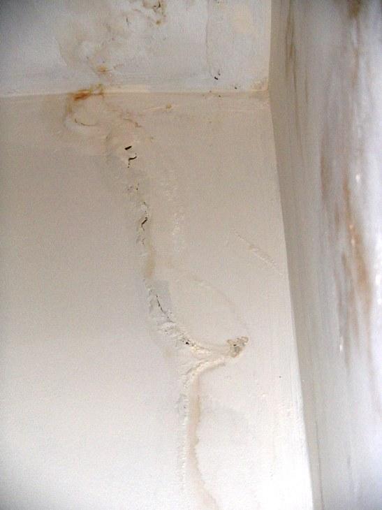

Once the flue is ventilating and the brick has had a chance to dry out (give it a full season, not a fortnight), deal with the damaged plaster. If the salts are heavy, the affected plaster will keep pulling moisture no matter how many times you paint over it. The honest fix is to hack off the contaminated plaster back to brick, let it dry, and re-plaster using a salt-resistant or renovating plaster system. Then a stain block and redecorate. Skipping the salt-resistant layer is the classic mistake, the stain comes back through emulsion within months.
Best: ventilate, reinstate a working appliance, and address the external coating
Close-up of cracked and bubbling plaster beside a chimney breast, with brown water stain marks running down the wall from the ceiling junction
Cracked, lifting plaster alongside the chimney breast, with water tracking visible from the ceiling down the wall.
If you're planning to reconnect the gas fire anyway, that's actually part of the cure. A working appliance warms the flue and drives moisture out rather than letting it sit and condense. Get that done by a Gas Safe engineer, no shortcuts there. At the same time, get a competent roofer or leadworker to review the flashings properly and strip off any bitumen bodges. Lead should be doing the work, not tar. Longer term, the waterproof coating on the stack is worth a conversation: sealing porous brick externally can trap moisture in the wall, and a breathable masonry treatment is usually kinder to old brickwork than a full waterproof paint.
