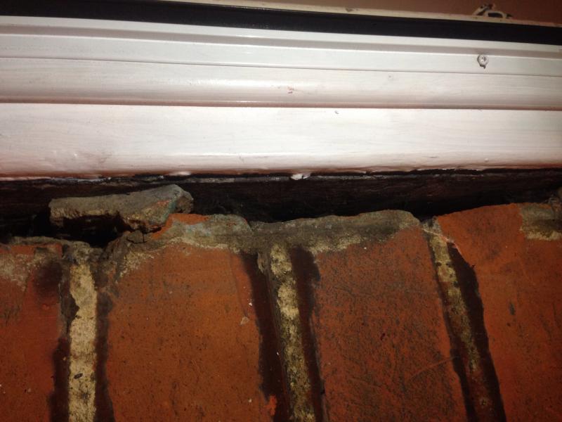

A homeowner has noticed a fairly wide gap – roughly half an inch – running down the side of their front door frame where it meets the brickwork. The original bedding material (looks like a bit of old lime or sand/cement pointing) has crumbled out over the years as the house has moved and the timber frame has expanded and contracted. The door itself feels solid and the wall doesn't shake when it's closed. They want to know how best to fill the void, whether expanding foam is the right call, and what the finishing material should be.

Better – foam backing with a mortar face
Close-up of a gap between a white uPVC door frame and the surrounding brickwork, showing crumbled mortar and exposed brick beneath the frame sill
A typical gap where old pointing has crumbled away between a door frame and the brickwork, leaving a visible void that needs sealing.
Same prep, same low-expansion foam – but only fill the gap to within about 15-20mm of the outside face. Once cured and trimmed back, point the outer face with a sand and cement mortar (a 4:1 mix with a bit of plasticiser is fine for most situations, or use a lime mortar on older solid-wall properties where cement is too hard and will damage soft bricks).
The foam behind takes up the movement and insulates; the mortar face gives you a traditional look that matches the rest of the pointing. Finish with a thin bead of low-modulus silicone right in the angle between the mortar and the timber frame – that's your movement joint and it stops the mortar cracking away again in a year or two.
