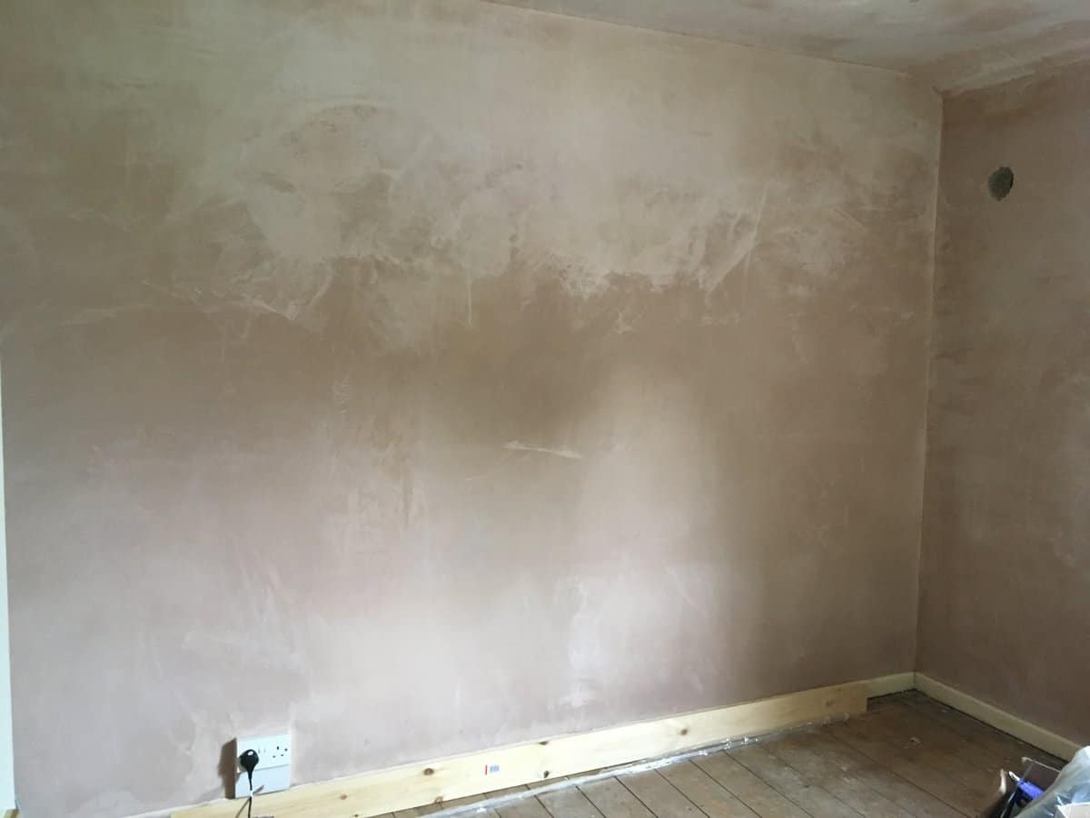

A homeowner has had a bedroom skimmed a couple of weeks ago and it's still not fully dried out. Parts of the wall went pale within a few days, but big patches remain dark and damp-looking. Windows have been open and an electric heater has been run in the room, but the dark areas aren't shifting. The house is known to have some damp issues elsewhere, though three other rooms plastered around the same time dried without drama. The question is simple: is this normal, or is something wrong?
This is a common one in UK houses. Before you start spending money or ripping anything off, do a couple of simple checks so you're fixing the cause, not the symptom. I'll run through what's likely happening, what you can safely check yourself, and what a proper fix looks like, plus the usual bodges that don't last.

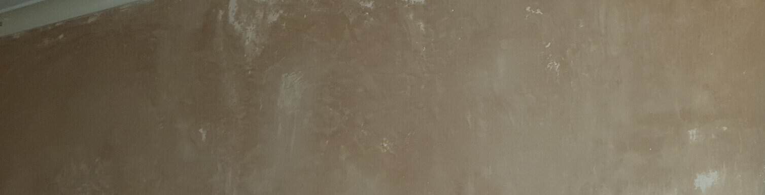

Fresh plaster doesn't dry in a week, whatever you were told on the day. Two to six weeks is normal, and it can be longer on a cold external wall, behind furniture, or where the plasterer laid it on a bit thicker to true up a wonky background. As it dries it goes through colour changes: dark chocolate, purple, red, pink, then a uniform pale pink when it's actually ready for paint. Patchy drying just means different parts of the wall are losing moisture at different rates. That's normal to a point.
The chain of events usually goes like this. The background (brick, block, old plaster) sucks moisture out of the fresh skim from behind, while the room air pulls it out from the front. If the background is inconsistent, say a patch of dense old render next to softer lime, or a cold external wall next to an internal one, you get uneven suction. Add in a damp problem in the property, a poorly sealed background, or over-trowelling that's closed the surface up too tight, and you end up with dark blotches that hang around for weeks. Forcing heat at it can actually make it worse, because the surface skins over while the middle stays wet.

Freshly skimmed bedroom wall with uneven drying, showing pale dried patches alongside darker damp-looking areas, with bare wooden floorboards and a plug socket visible at the base.
A recently skimmed wall still showing dark, damp patches weeks after plastering — a common sight in UK homes during the drying-out period.
  • Look at the pattern of the damp patches. If they're along the bottom of an external wall or in a corner, you may be looking at rising or penetrating damp bleeding through. If they're random blotches spread across the wall, it's more likely uneven suction or over-trowelling.
  • Feel the wall with the back of your hand. Cold and clammy on an external wall in winter is often just slow drying. Cold and actively wet, weeks in, points to a moisture source behind.
  • Check the room ventilation. Windows cracked open with the door open too gives you air movement. A sealed room with a heater blasting just raises humidity and slows things down.
  • Look outside at the same wall. Cracked render, a dodgy gutter, a leaking downpipe, missing pointing, or ground levels bridging the DPC will all push moisture through to the inside. Water gets in, then it shows up somewhere else.
  • Check for a working DPC. If the skim goes right down to the skirting on a solid wall with no damp-proof course, or the DPC is bridged by a raised path or flower bed outside, that patch will never dry.
  • Ask yourself what background it went on. Fresh bonding or browning underneath will hold water for a lot longer than a skim over sound old plaster. Two coats of skim on a deep patch will also take longer than a thin refresh.
  • If you've got access to one, borrow or buy a cheap pin-type damp meter. Readings dropping week on week means it's just drying. Readings stuck high after 6-8 weeks with good ventilation means there's a moisture source you need to find.
Three other rooms drying fine while this one hasn't is a useful clue. That points at something specific to this wall, whether external exposure, a leak, a bridged DPC, or a heavier application, rather than a bad batch of plaster.

Close-up of a freshly plastered wall surface showing patchy drying, with darker brown damp areas contrasting against lighter dried sections.
A close-up showing the uneven colour typical of plaster that has not fully dried, with wetter areas remaining noticeably darker.
