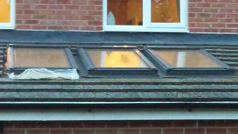

A homeowner has five roof windows fitted into a low-pitch kitchen roof, all installed about five years ago. Three of them have started letting water into the roof space, not through the glass itself but down near the bottom apron – the moulded flashing piece that sits below the window and laps over the roof covering. A general builder has been out, glued the apron edge down with some kind of solvent, and that has reduced the leak but not stopped it. The roof pitch is around 15 degrees, the covering looks flat (not a profiled tile), and the owner wants to know what is actually going on and how to put it right.

Do not guess, prove it. Before anyone goes lifting flashings, do these:
  • **Inside the roof space, find the wet timber.** Get up there during or just after rain with a torch. Look at the rafters and the underlay around and *above* the window. If the underlay is wet a foot or two up the slope, the water is coming in higher than the apron. If it is only wet right at the bottom of the window frame, the apron area is the entry point.
  • **Check the underlay laps and any drainage onto the felt.** On a proper low-pitch install there should be an underlay collar tucked under the felt above the window and lapped over the felt below, so any water that does get past the flashing runs harmlessly down onto the roof underlay. If you can see the felt cut tight to the frame with no collar, that is a red flag.
  • **Look at the apron from outside.** Is it sitting flat and tight to the covering, or has it lifted, curled, or sprung away at the edges? Press it gently. If it springs back up, it is not held down properly.
  • **Look at the side flashings and the head.** Water marks, debris trails, moss lines and staining will often show you the path water has been taking. A clean dry line down one side and a dirty wet line down the other tells you a lot.
  • **Check the tiles or slates immediately above the window.** Any slipped, cracked or short-cut pieces? Any sign someone has bedded them in mastic instead of fixing them properly?
  • **Hose test, top down.** On a dry day, with someone watching inside the roof space, run a hose gently onto the roof starting *below* the window and working upwards in stages: apron first, then sides, then head, then the tiles above. Give each area five minutes. The moment water appears inside, you have found the zone. This one test is worth more than any amount of guessing.

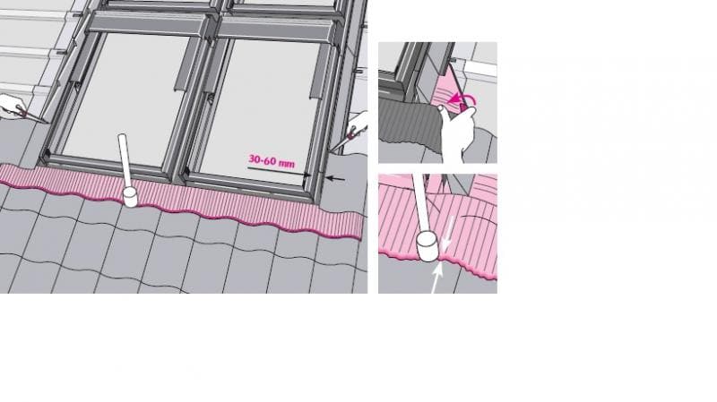

**Good (if the diagnosis is genuinely a lifted or poorly dressed apron and nothing else):** Lift the bottom row of tiles or slates, pull the apron free, clean everything up, and re-dress it properly onto the covering. On flat interlocking tiles it should sit tight with no gaps. If the original flashing is the moulded type with a flexible skirt, it needs to be worked down by hand and along the edges with a soft mallet, not glued. Replace any clips or fixings, re-lay the tiles, and make sure the side gutters lap *over* the apron, not under it. This is a half-day job for a competent roofer and will last if the rest of the install is sound.
**Better:** Lift the flashing kit completely, check the underlay collar underneath, and renew anything that has perished or was not fitted in the first place. Five years in, the secondary membrane is often the weak link on a borderline-pitch install. While it is open, check the head flashing and the lap onto the tiles above. Refit with the correct kit for the pitch and covering. A day's work per window for a roofer who knows these systems.
**Best:** If you have got three out of five windows leaking on a 15-degree roof, the install itself is the problem, not the individual windows. The proper answer is to strip back, fit the manufacturer's low-pitch flashing kits with the correct underlay collars, and make sure the tiles or slates around each window are cut and laid to the right clearances. It is not cheap, but on a shallow roof it is what gives you a dry kitchen for the next twenty years rather than the next twenty months.

  • **Solvent or mastic round the apron edge.** It blocks one exit route, the water backs up and finds another, and now you cannot lift the apron to see what is underneath without damaging it.
