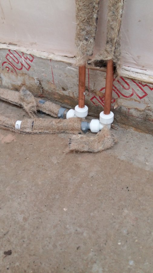

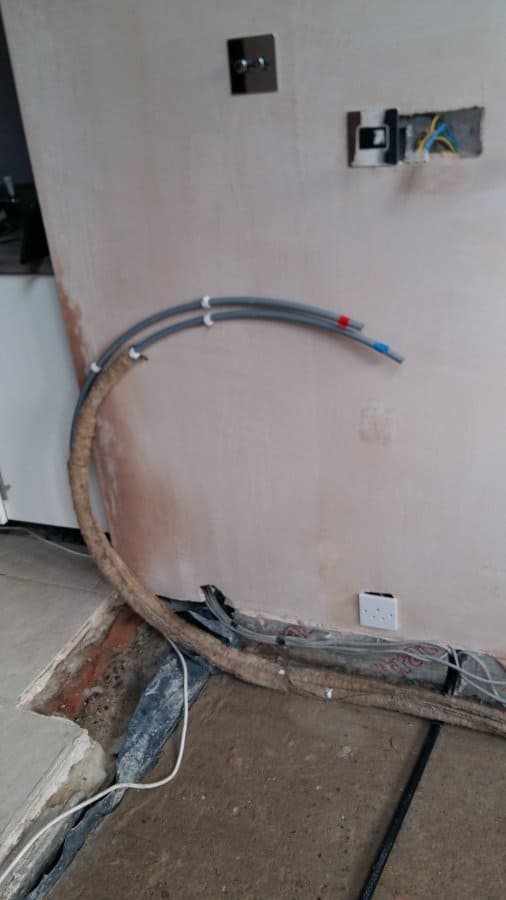

A homeowner is having a solid floor built up with a wet screed and the plumber has laid the hot and cold supplies in grey flexible plastic pipe with push-fit elbows that will end up buried in the screed. The pipe has a thin foam sleeve over it but the joints aren't fully covered. Copper radiator tails are also sitting exposed on the sub-base. The question is simple – is this acceptable, or is it storing up trouble the moment the screed goes down?

For the hot and cold water supplies, the Water Regulations are clear that buried services should be run in a duct or sleeve, not just wrapped in a bit of foam. The reason isn't only about protecting the pipe from the screed. It's so the pipe can be pulled through and replaced later without breaking up the floor. Foam lagging doesn't do that. It insulates and gives a token bit of separation, but once screed is poured around it, that pipe is there for good.
For the copper radiator tails, the issue is chemical. Wet cement is alkaline, and alkalis attack copper over time. Bury bare copper in screed and you're on a countdown. Could be years, could be sooner if the mix is aggressive or there's any movement. That's why copper in screed has to be properly isolated from the cement.
Then there's the joints. Push-fit elbows buried under a finished floor are the bit that makes most experienced hands wince. They may well last, but if one ever weeps you'll be lifting tiles or engineered board to find it. Sound practice is to bring pipe up out of the floor in a single continuous run and make your joints above the screed where you can see them and get to them.

Grey flexible plastic pipes with push-fit fittings arching along a freshly plastered wall, with exposed electrical sockets and a partially lifted solid floor showing the sub-base beneath
Grey plastic supply pipes loop along the wall before dropping to floor level, where they will be buried in the wet screed along with exposed push-fit joints.

  • Are there any joints below finished screed level? Push-fit elbows, couplers or tees buried in the pour are the main red flag. If you can see fittings sitting on the sub-base, they'll be entombed. Any buried joint is a future access problem.
  • Is the water pipe in a proper duct or oversleeve? Look for a larger diameter tube that the pipe passes through, open at both ends so the pipe could theoretically be drawn out. A thin foam wrap is not a duct. Foam only means not compliant with good practice for buried services.
  • How does the pipe rise out of the floor? Ideally it comes up in one continuous length using a proper forming bend or a factory bend, not an elbow. An elbow at floor level is a buried joint, so avoid.
  • Is the copper separated from the screed? Look for Denso tape wrapped tightly with good overlap, or a plastic sleeve or conduit over the copper. Bare copper touching where screed will contact is a corrosion risk.

Good. Copper rad tails wrapped properly in Denso (petrolatum) tape with a decent overlap all the way to where they exit the floor. Plastic hot and cold sleeved in foam is the bare minimum many jobs get away with, but it isn't what the regs ask for. Every joint brought above finished floor level. No elbows in the screed. Use a cold-forming bend or factory bend to turn the pipe upwards in one piece.
Better. Run the hot and cold in a proper pipe-in-pipe conduit, a larger plastic outer tube that the service pipe sits inside, open at both ends so it's drawable. Copper heating pipes sleeved in plastic conduit or heavily Denso'd, again with no buried joints. Pressure test and leave under pressure while the screed goes in.

Two copper radiator tails rising from a concrete sub-base connected to grey flexible plastic pipes via white push-fit elbow fittings, with fibrous pipe lagging lying loose around the joints
Copper radiator tails connected to plastic pipe via push-fit elbows sitting on the sub-base, with joints left exposed before the screed is poured.

  • Foam lagging as a substitute for a duct. It's insulation, not a sleeve you can draw a pipe through. Once the screed sets, that pipe isn't coming out.
  • Push-fit elbows buried in the pour. They might last twenty years. They might not. Either way, a leak means lifting the floor.
  • Bare copper straight into screed. Alkali attack is a known failure mode. Don't rely on "it'll be fine."
  • Wrapping Denso tape loosely or stopping short at a fitting. The screed finds every gap. Overlap by at least half the tape width and carry it well past any transition.
