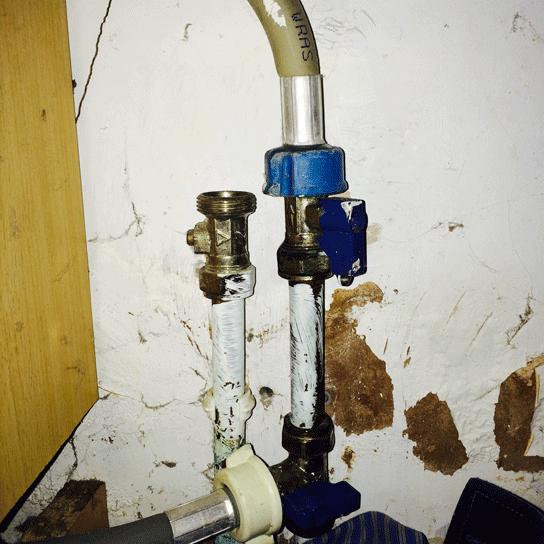

A homeowner spotted a persistent drip behind the washing machine, coming from the area where the appliance hose meets the isolator valve on the mains supply. The blue plastic lever on the valve keeps showing a bead of water even after wiping it dry, and the hose nut has already been tightened as far as it will go. The question is: what are these bits actually called, what's causing the drip, and is it something a reasonably careful homeowner can sort themselves?

With a drip appearing on the lever itself rather than the hose nut, nine times out of ten it's one of two things. Either the rubber washer inside the hose connector has perished or pinched and water is tracking down onto the valve body, or the valve's internal seal (around the ball or spindle the blue lever sits on) has failed. Cheap plastic-bodied isolators are famous for this. The spindle seal gives up, especially if the lever's been turned a few times.
Water is sneaky. It'll appear at the lowest point it can reach, not necessarily where it's actually coming from. Water gets in, then it shows up somewhere else. That's why wiping and watching is the first move.
Simple checks first (safe)
Before touching anything, pull the machine out gently, put a couple of old towels down, and have a torch handy.
  • Dry the whole area completely with kitchen roll: valve, hose nut, and pipe. Watch for 5-10 minutes. Where the first fresh bead appears tells you a lot. A drip forming on the hose nut points to a washer or hose fault. A drip forming from under the blue lever points to the valve body or spindle seal. A drip appearing behind the valve where it enters the wall points to the fitting behind the valve.
  • Gently wiggle the hose side to side (with the tap left as it is). If a droplet appears at the nut when you move it, the washer isn't seating properly.
  • Check the hose itself along its length. The metal ferrule where the grey hose is crimped onto its ends can split or weep. If the hose is damp halfway along, the hose is done.
  • Turn the blue lever fully closed and see if the drip stops within a few minutes. If it stops, the leak is from the valve spindle seal. If it carries on, water is getting past from the hose side or upstream of the valve.

Good: new washer
Close-up of a washing machine isolator valve with a blue quarter-turn lever handle, connected to a white braided hose and wrapped pipe fittings, mounted against a damp-stained wall.
A typical appliance isolation valve with blue lever handle, showing the hose connection point where a drip is occurring.
If the drip is definitely at the hose nut, undo the hose (turn the valve off first, have a towel ready), pop the old rubber washer out of the nut, and drop a new one in. Washing machine hose washers come in cheap packs and are the standard fix. Hand tighten, then a nip with pliers or a spanner. Not gorilla-tight, or you'll deform the washer and make it worse.
Better: new hose
If the hose ferrule is weeping, or the hose has been on there years, just replace the whole hose. New ones come with washers already fitted. Same routine: valve off, unscrew both ends, fit new, hand tight plus a small nip. Cheap insurance.
Best: new isolation valve
If the leak is coming from the valve body or under the lever, the valve itself needs replacing. These are inexpensive, a couple of quid from any decent merchant or DIY shed. The job goes like this:
