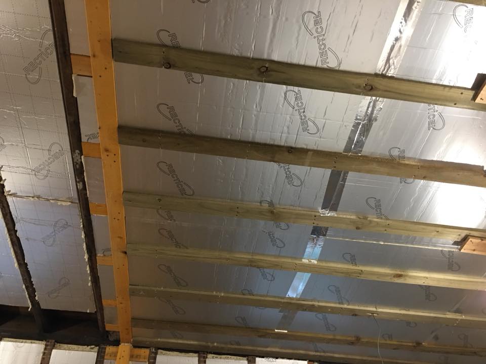

25mm across face of joists
  • Media owner iwilson16
25mm PIR board run across underside of roof joists, then 4x1 battens fixed thought shims to the joists. Plasterboard will be attached to the battens.
Coom ceiling and flat roof insulation in Victorian flat
