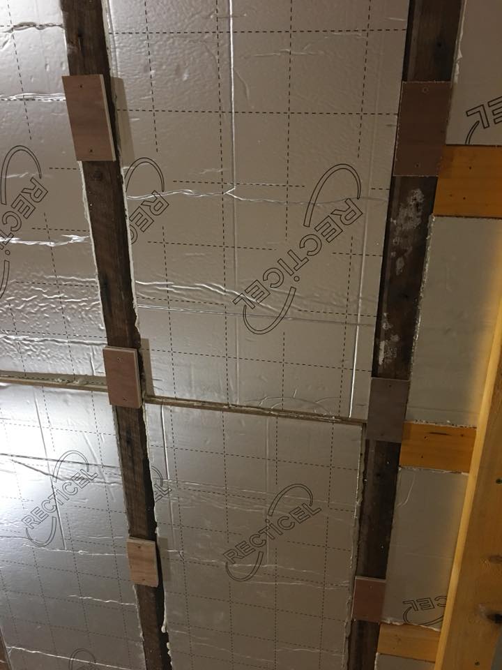

Shimming flat roof joists
  • Media owner iwilson16
There was up to 30mm difference in the lower side of the joists. I used a laser line-level to add plywood and glazing packer shims to even this out.
Coom ceiling and flat roof insulation in Victorian flat
