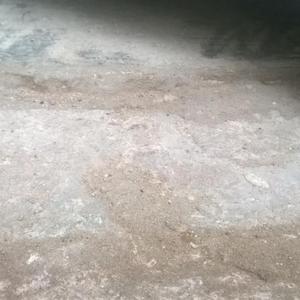

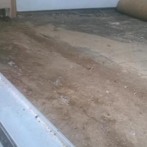

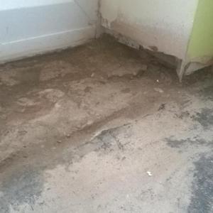

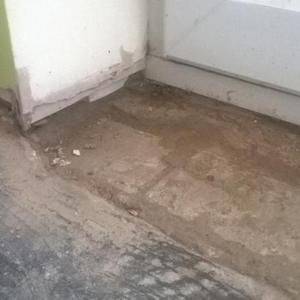

    Damp Proof Tape
    Its probably only set back about 20mm from the leading edge. Looking at every other door/window in the house it's pretty similar. 75mm would be most of the brick and looking at all the neighbours front doors they are around the 20-40mm mark I'd guess. A mate put the door in a while ago, its...
  8. A
    Damp Proof Tape
    The DPM was removed when the threshold was made as it was running along this course of bricks
  9. A
    Damp Proof Tape
    Hi, Some more pics.The bit in front of the carpet needs to be levelled a little to bring it up to the level of the existing screed so I can lay my laminate. It's probably less than 15mm at the tallest and as much as a few mm at the shallowest difference. Yeah probably a mortar bed would...
  10. A
    Damp Proof Tape
    Here's a pic Then I'm talking about using this stuff under the concrete or not as the case maybe. http://www.wickes.co.uk/Visqueen-Polythene-Damp-Proof-Course-100mm-x-30m/p/226579 To bring it up to level with current floor [/img]
  11. A
    Damp Proof Tape
    Hi, I've moved my front door so that know I have the bring course on view where I cut the whole out. My question is should I put a strip of DPM along the bring course before I make good the area with concrete? Or would I simply concrete straight on top? When I bricked up the old door I...
